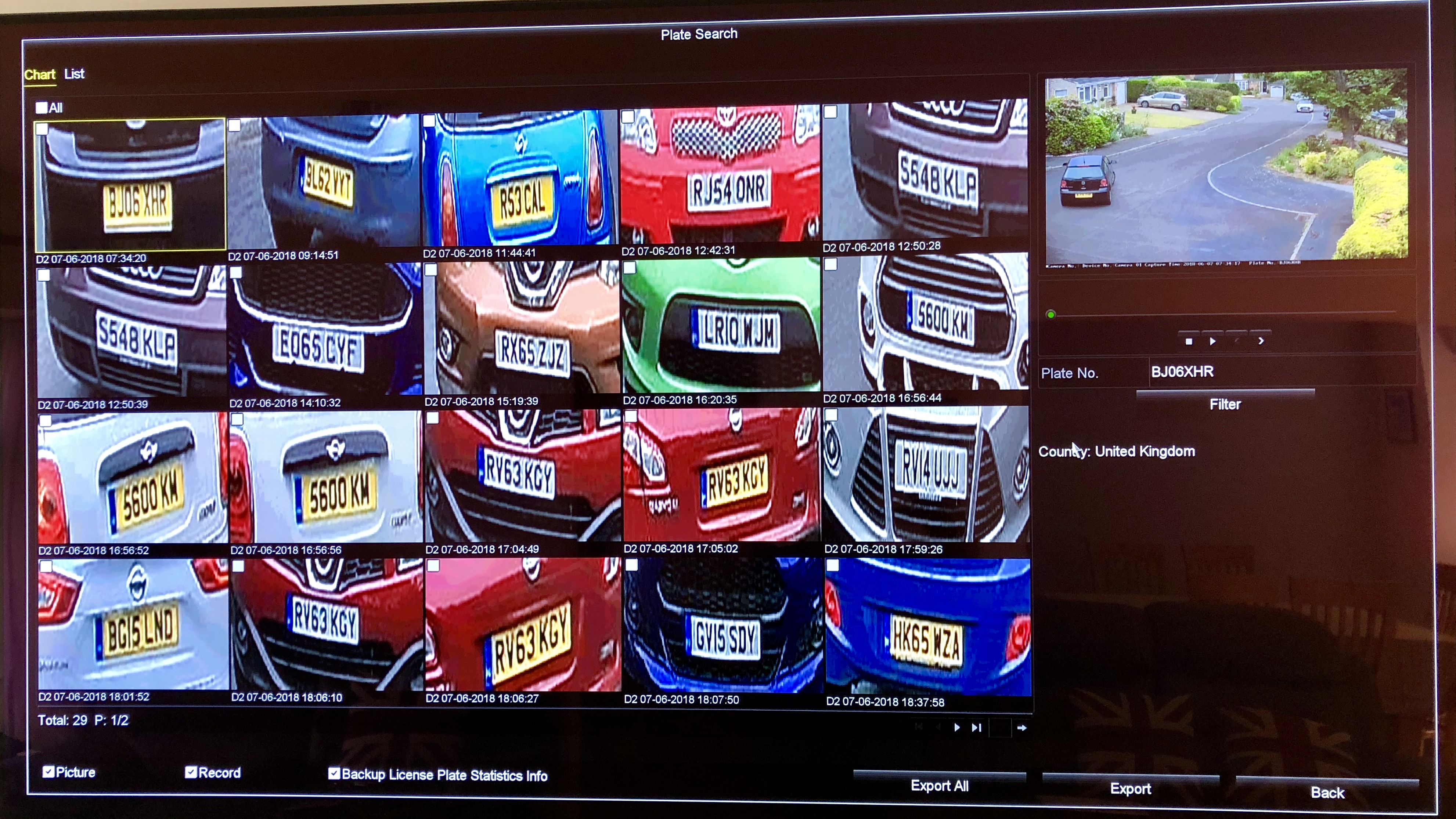

Have you read the ANPR setup guide on this forum? It’s very good.
My setup is not ideal as looking down onto traffic and lens set at its widest but I still get a hit on vehicles.
My exposure is 1/200 with gain set at 100% and WDR at 100. I’ve tinkered around with settings to make it a surveillance & ANPR camera.
Sorry if this doesn’t answer your question.
