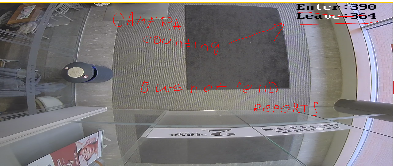

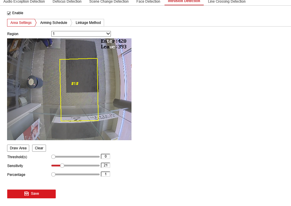

This camera was placed for peoples counting. How many leave and how many enter in the office. Every hour, camera have to send report, but some times camera stop sending reports,but keep counting, helps only - reebot. I checked logs, and founded standard alarms: "Intrusion Detection Stopped","Intrusion Detection Started","Line Crossing Detection Started","Line Crossing Detection Stopped".

This problem is about 2 months, and its work fine before. Camera is working everytime 24/7, and its not stopping count peoples, but stop sendings reports, that's is the main problem. We use IVMS 4200 ---> Video applications --> Reports , to see reports, how many peoples enter in office and how many leave the office. But sometimes camera stop sending the reports, but still counting(see screenshots).
The model Camera is Hikvision IDS-2CD6412FWD, to configure smart events we use WEB , to see reports we use IVMS 4200 and camera is connected to NWR,i hope I understood you right.

It sounds like a software issue. Are you running the latest firmware for the camera, NVR and the latest version of iVMS-4200?
Does setting up the smart events through iVMS-4200 make a difference?
