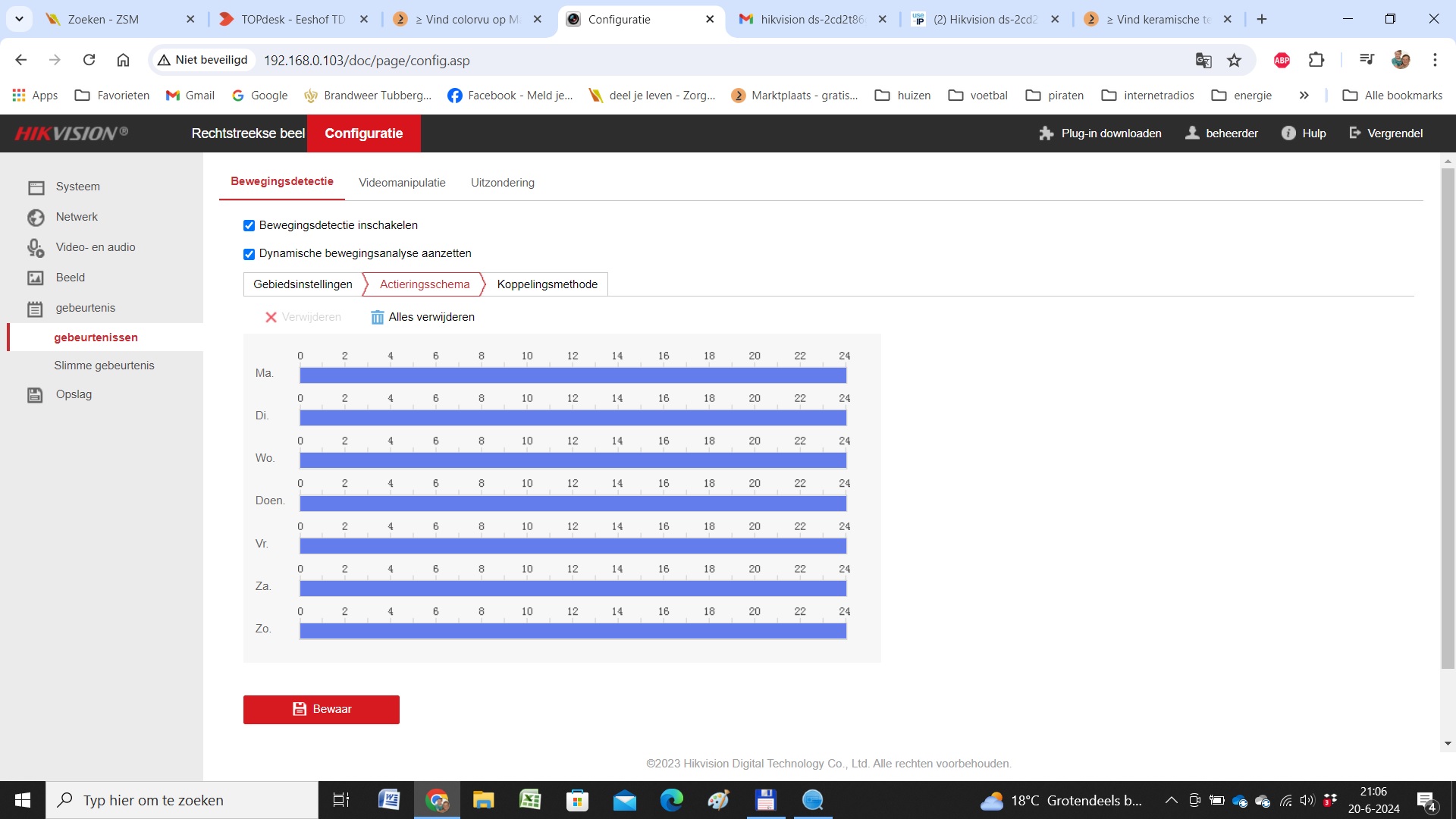

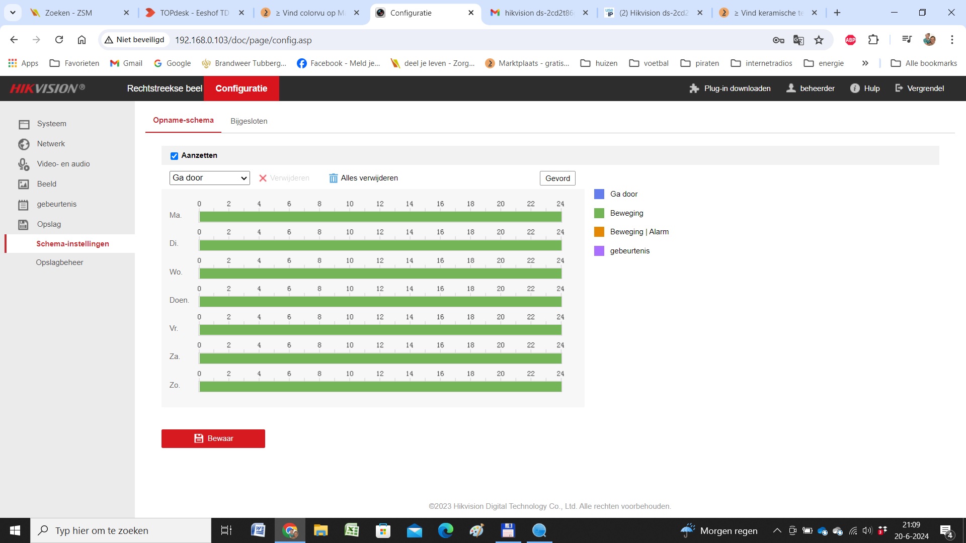

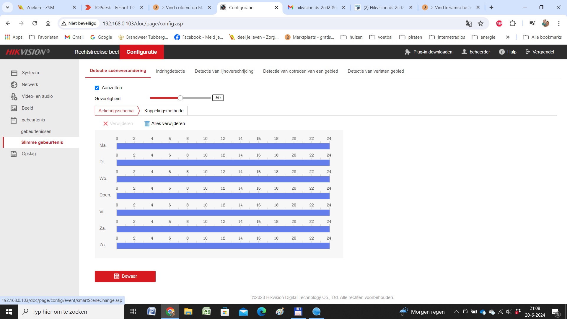

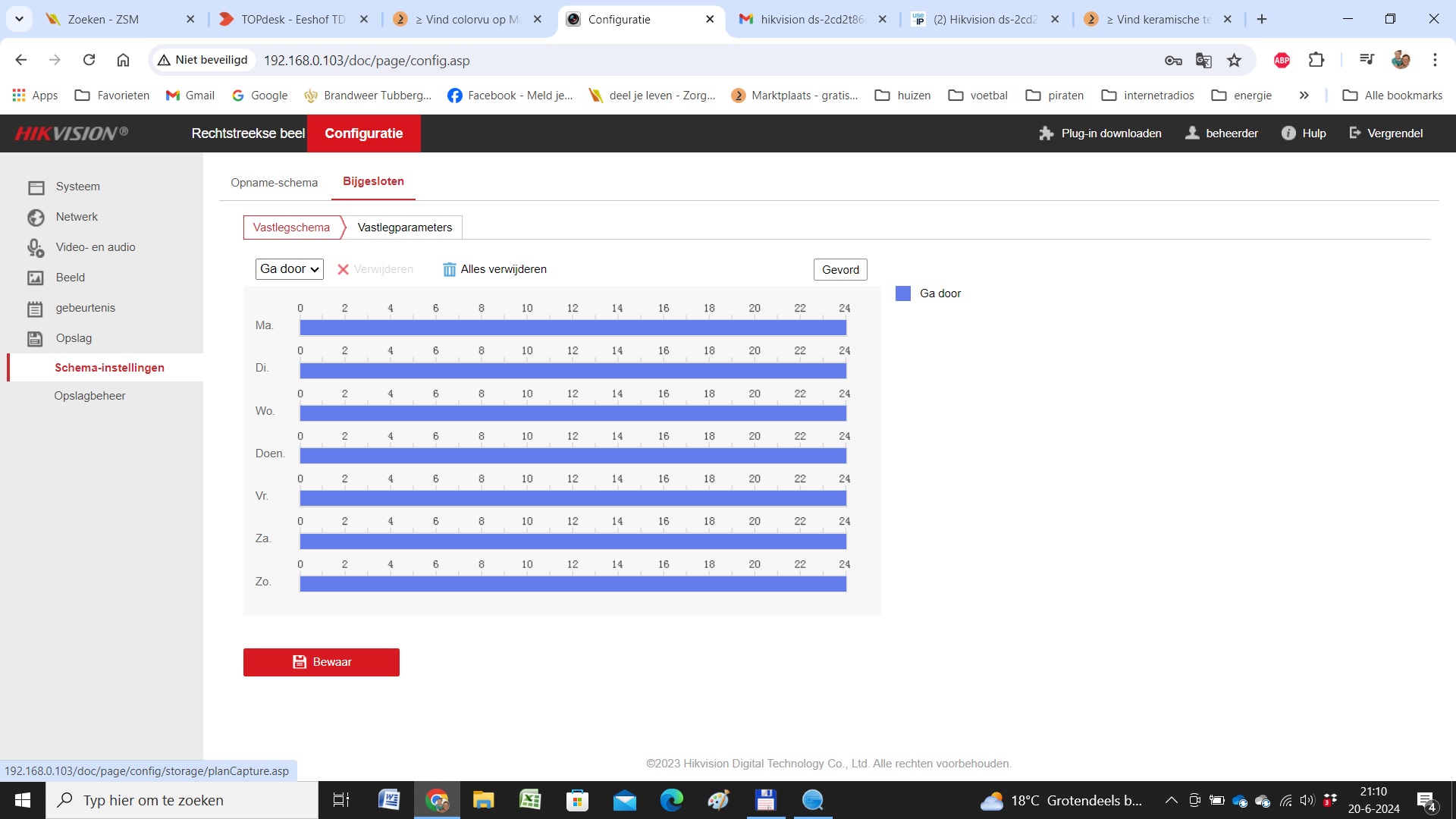

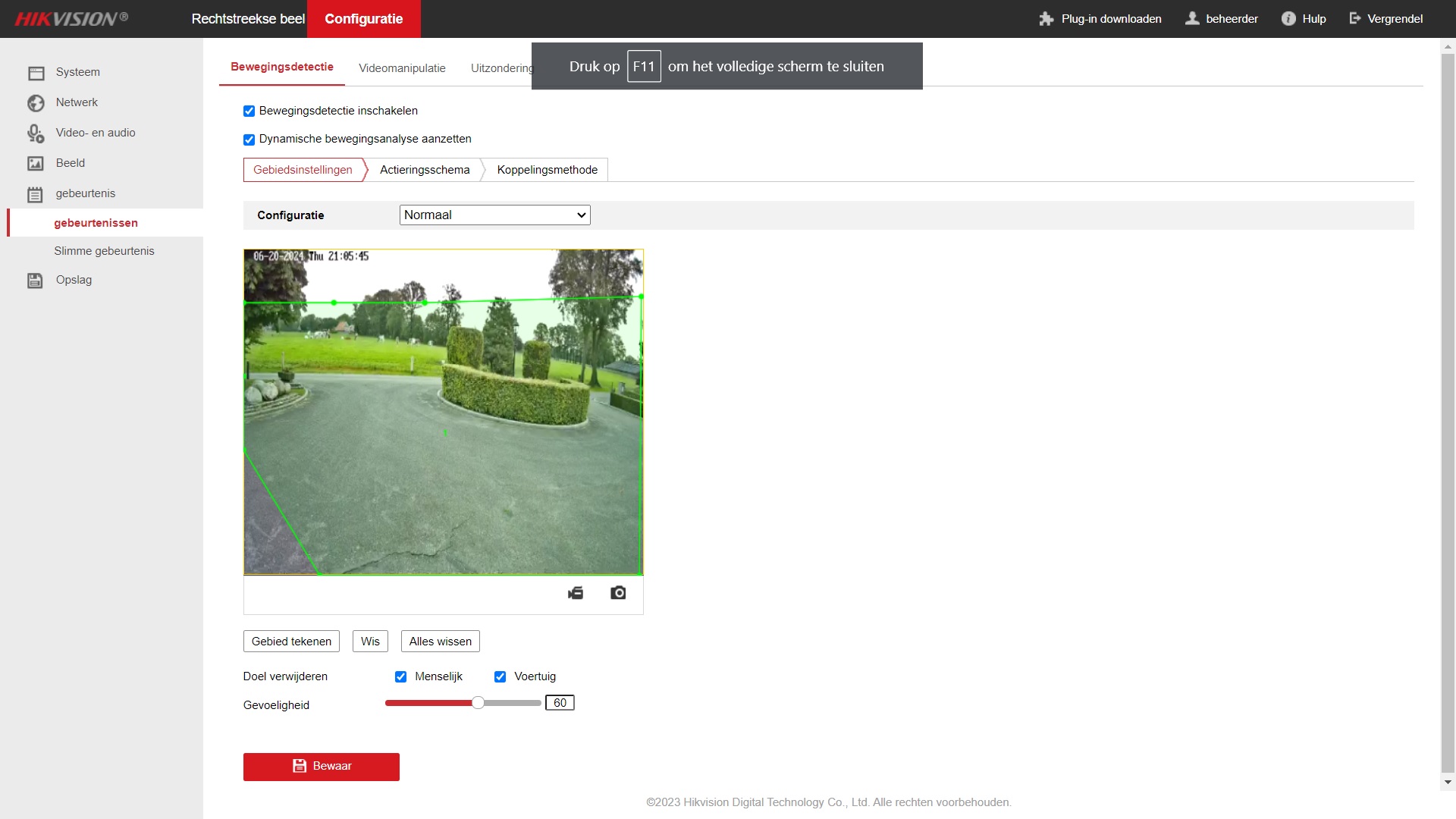

Hi @jos
Can you please share screenshots of your motion detection settings and your record schedule settings?
Heb een aantal bestanden
hoop dat je hier genoeg aan hebt?
"Have some files
Hope this is enough for you?"

Thanks @jos
Those event and storage schedule settings all look correct (although you can disable "Scene Change Detection" as this has nothing to do with Motion Detection).

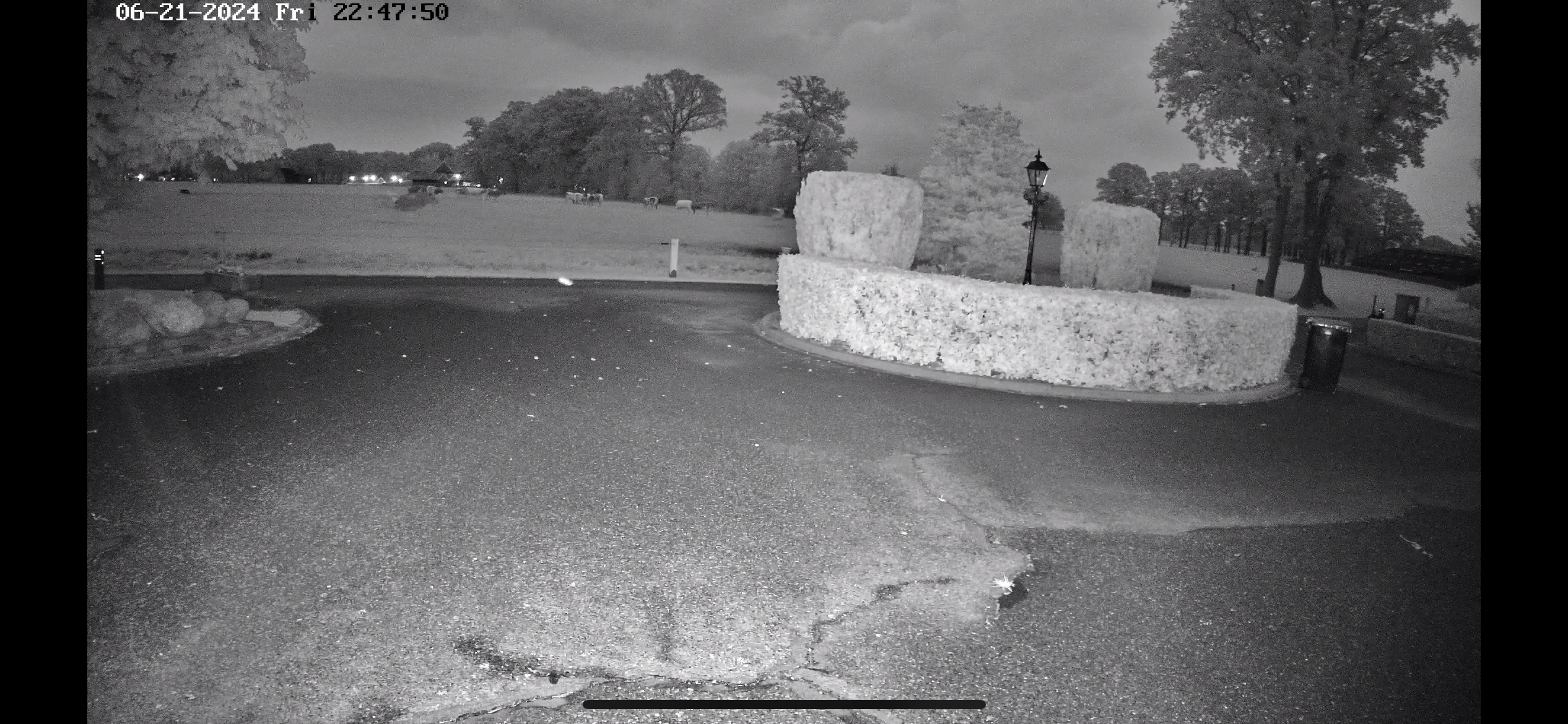

Can you share a screenshot of the nighttime image you are getting from the camera?
Hallo
ik zie s,nachts geen opnames
waar kan ik afspeeltijdlijn vinden???
foto wat is sávonds zie toegevoegd

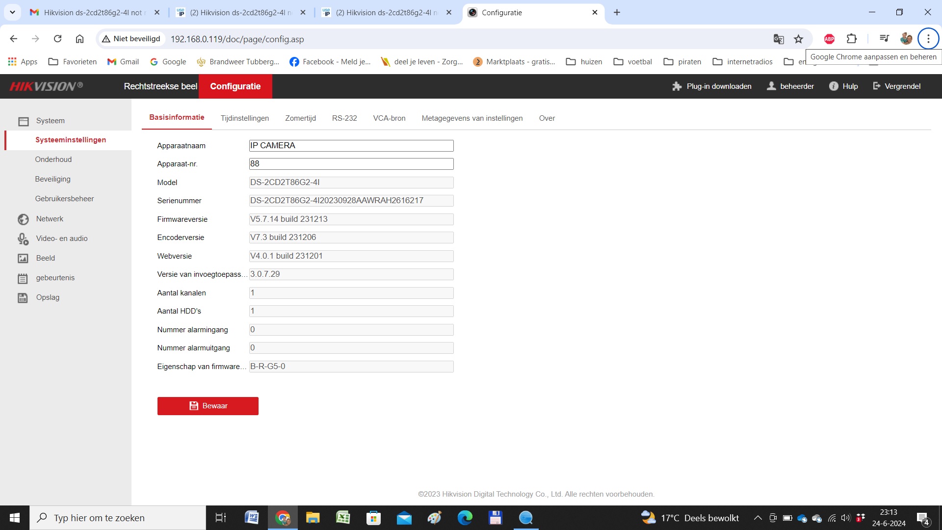

That is very strange, what firmware version is your camera currently using? (you can find this under Configuration > System > Basic Information)
Hierbij firmware
Thanks @jos
Try updating to the latest firmware - V5.7.17_240606 - and see if there is any change to recording at night after the update.

Can you disable infrared from Display settings - Day/Night switch - Supplement light Mode to OFF ?
Then check again.
