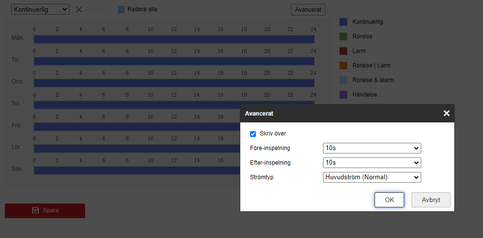

Everything is up and running, but I cant find any settings to increase the recording length. Does anyone know how to change this?

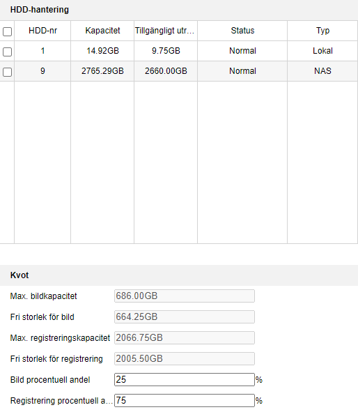

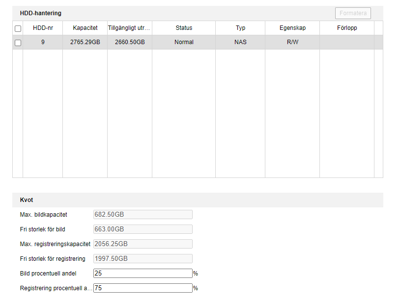

I have removed the MicroSD and just using the NetHDD. But I still only get 24h recording. Even then the NetHHD have lots of free space.
Camera only allocates 104,79GB then starts to overwrite old data.
Any one who has an idea how to proceed?
