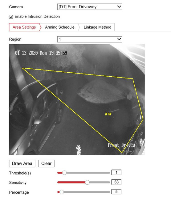

Ok at a bit of a loss here, this has been working perfect for a while, now it isn't.
Basic checks
1) Email account? Sent test email to all 3 users in group. Works ok.
2) Check intrusion detection
Area Settings
Area 1 is Yellow
Settings
58
5
Arming Schedule all Blue
Linkage method
Send Email
Trigger Channel D1
I have also checked in Event logs nothing showing here when i jump around like a loonie in the zone of camera D1, any ideas here? Im loathed to do a full factory reset but i don't know what else. Help appreciated!

Enabling Rules just lets you see/verify that detection is working.
You should see a box around/highlighting detected events.
I do, well when watching the postman walk up the drive both blue boundaries turned red on ivms4200 via my PC as the postman walked through them which were 2 Intrusion detection zones on camera1 (D1)
However i then flicked to logs and see nothing registered there Normally do.
Probably a configuration problem with events/actions than.
Perhaps upload screenshots of you configuration and we'll take a look.
