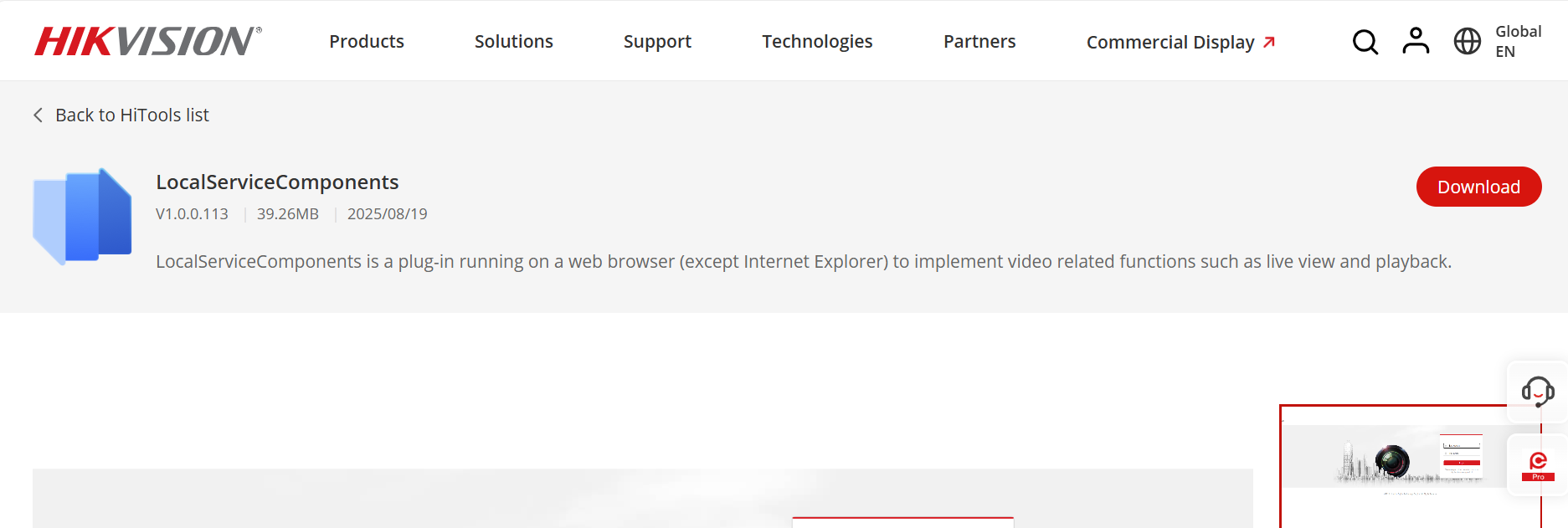

And here is the link to Hikvision discussing the issue with Chrome/Edge.
Chrome / Edge version V139 update causes a white screen in the web video window
Thanks, but I cant get the the fix downloaded from the Hikvision link you gave.

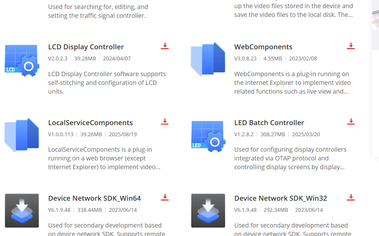

Ughhh... I see what you mean... none of the download buttons seem to be working... I tried them on the Global EN site and the USA EN site... nothing downloads? All of these download buttons are not working:
I didn't save any of these files I had downloaded... I wonder if anyone else did?
Check your virus scanner is not set to block data collection on the website. Had same issue, could get to above screen but it was only when I allowed data collection did the download links work.

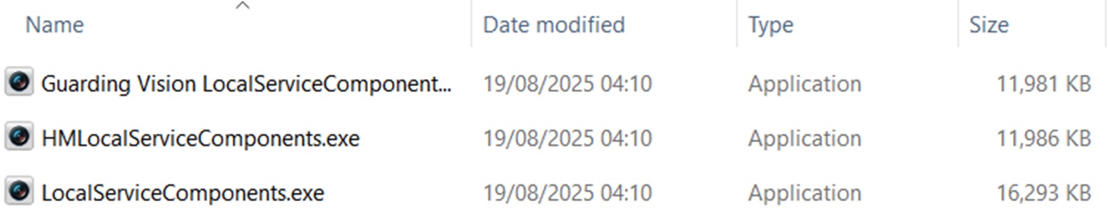

I managed to download loclaservicecomponents.zip OK using a VPN and unzipped it. What came out was 3 separate exe files as pet attached image. Sorry to be a pain but may I ask where I go from here? Do I execute them all?
If you have a previous version of LocalServiceComponents installed, uninstall it. Then install LocalServiceComponents.exe
I am not sure what the other 2 are. Saw them in the zip also but they never used to be included.
