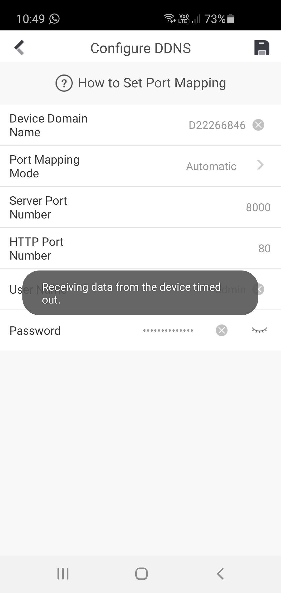

Hi, I have done the above but I still can't get remote access to work. I've added a pic of the message I get when I try to set remote access via hik connect app.
I also never receive notifications despite the fact they are turned on
