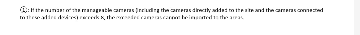

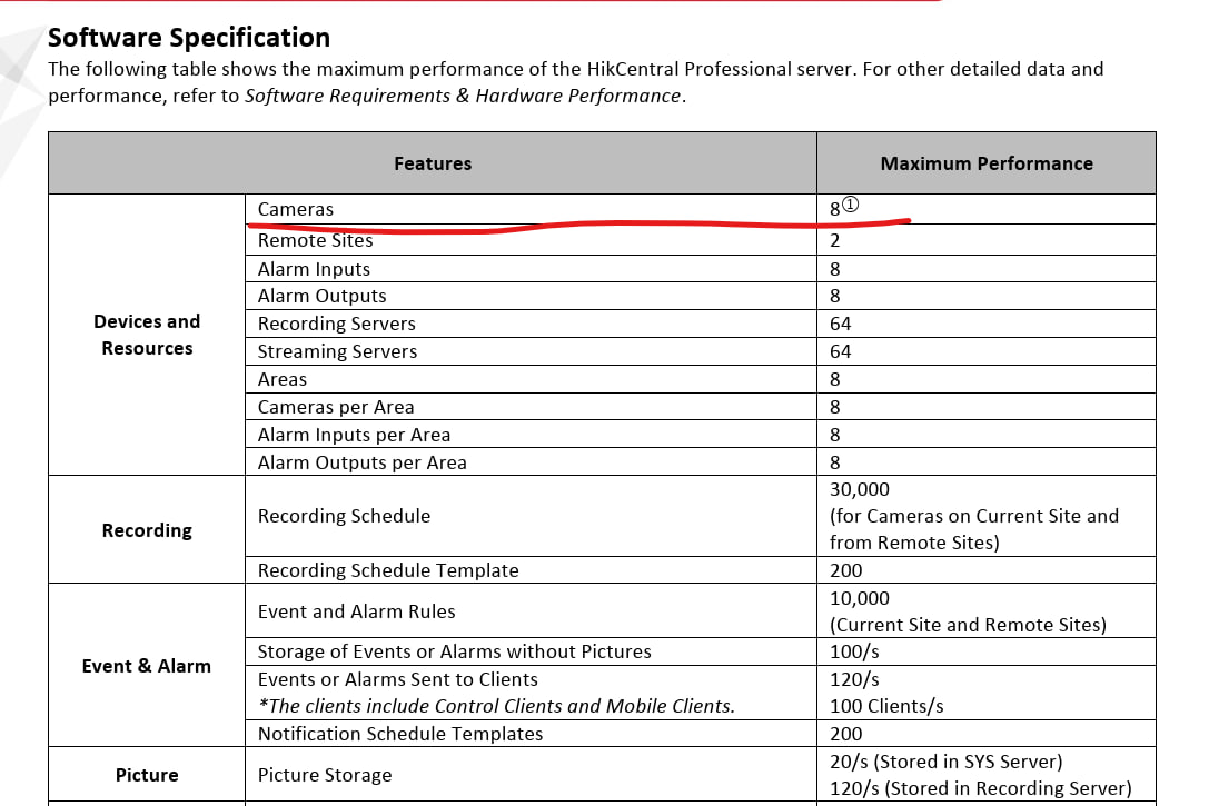

Dear colleagues, hi! Need help and suggestions regarding HikVision RSM module - remote site management. Anyone having experience with this?
Currently, one of our customers has 2 separate sites with HikCentral, one composed of multiple NVRs with HikCentral on top (~350 cams) and 2nd one with multiple pStor servers and HikCentral on top (~650 cams). Such architecture was predefined in order of construction priority.
Both sites has LAN connection between each other at the moment.
Currently, they want to combine these sites, so they can see all cameras on monitoring workstations in SOC (security operations center), including using SmartWAll module.
Can we solve this request with RSM 2 site license?
So cameras from both sites can be monitored in central SOC (350+650), of course taking into account layouts configurations and restrictions as well as decoding capabilities of workstations’ hardware.
For example, 64 cameras from 1st site and 64 cameras from 2nd site etc. e.g no restriction on the number of monitored cameras from local (RSM activated)/remote site.
Thanks so much beforehand for your help and suggestions.
