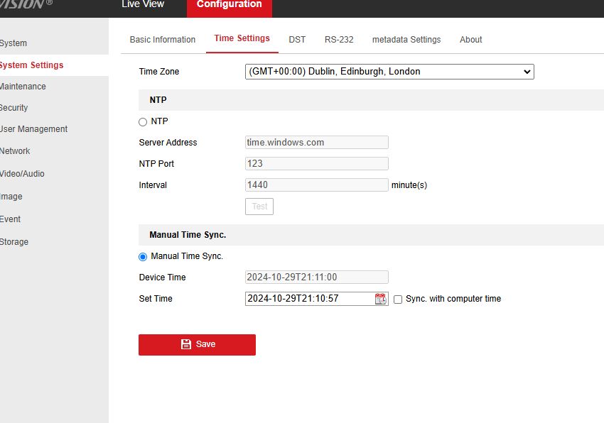

This is the view on each camera. If you select NTP, as you said, it says it can't connect.
There’s no need to set anything whatsoever on the camera when they are connected to the recorder. Nothing on the network, nothing in the time settings. Mine are set as they come out of the box with no NTP and a time zone of Beijing, yet the time is perfectly in sync with the NVR.
