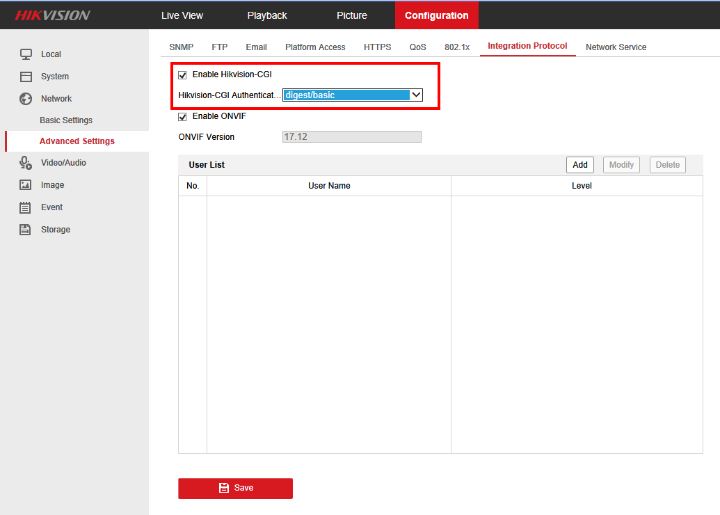

Try logging-in to your camera's Configuration area and:
1. Enabling Hikvision-CGI
2. Selecting 'digest/basic'
3. Don't forget to Save

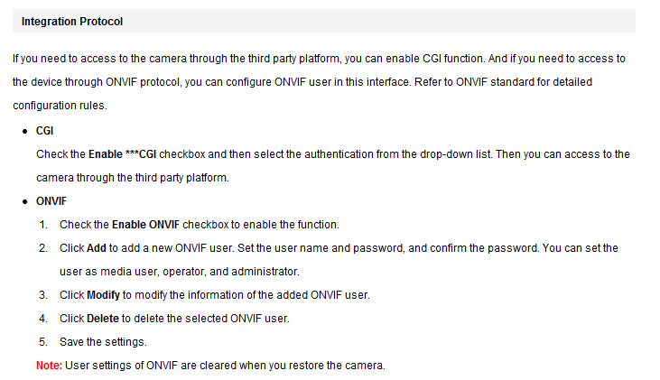

An explanation from the camera's contextual Help info:

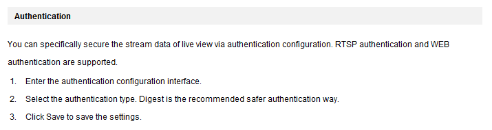

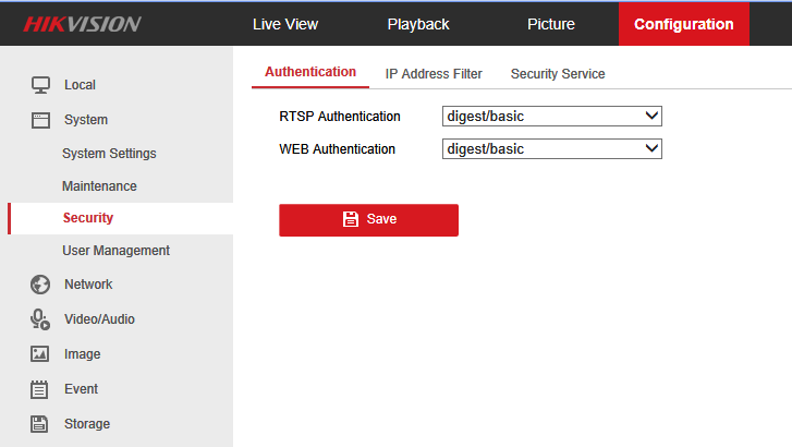

You can also try setting the Authentication settings as per the below:
Basically 'Digest' is a more complex method of authentication that Hikvision introduced with/for their Hik-Connect service.
The lesser 'digest/basic' setting may be helpful for other interfaces.

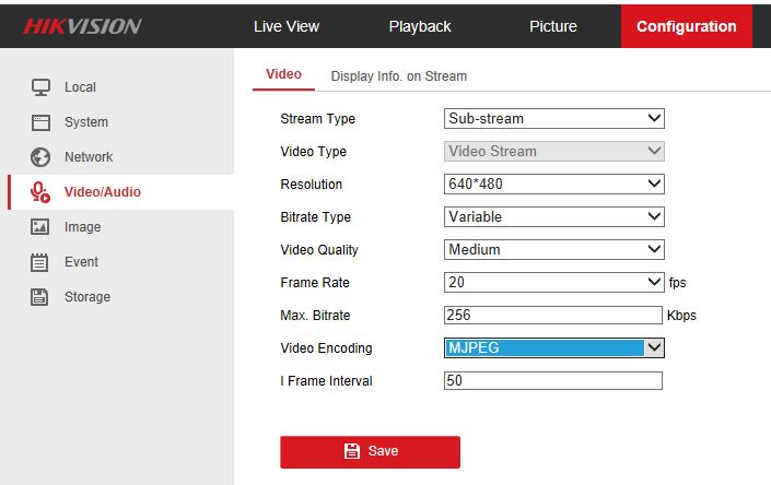

Try changing the sub-stream CODEC to MJPEG.
You should be able to set the resolution of that MJPEG as you prefer.
Sadly, setting the sub stream to MJPEG makes my cameras lose connection to my 2nd gen video intercom [DS-KD8003-IME1]. It shows a black screen with the message: "Live view failed - encoding type not supported". It obviously uses the sub stream to display the video on the systems little indoor stations.
Hikvision support just confirmed to me: "Unfortunately this device does not support MJPEG stream, it only supports H.264 and we do not have a solution for it."
