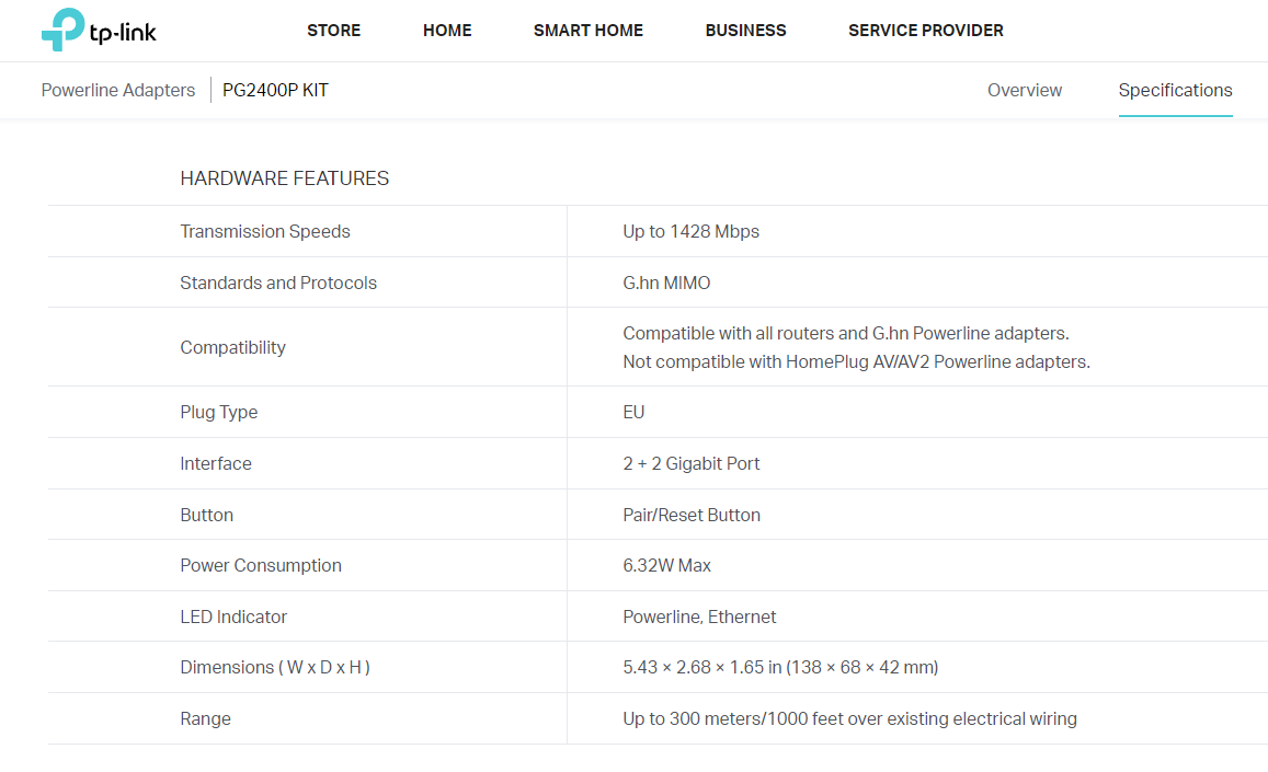

They suggest a range of up to 300m for their newer models:
Yes, definitely going to try this. It will take a while; my wife says we're going on holiday. Will let you know how I make out. I daresay I will have a few more questions before I am finished.. C
