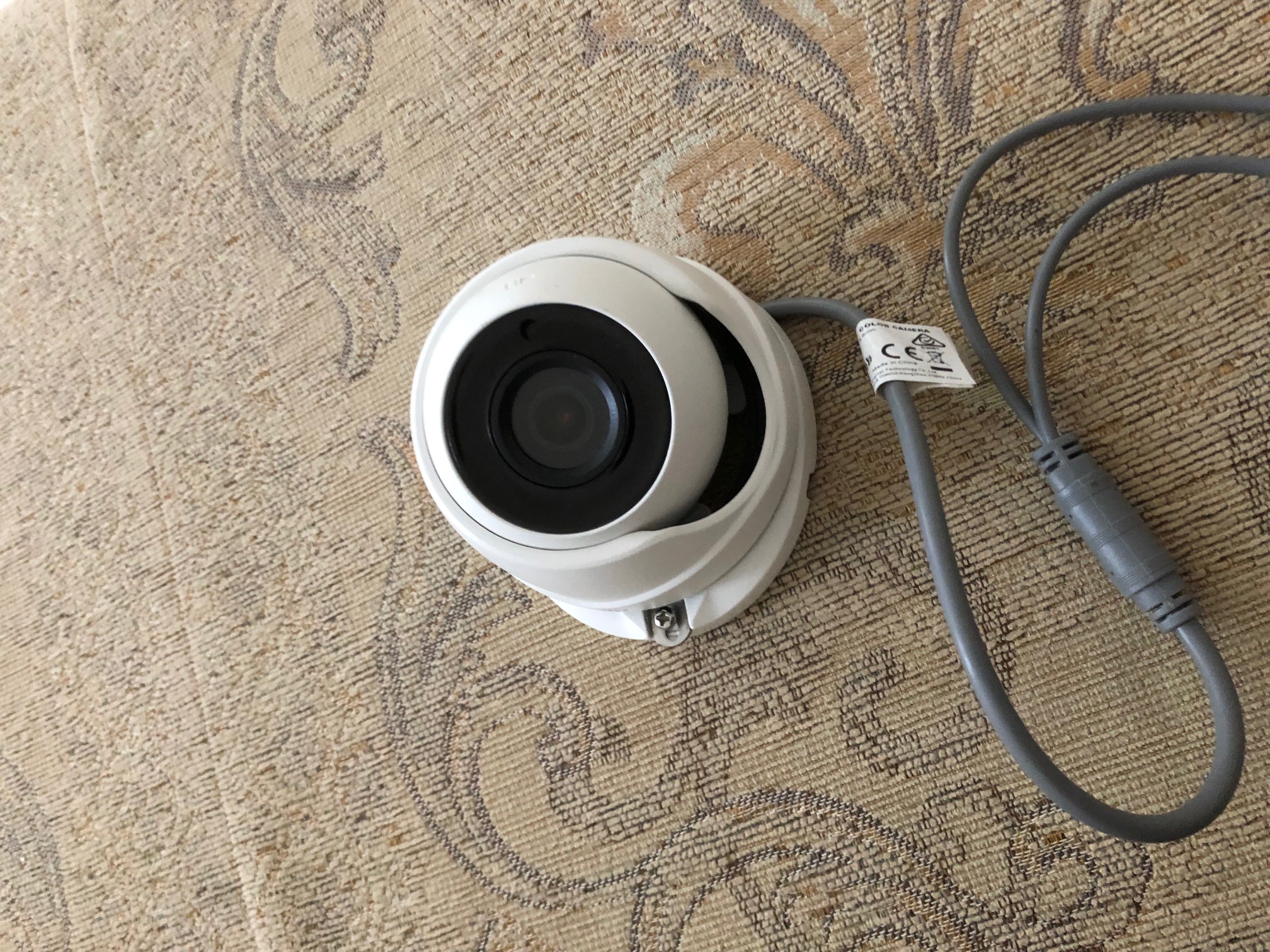

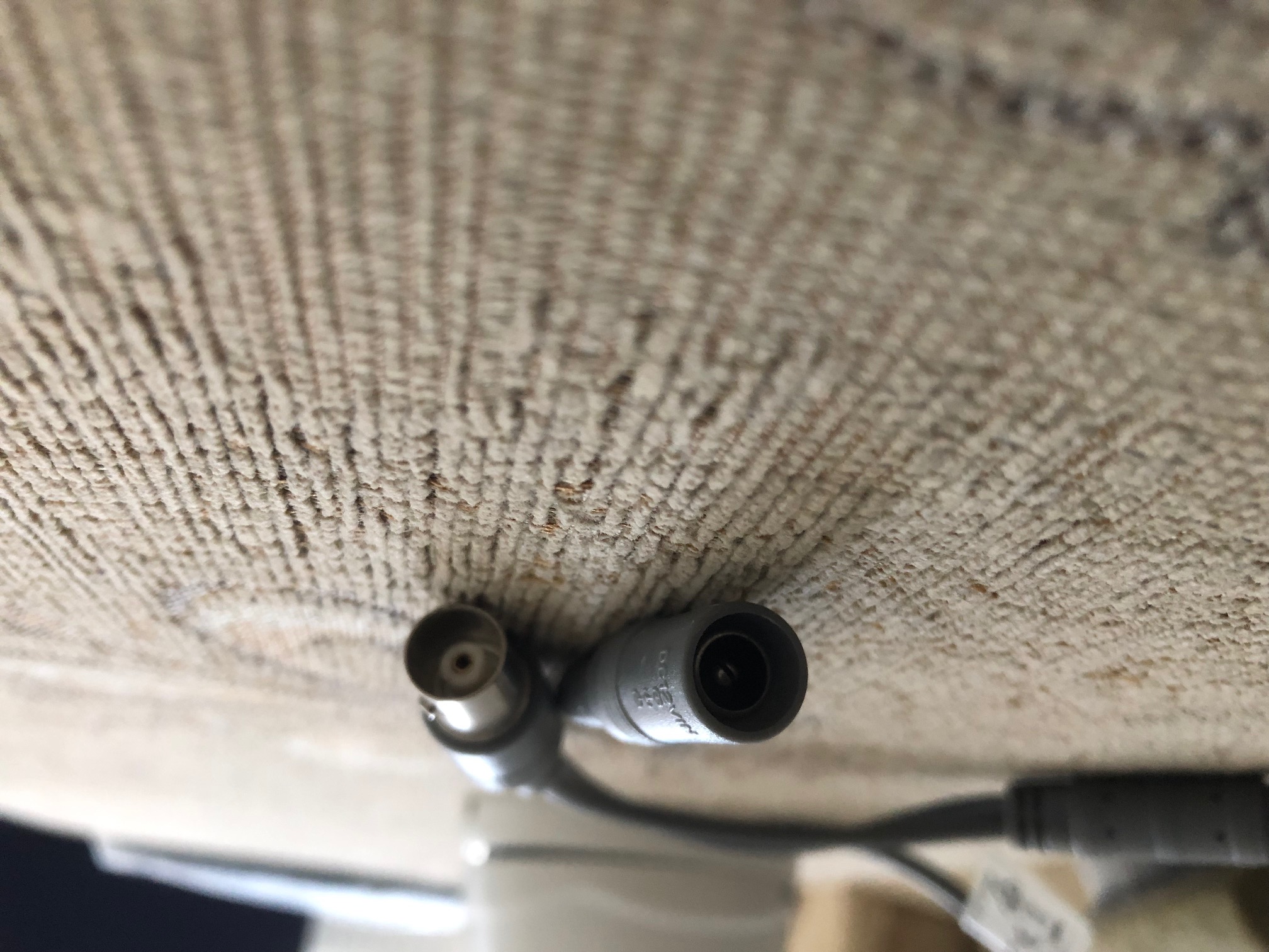

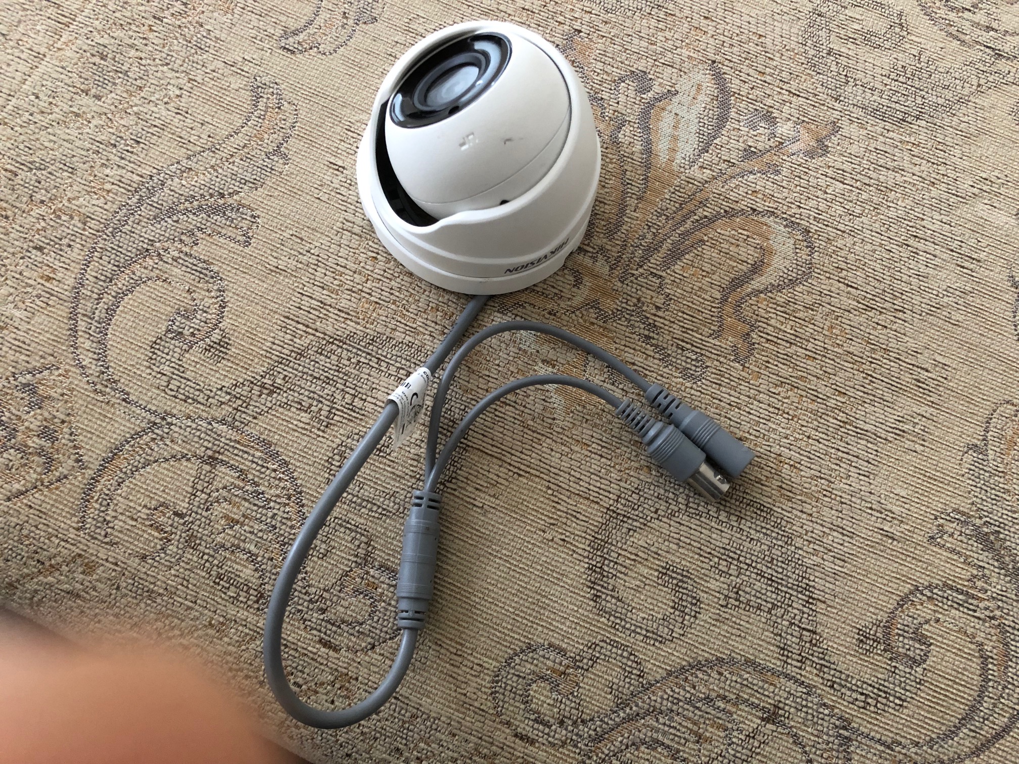

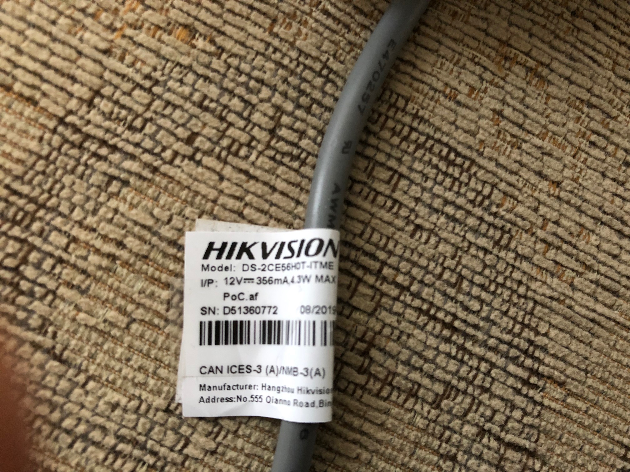

Hi Guys,
I have the NVR DS-7608NI-K2-8P and i have 2 spare ports and i have these Hikvision Analogue camera and i want to use them, so i can use all the ports, so 8 cameras, at the moment i am using 6 cameras.
What is best way of doing it, as my IP camera were just RJ45 plug and play, but i am not sure about this or i can use the below link CAT 5 to BNC Passive Video Balun Video and Power Converters - 2-Piece RG59 / RJ45 Cat5e.
Do i need to use an encoder and how do you install the Encoder and can this be fitted inside the junction box of the rear of the camera to hide the encoder and would it be powered by the cat5e cable or i need to run a cable for 12Volt.
Many
thanks for your replies and advice.

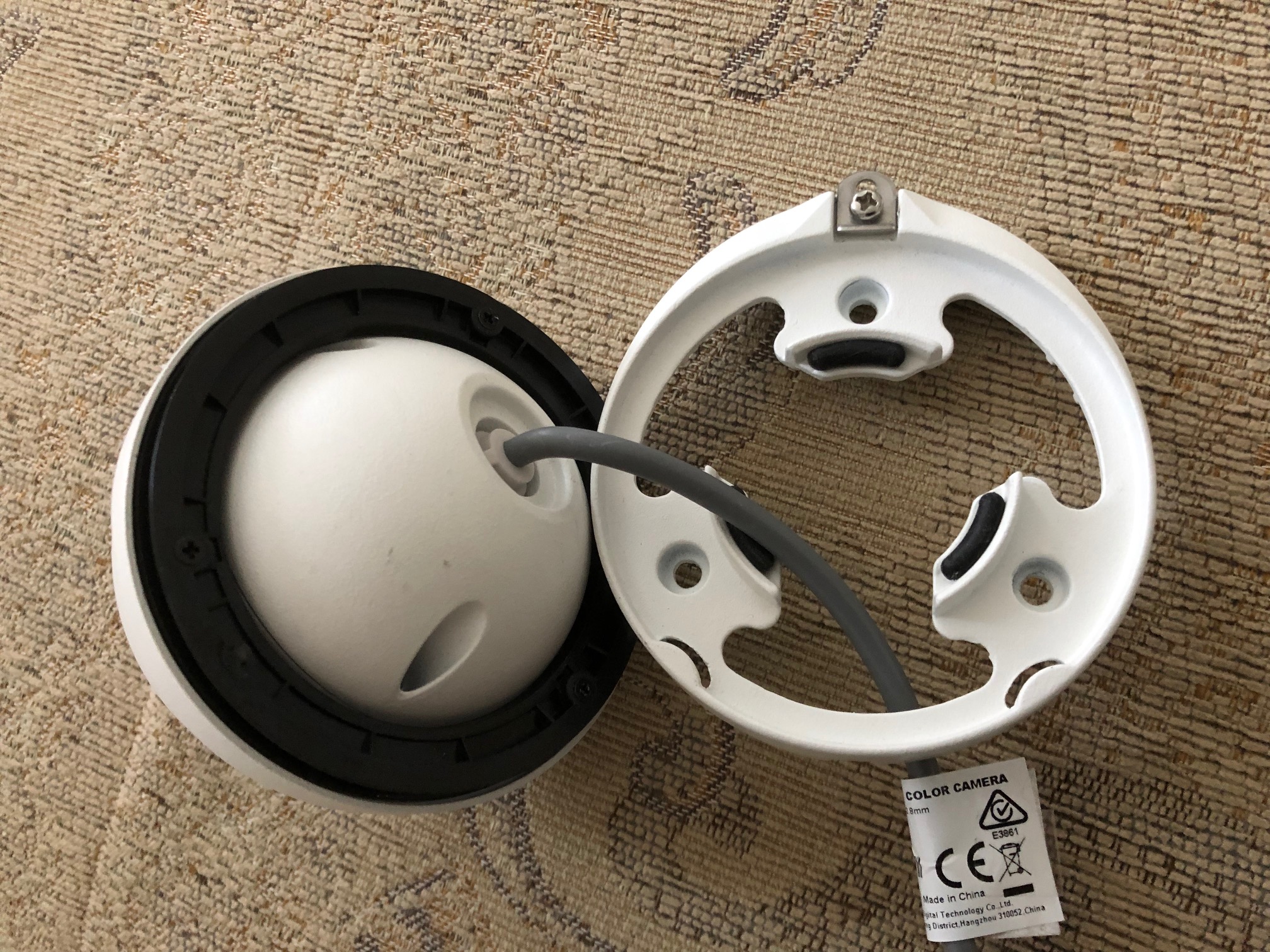

Do you know Hikvision Junction box code i need to buy for these cameras DS-2CE56HOT-ITME, is it Hikvision DS-1280ZJ-XS ?
