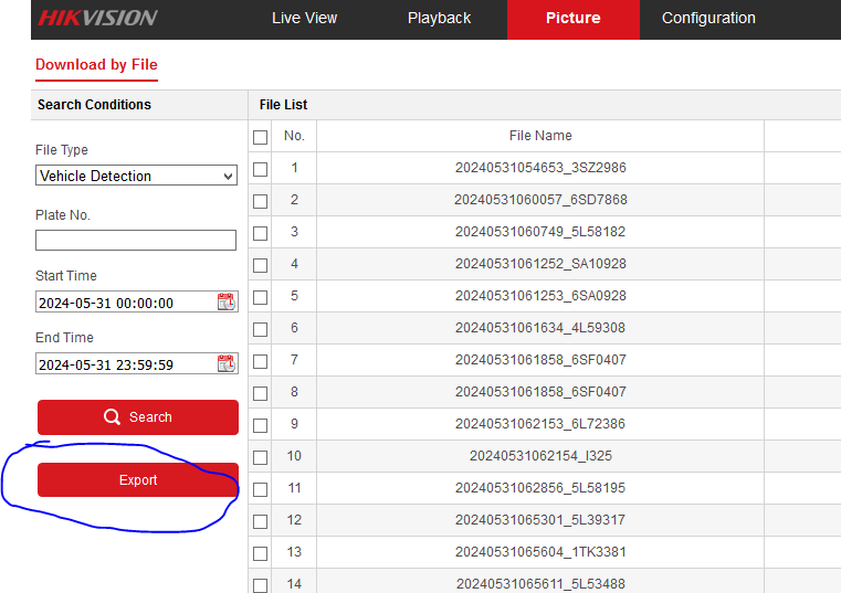

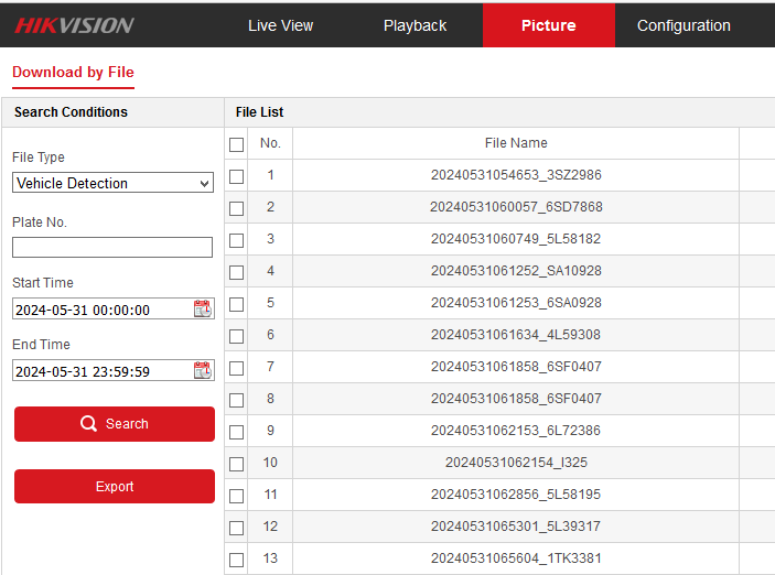

I need to download metadata for ANPR function of a camera using ISAPI or some programmatic way.
Images can be downloaded using this guide: https://www.hikvisioneurope.com/eu/portal/portal/Technology Partner Program/03-How to/How to search and download the video file from NVR via ISAPI.pdf

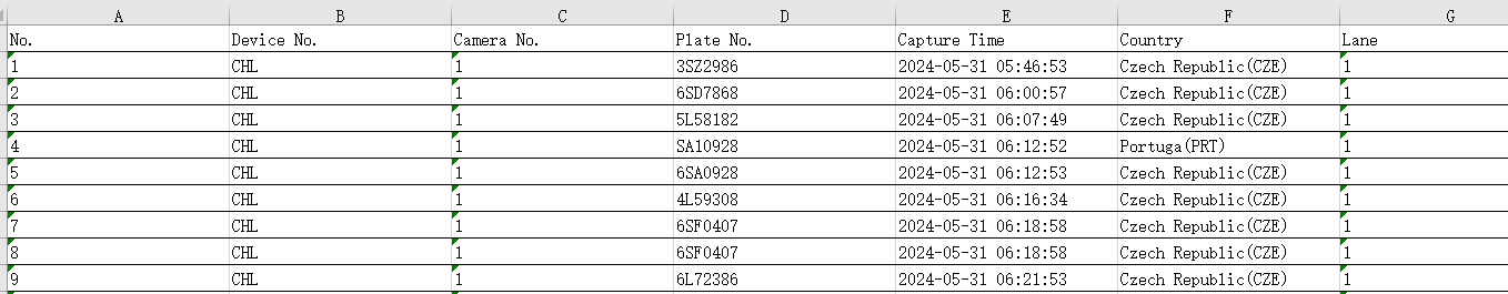

But how to download content of this XLS file using a non-interactive script?
