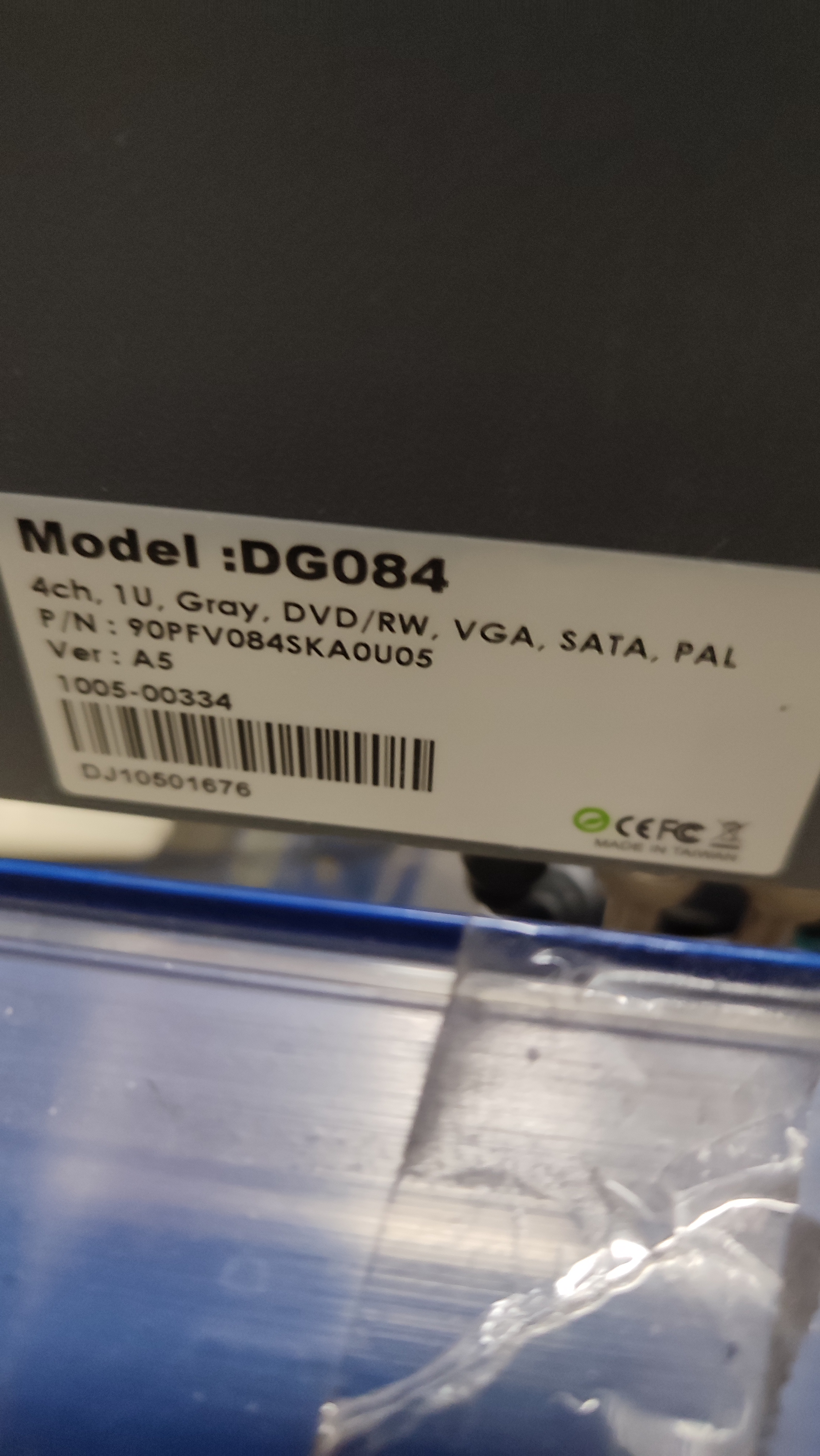

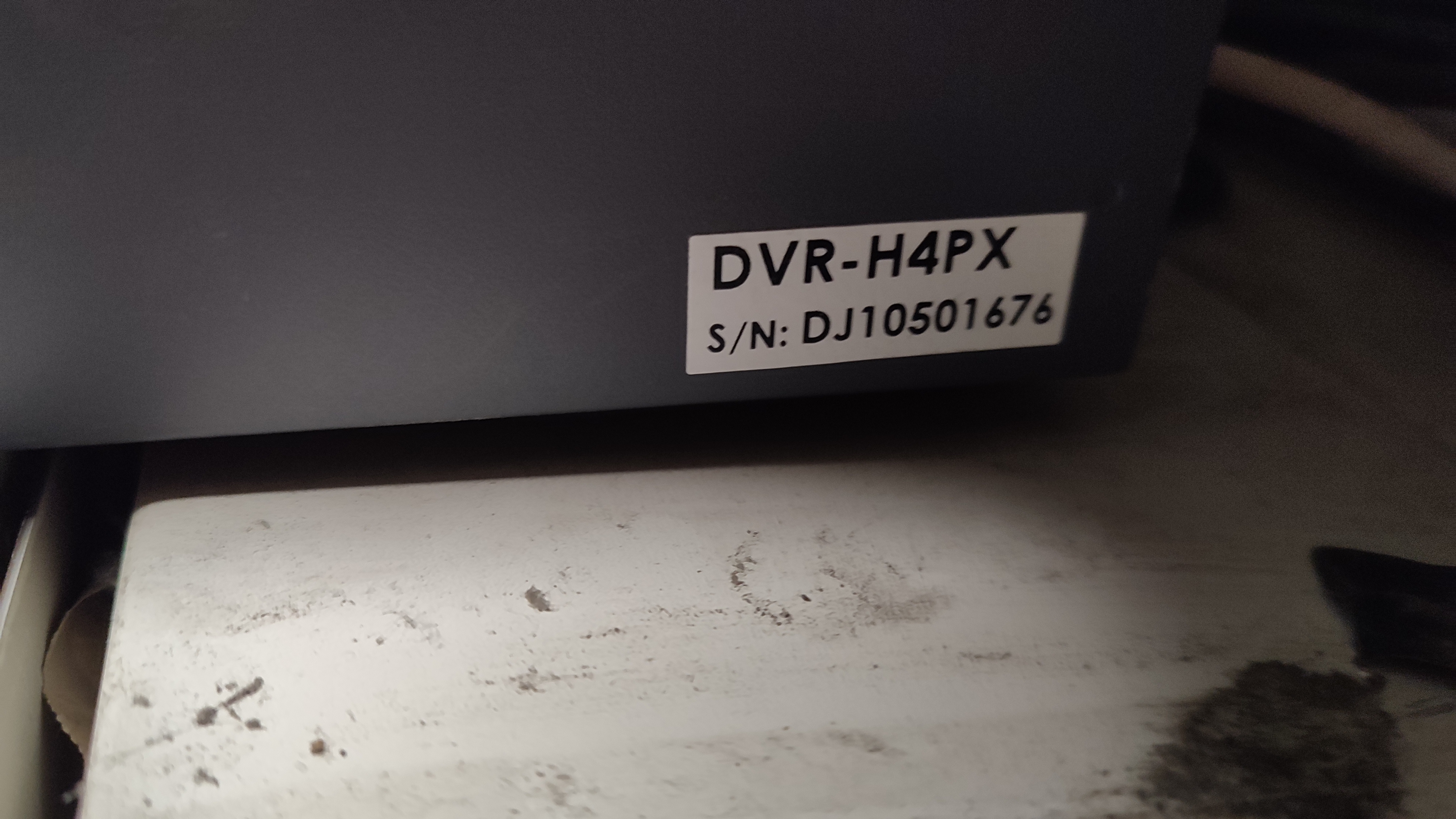

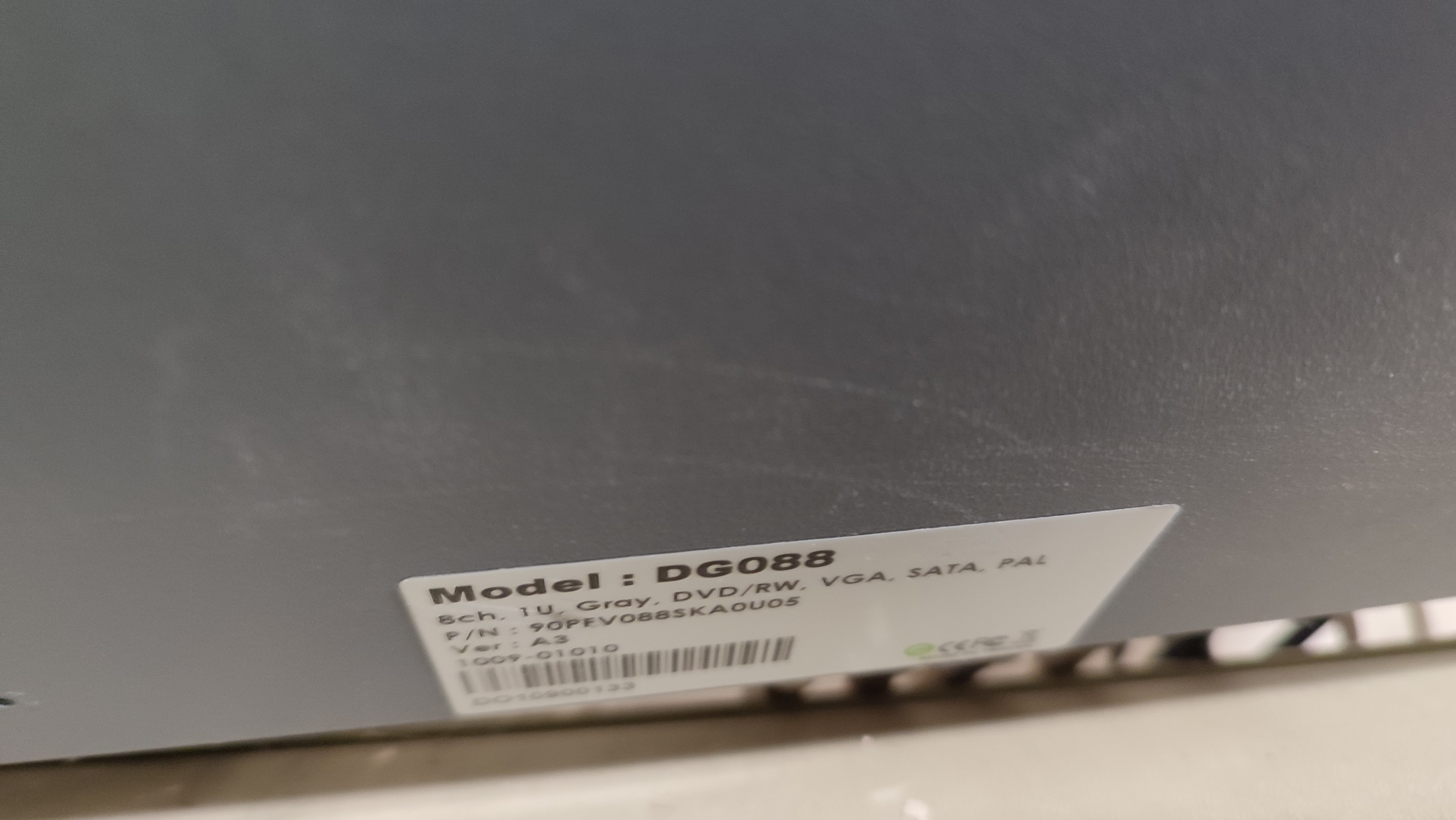

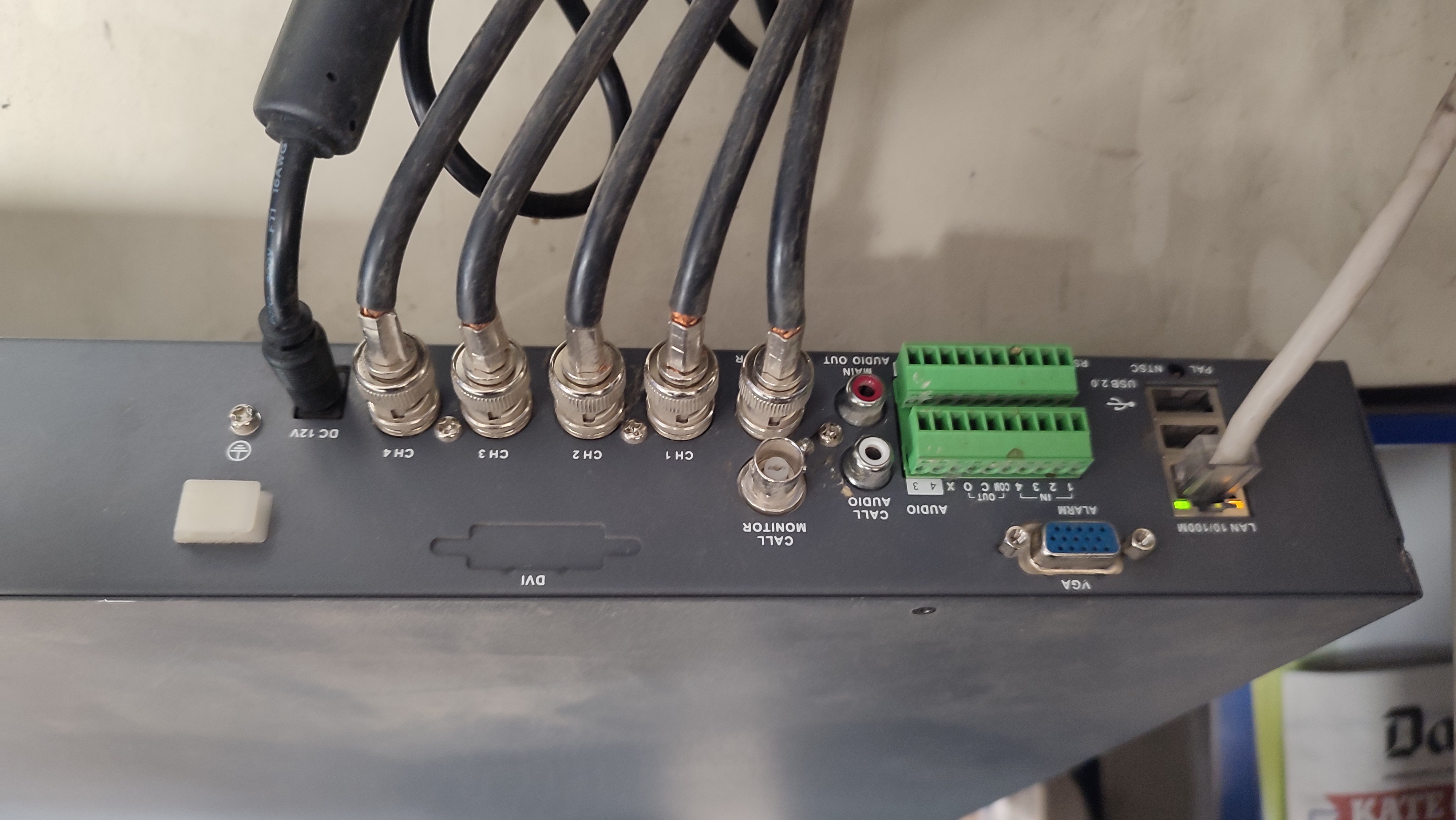

Hi David,
Thanks for the prompt reply. I have attached the pictures of all the sides.
I have the administrator username and password. Router is from Virgin media and the model number is vmdg505. DVR is connected to the router using LAN cable. Yes, the cameras are directly connected to DVR and I am using windows. However, I don't have any PC connected to DVR.
Hope this would help.
Thanks for your help once again.

Hi David,
I don’t know the hub5 but hope the rough guide below helps.
You mention that your DVR is connected by a cable to the router, bear in mind that your router may not be connected to the DVR from a network sense.
If the DVR has an IP address given by the router it should show up on the router webpage “Connected Devices” menu. I’m hoping it will be obviously named DVR or maybe the model number from one of your images. If you click on that device you should get the IP address.
From your computer open the web browser and type in 192.168.0.1 in the address bar and press enter. Type in the router password (see label on router). You should see the home page with a menu list on the left hand side. Click “Connected Devices” you should then see a list of devices that your router has allowed a connection to. As I said above check the names of the connected devices.
Routers can also assign a generic name to older Network Devices making it hard to identify. Take a screenshot of all the connected devices, logout from the router. Switch the DVR off and wait 5 minutes then login to the router and check the connected devices to see if one has gone, refer to the screenshot. If one device has gone it may be the DVR, double check by switching the DVR on again. Wait 5 minutes, refresh the connected devices list to see if the device has come back.
