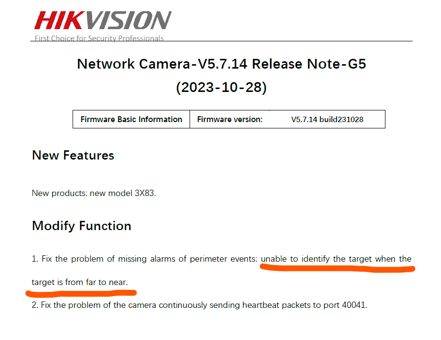

The problem of target detection(tracking) is exactly the same with latest firmware 5.7.14 build 231213 SP2 for object movement near to far and far to near.

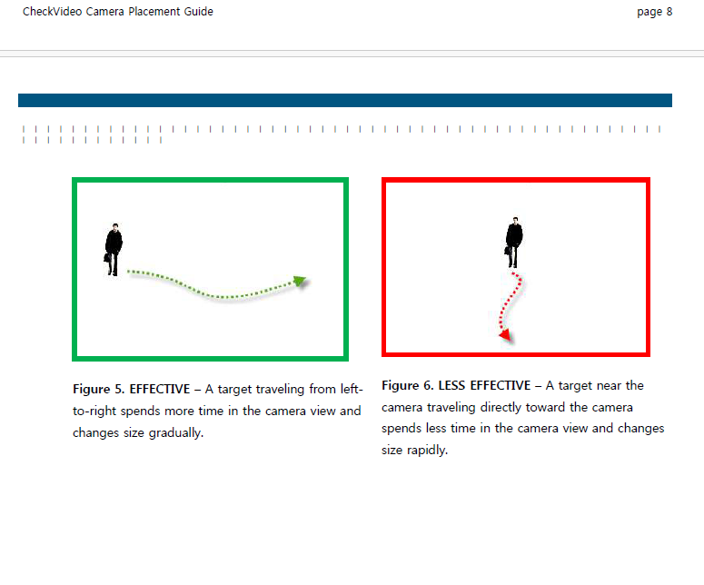

Something like this:

May be I am wrong about "only Human"
Butterflies, insects, birds, cats, move around and this could be the cause of their detection.
I was trying forwards and backwards and thats the possible reason I was not detected
Update:
Enabled (turn on) Display VCA rule for Hik-Connect app
Corfirmed my problem again.
Going out of my main door, I am not detected(no green rectangle) until I reach 5 to 6 feet forward. Moving left to right, right to left, or diagonial, I was always detected(green rectangle around my body)
Enabled Highlight Moving Objects and detection(green grid) was instant from the moment I was under the door(suppose this is about Motion Detection)
Another observation is that even if I am detected by Motion(green grid), when going to Playback of my NVR(DS-7608NXI-K2), select Normal, select Hybrid Camera, go down Smart Search, Select Draw Polygon, then draw the polygon, the result is empty. No detection at all.
If I go back to Playback-Event-select Hybrid camera-go down Space Rule - Draw Motion Detection Rule- draw the area, then I see the detection.
This is very complex
I feel secure if I cross-check, both kind of searching on my NVR. Playback Normal and Event. Motion and Smart events. At least for now until they solve this that they(Hikvision) said they did fix:
