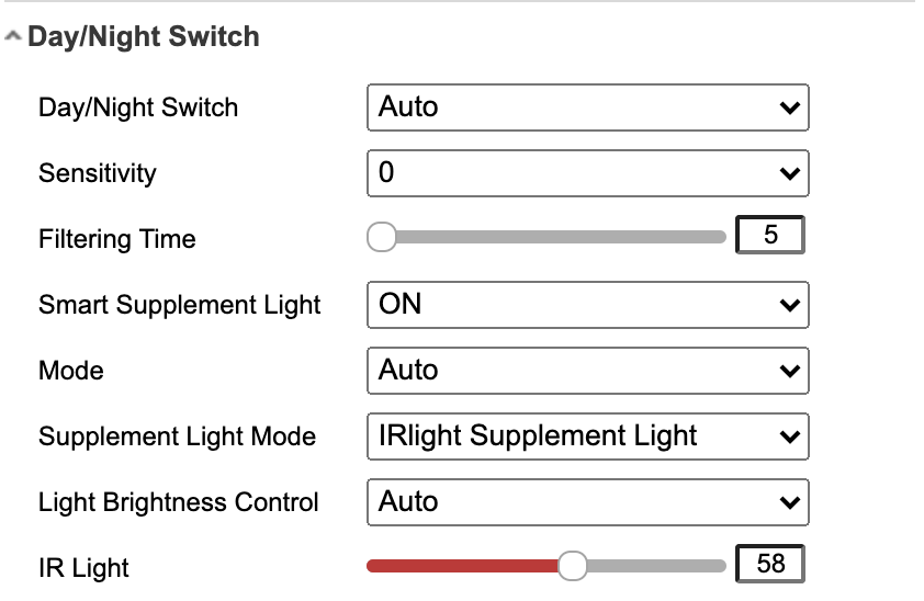

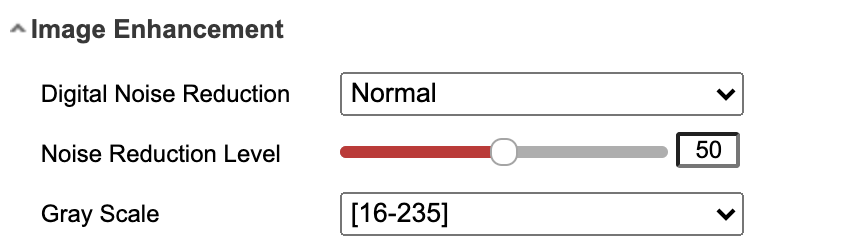

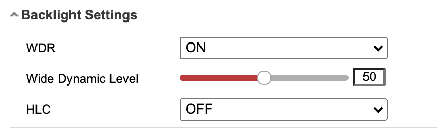

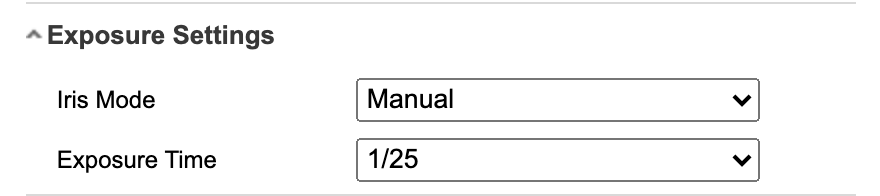

It's been about 3 months with a pair of DS-2CD2386G2-ISU/SL cameras. Overall they're great, but I'm having trouble getting the best out of them. NVR is an I-series 8ch. I have four cameras running, 2x 2386 & 2x 2346G2.
I'm experiencing the following:
  • Stop/start play back — Rewatching recordings via the app on either WiFi or 4G - it's glitchy (DS-2CD2347G2-LU are slightly better in this regard)
  • Day time motion — subjects appear to have doubled e.g. two heads, two dogs lol
  • Night time motion — lots of ghosting (camera is set to switch to IR based on light, although we have a street lamp right outside the house (it's currently broken)
    • This street light would ideally help with the ghosting.
I guess where i'm getting at is if there are certain settings that need to be tinkered with to mitigate these issues? I understand each environment is different, but I know that these cameras are capable. I'm thinking long-term plan is to replace the 2386 with 2347's.

In general there's not much wrong with the settings. I'd start by switching the WDR off completely to see if that helps (you can always decrease the contrast a bit to balance the image) The 1/25 sec exposure will cause motion blur if you pause the recorded footage as it's too slow to freeze motion, but that wouldn't normally be too obvious if watching the stream live.
Thanks @JB1970.
Turning WDR off has helped significantly!

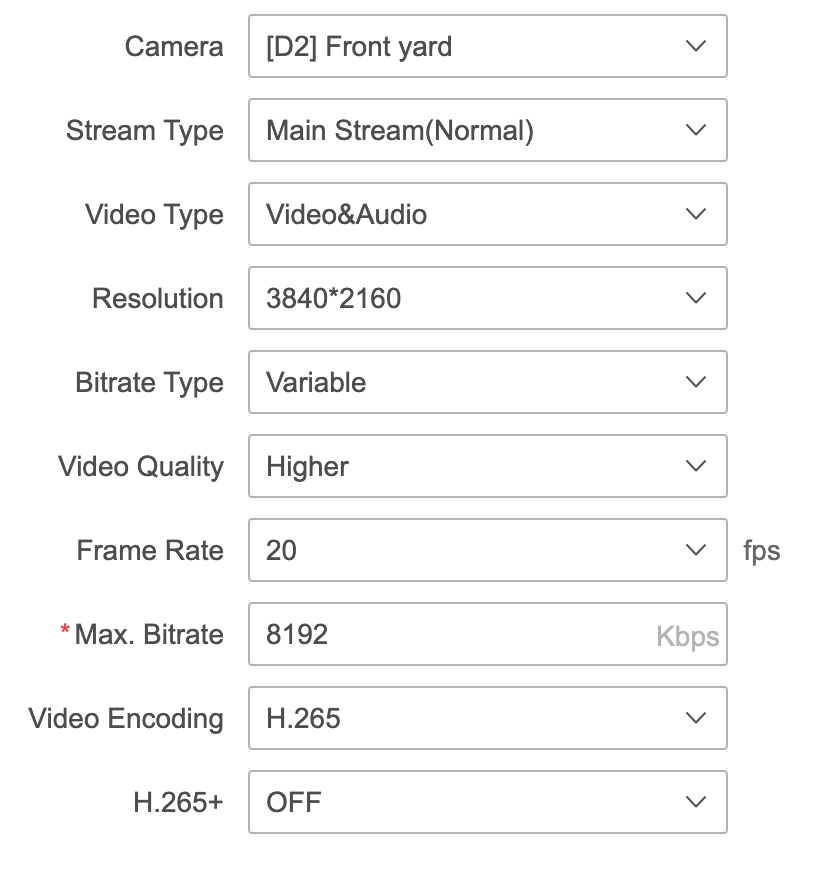

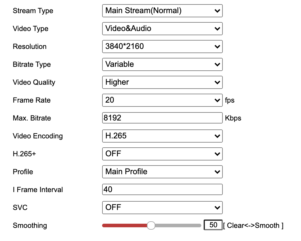

Only issue i'm finding now is that play back seems to stop after 3 seconds and I have to scribe through to about halfway before I can view the rest of the recording. Any ideas with this one? Should I reduce the bitrate and/or frame rates?

A few things that could be causing that:
1 - Using the menu on the NVR directly (on the monitor/TV) go to Camera (icon) > Video Parameters. Ensure that for all of your cameras, that the Main Stream (Event) settings are identical to the Main Stream (Continuous) settings.
2 - Using the NVR menu again go to Storage (icon) > Schedule > Record. Click the Advanced button (top right of schedule screen) Make sure Pre Record is set to 0 (not the default of 5 seconds) click OK then Apply. Repeat for all cameras. Pre Record time is only needed if you're recording solely on event/motion etc. If you're recording a 24/7 schedule, having the pre record set to 5 seconds can cause the playback to freeze on motion then skip over the event.
Your frame rate and bit rate should be OK. On my own system (16 channel I series) I have two of the 2386G2's and seven 4 megapixel models (mainly 2346/2347G2s). I have the 2386s set to Variable Bit Rate, Higher Quality, 20FPS (the same as you) but have the bit rate a little higher at 10240. Check the two points above first.

Thanks for the tips. I did notice a lot of discrepancies between Video Parameters on the NVR and Cameras.
I'm only recording for Events at the moment and have the pre-record to 20s to capture details before hand. Is that still relevant? Should I reduce the pre-record duration and bump up the post-record duration?
They should be the same. If the cameras are recorded using an NVR, I recommend to always carry out the programming using it. The camera settings are only saved in the camera itself not the NVR. The NVR just reads the settings that are in the camera and displays them in it's menu. If you program the camera directly using its web interface, the information appearing in the NVR may be out of date from what is actually programmed and can cause issues solely because it's inaccurate until the NVR is rebooted.
