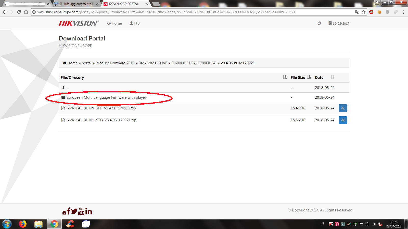

hello everyone, a simple question I would like to do was downloading the update for my Nvr when I find the firmware version En and Ml and a folder with written: Multi-language European firmware with reader, what does it mean with the player? I have a Nvr 7600 E1 4p which one to choose? thank you
EN = English only
ML = Multi-Language (which also includes English)

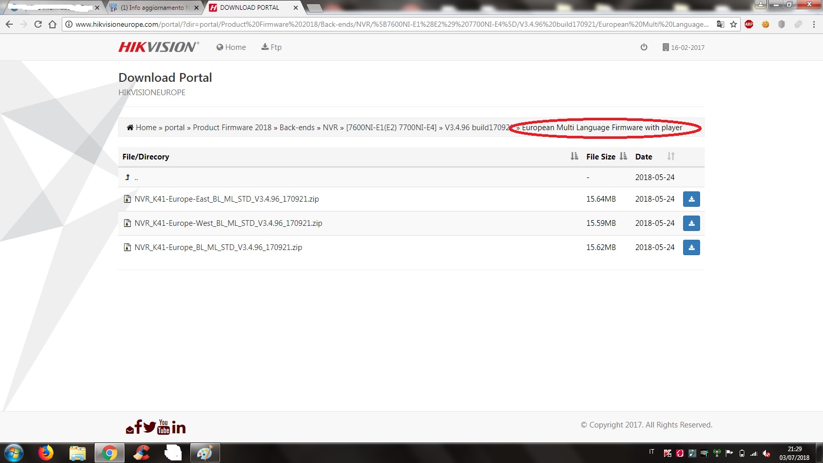

Just a folder containing the same firmware with other language options for other regions
It's in the release notes when they added it -
1.
Video Player
In older version, E series Multi language firmware doesn’t contain video player when users
exports videos. In this version, European regions’ firmware is divided to specified area, user
can choose multi-language version with video player
