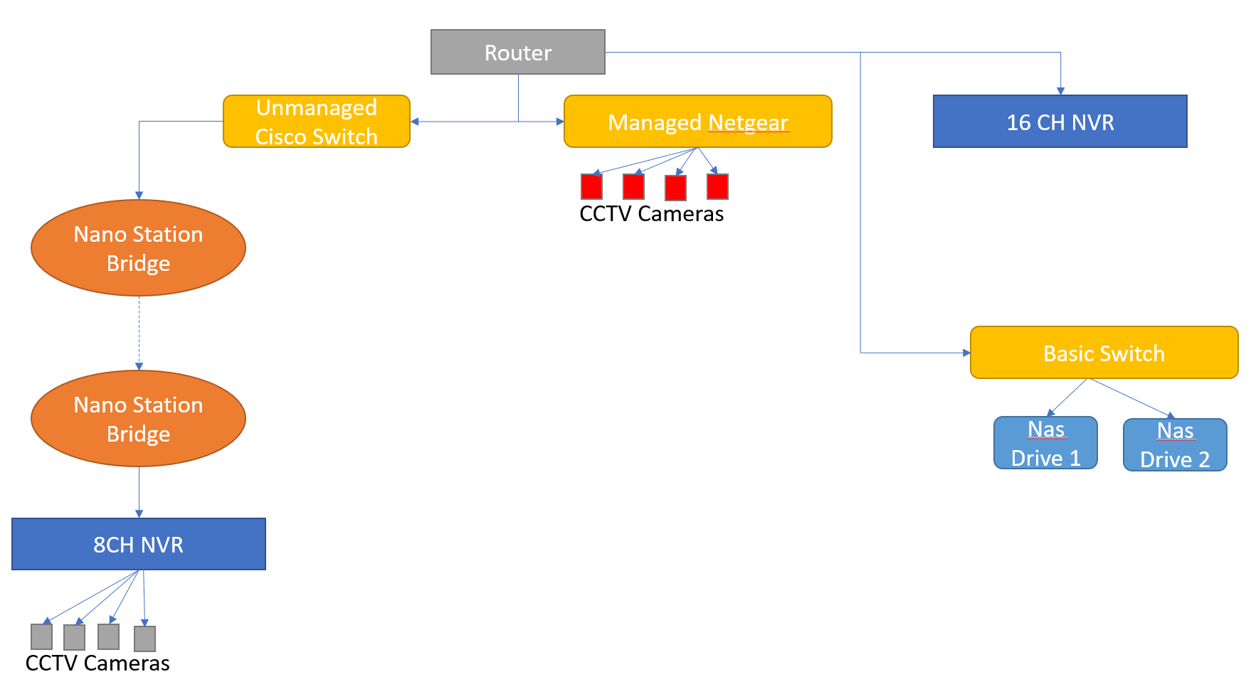

I had a 16 CH Hik NVR working perfectly with a static IP (192.168.1.88) and the cameras connected to a Netgear Managed POE Switch (192.168.1.235) and the cameras having static IP’s (7 hik 192.168.1.92/93 etc and 1 Axis Camera). On the NVR under Camera Management I set the correct IP and all is good.
I have now connected a wireless bridge (might be irrelevant) and at the end of the bridge I've connected an 8CH Hik NVR (192.168.1.89) and 3 hik cameras connected directly to the NVR. Under Camera Management I set to Plug and Play and that works fine. (both sides of the bridge have a different static IP (192.168.1.20 and 21))
I had some problems connecting the bridge, and once I had got the two sides communicating, I then had problems knowing which were the Camera Cables and which was the Lan Cable. I resolved this by just trial and error and connecting the Lan ethernet (from the wireless bridge) into the camera port and cameras into the Lan – until I worked out which was the Lan. (I hope that makes sense ). Once the 8CH responded to a Ping from the network I knew that I had connected the Bridge to the Lan port on the NVR.
So – once the 8CH came online to the network (having sorted the bridge) the cameras connected to the POE switch wont connect and the 16CH only has the Axis Camera available (which is connected to a Cisco Unmanaged Switch – which connects the bridge)
I cant ping any of the cameras that are connected to the managed switch. The managed switch works fine and I can connect to it ok and ping it.
I have rebooted the router, POE switch, both NVRs but this hasn’t resolved the problem.
Common sense suggests that the problem is the Netgear Managed Switch, but I can log on to this fine. Could it be that the 2 NVRs are somehow fighting against each other?
