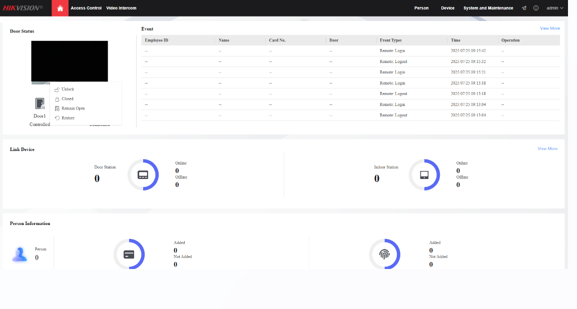

Manually you can unlock and keep it open on new firmware It has 4 options: Unlock,lock, Remain Open, Remain Closed.

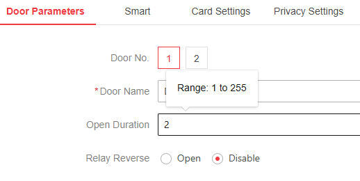

But maximum time set to hold is 255s via lock options.

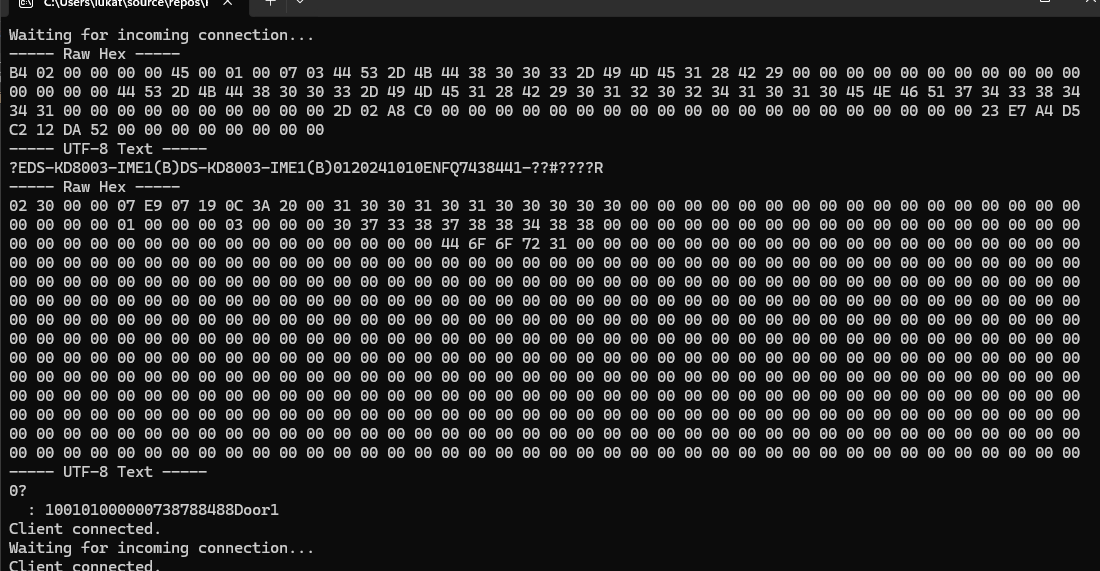

Well you would need a device in your house working 24/7, either small RaspberryPie or windows NUC, a custom made small service that fetch realtime events and push command via API back to device.
an example fetching card swipe on device event
And as soon service catch that event, you could trigger PUT request
url:
body:
'1.0' encoding='utf-8'?><RemoteControlDoor xmlns="同创杨梨园" version="2.0"><cmd>alwaysOpen</cmd></RemoteControlDoor>
After that you could wait for event alarm input(some trigger, either door closed or timer relay whatever) via same service, and simply close door
