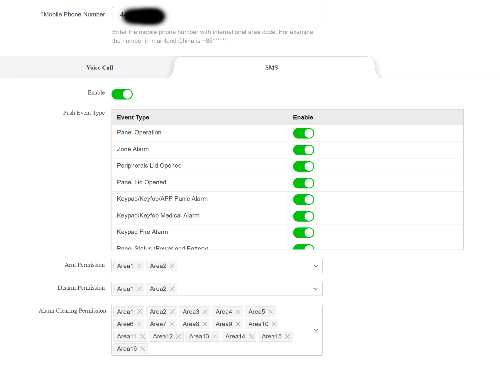

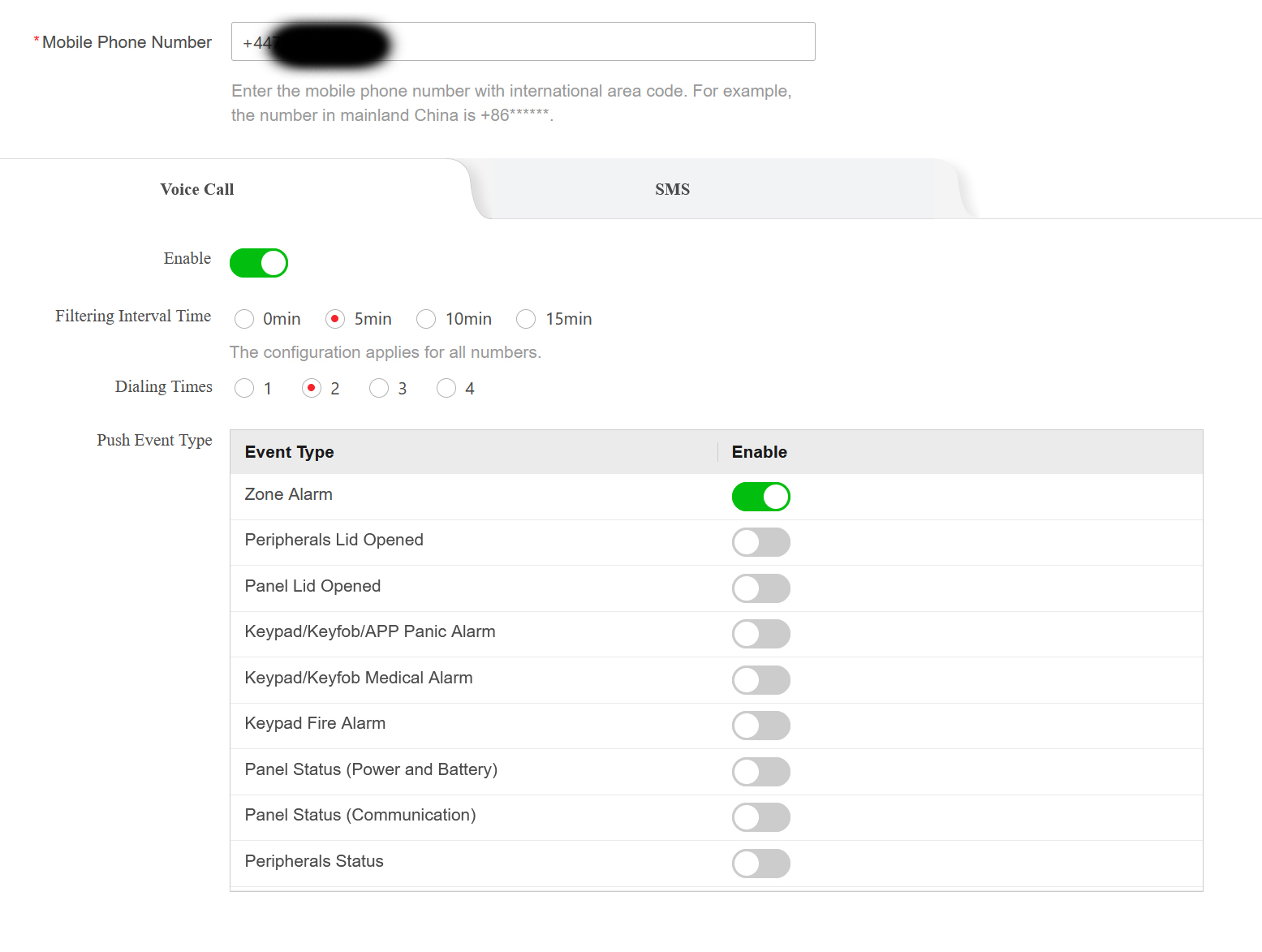

You need a sim card in the AX Pro to enable text and calls. Although you can have multiple dial-outs - there's no option to separate the calls into zones. These are the simcard dial out/sms out options:
