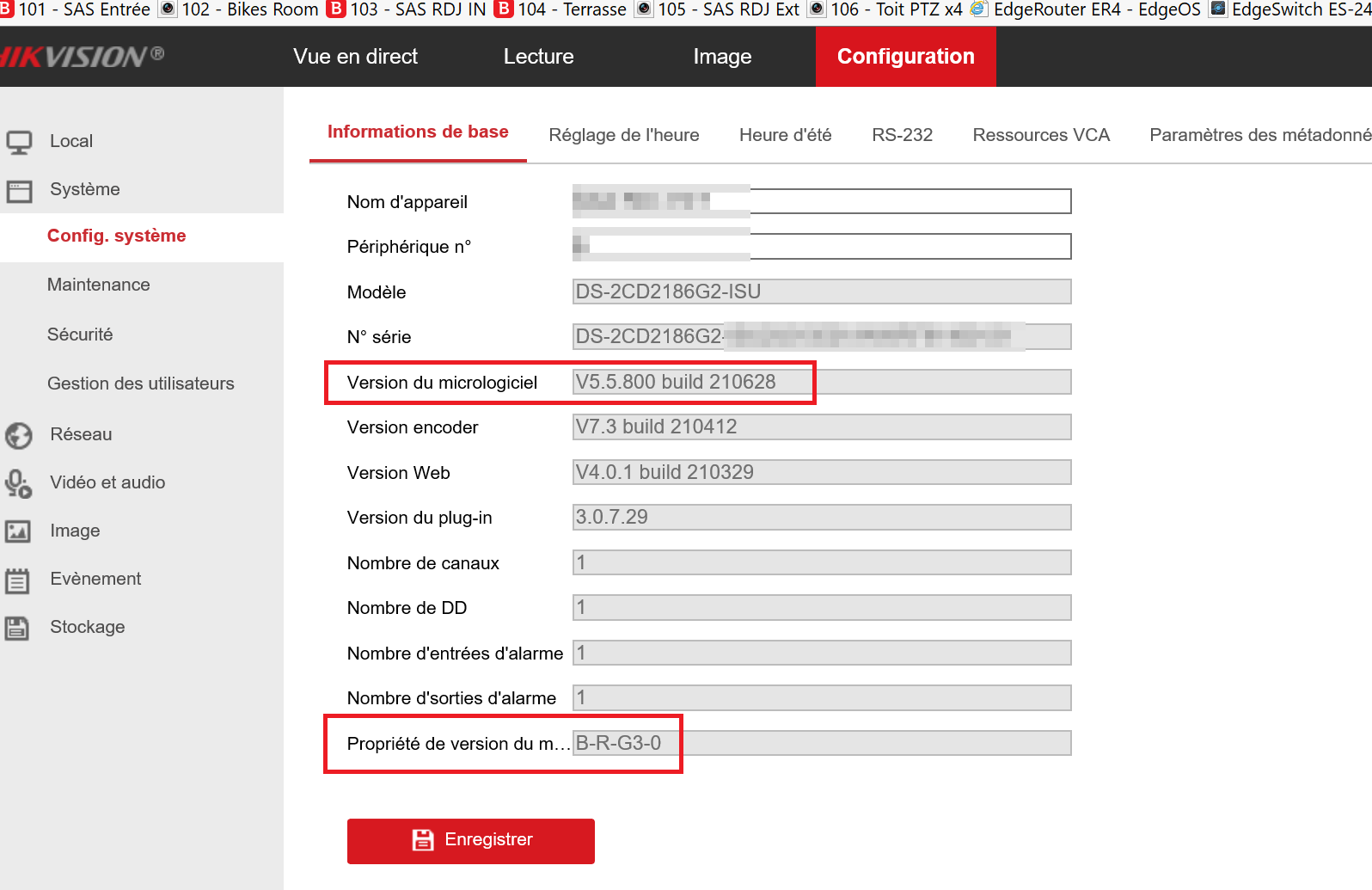

I have this camip (DS-2CD2186G2-ISU ; 4K, AcuSense, etc...) work great but... impossible to update !
My last one was build in may 2021, with factory firmware V5.5.154 build 201010 (B-R-G3-0)
I found no where this firmware ?!
only this one : V5.5.154 build 200928 (the closer one)
Apparently, this camip are still in production, a lot of new firmwares seams to be aviables...
But no one work with my camip : v5.5.160, v5.5.180 ??
what is going on ?
Any ideas ?
fake camip ?
Regards

I find the probleme... Usually, I use 7Zip by default.
I try to uncompress with windows 10, the basic tool, and the update works !
I update correctly from factory firmware V5.5.154 build 201010 (B-R-G3-0), with regular G3 firmware V5.5.800 build210628 (G5 dont work in my case).
Enjoy,
