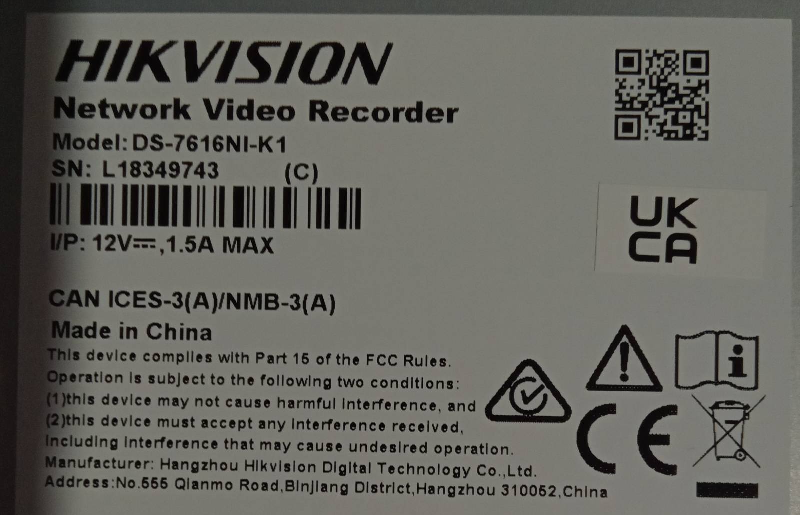

Just purchased a second hand (But supposedly brand new) DS-7616NI-K1 NVR. Upon arrival, it reports firmware version V4.72.107, Build 220914. What has me confused is the different hardware versions, specifically (B), (C), etc.
My NVR states 'Hardware Version: B-R-K9B2-00', which made me wonder if this was a (B) type unit. However, looking on the Hikvision Firmware Portal, the latest firmware version for the (B) version is 4.30.097. (See Here). I can only see V4.72.xxx under the section for (C) type NVR's, and even here, the firmware does not quite match. See below details of my NVR, hoping someone can help me identify the unit and point me in the direction of correct firmware. I believe the 'RR' in the serial means 'Region Unspecified', not sure if this is relevant when selecting firmware?

I have just spotted a very small (C) on the label of my unit which I hadn't spotted before. Attached is a picture of the label. Does this mean the unit is a (C) type unit?
Latest according to Hik Partner Pro and the global Hikvision site is 4.72.109_231007.
Yours is definitely a (c) revision model.
Thank you. I have now upgraded to v4.72.109 and everything went well.
