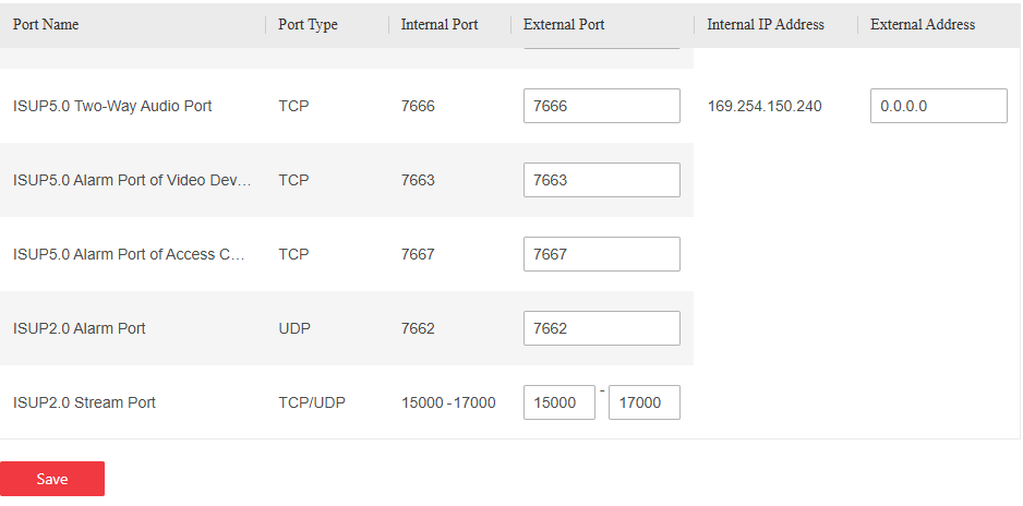

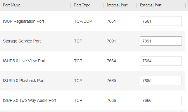

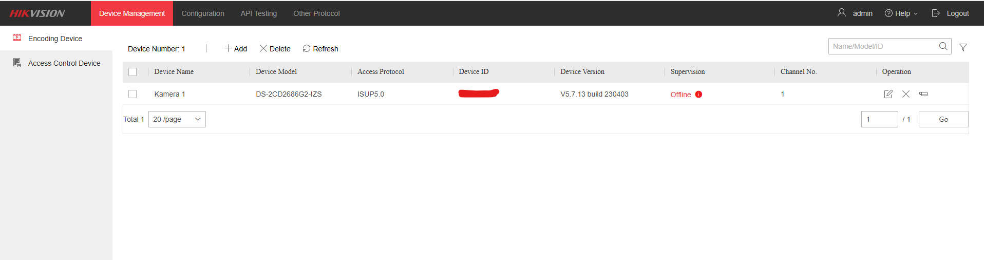

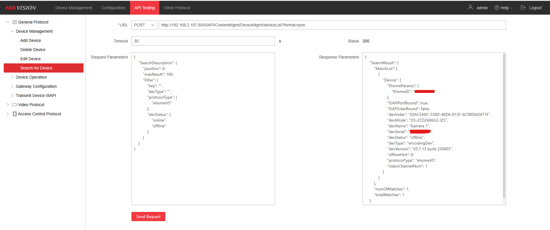

I try to start alarm listening using ISUP Sdk but has error in TCP connection and when i using CMS port have another error.
ALARM_SDK.NET_EHOME_ALARM_LISTEN_PARAM params = new ALARM_SDK.NET_EHOME_ALARM_LISTEN_PARAM();
params.struAddress.szIP = "0.0.0.0".getBytes();
params.struAddress.wPort = 7442;
params.byUseCmsPort = 1;
params.fnMsgCb = event;
params.write();
System.out.println(ISUP_ALARM.NET_EALARM_StartListen(params));
System.out.println(ISUP_ALARM.NET_EALARM_GetLastError());
NET_EHOME_AMS_ADDRESS x = new NET_EHOME_AMS_ADDRESS();
x.dwSize = x.size();
x.byEnable = 1;
x.struAddress.szIP = "myip".getBytes();
x.struAddress.wPort = 7442;
x.write();
System.out.println(ISUP_CMS.NET_ECMS_SetSDKLocalCfg(1, x.getPointer()));
System.out.println(ISUP_CMS.NET_ECMS_GetLastError());
