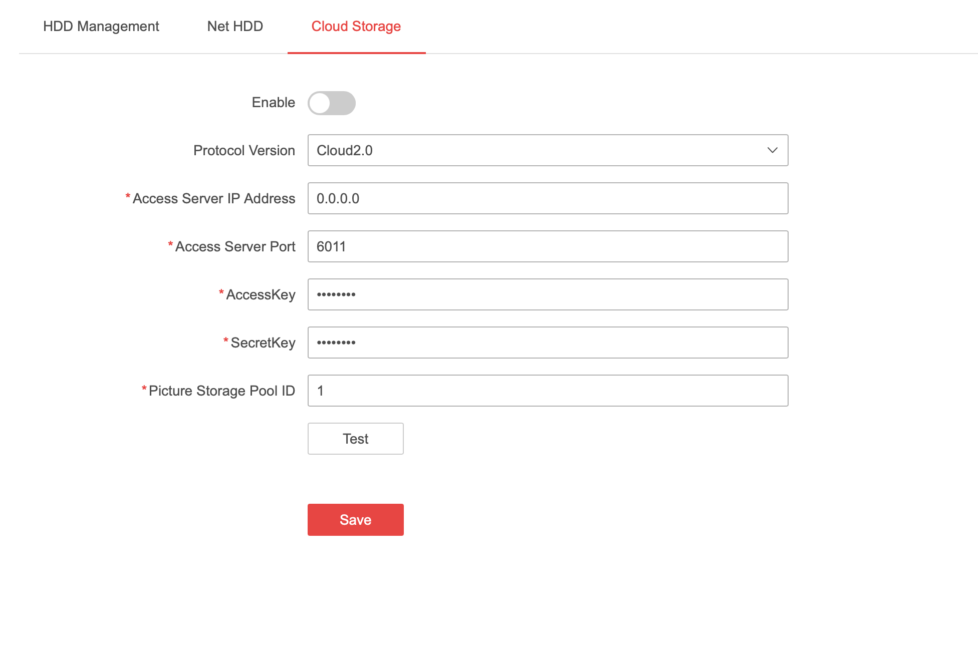

Just got my Mini Dome 4k (DS-2CD2583G2-IS) installed on my canalboat, very happy with the quality and the fact, that I'm on a mobile router with a SIM card and no issues with a connection at all. I have tested with a 5G antenna and got a full 4k feed on mobile devices outside of the home network, which is amazing.
The only thing that bothers me is that I was expecting to have some cloud storage options within settings, like Google Drive or Dropbox, but have only the Cloud 1.0 and Cloud 2.0 options.

Can please anyone help me with the options I can use for cloud storage, how can I get the footages saved?
I have a 512GB memory card installed, this gives me about 2 weeks of recording with motion set at 20%, but I do prefer to have a longer timeframe saved somehow.

Hi @F05te-801384 -I'm afraid that the Cloud 1.0 and 2.0 options are a case of Hikvision naming a feature in a misleading way...
This won't actually allow you to save footage to a third party cloud storage service like Google Drive / Dropbox.
It's actually just a way to link the camera (or NVR) to a different NVR to act as a remote storage server. Dan explains it in more detail here:
So, your best option to increase the storage capacity is to upgrade the microSD card to something larger - you can even get 1TB cards now:
