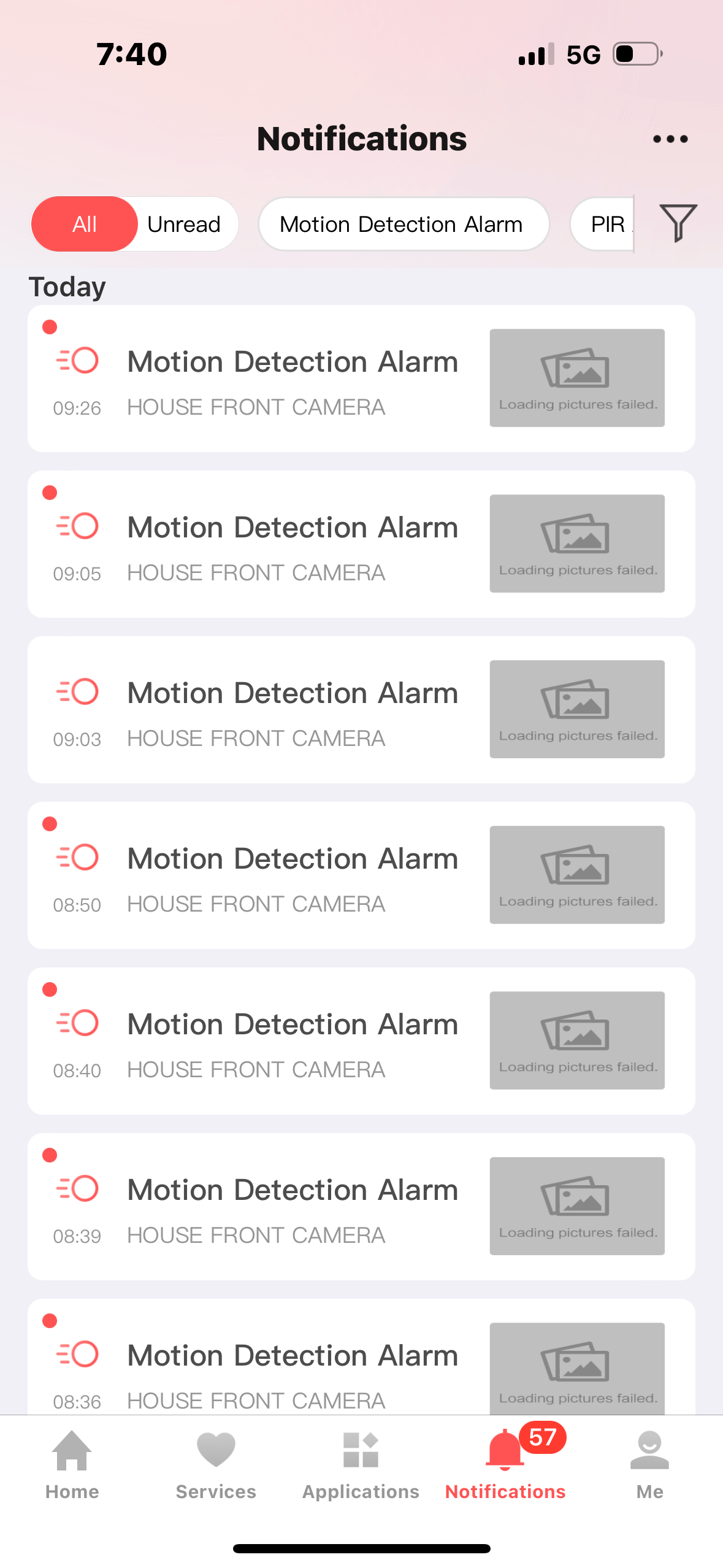

I am currently living in Dubai. My cameras are installed in India. The motion detection Alarm doesn’t download pics in Dubai well as in India it works fine. I checked with the local mobile internet provider and they said everything is working fine related to data speed. However the motion detection Alarm pics gets downloaded when connected to WiFi.
Any help please

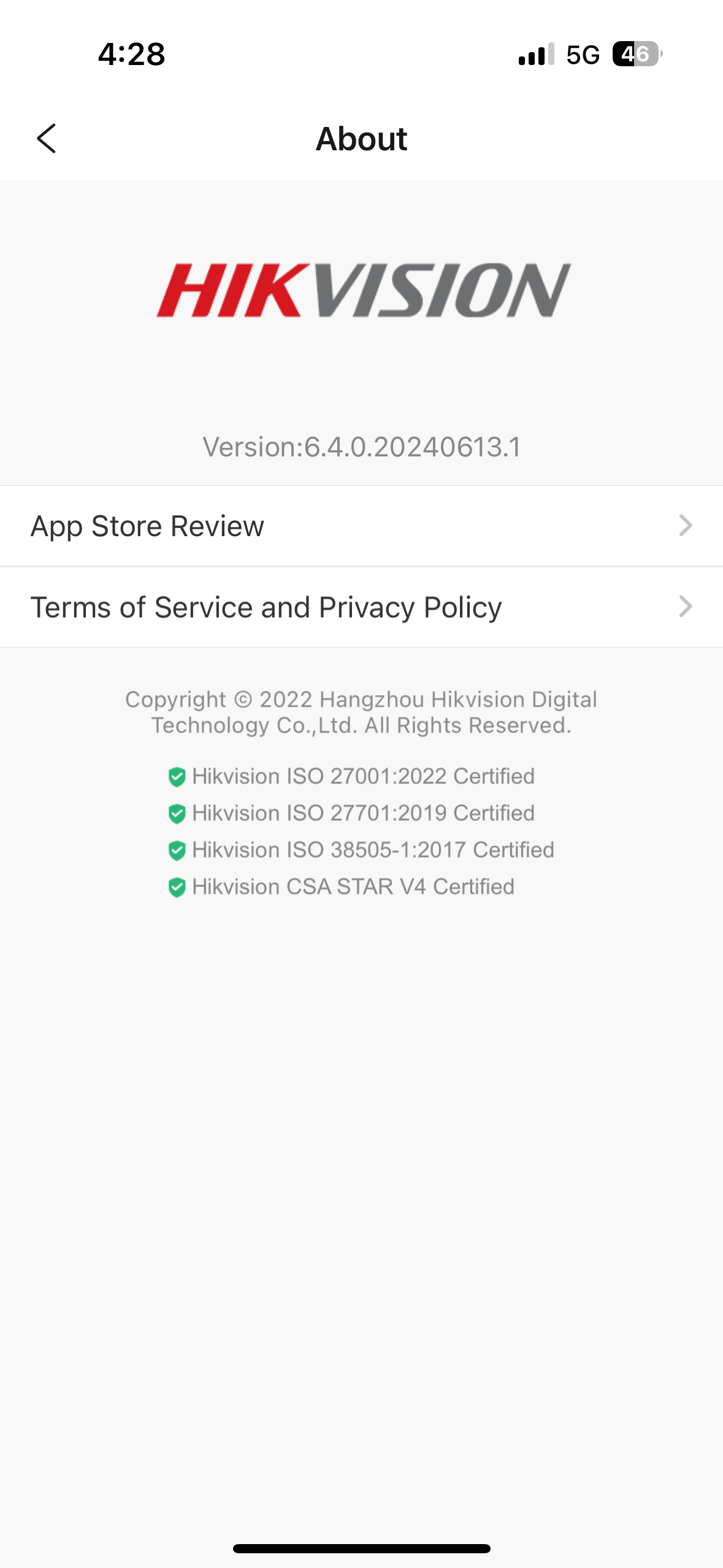

What version of Hik-Connect are you using?

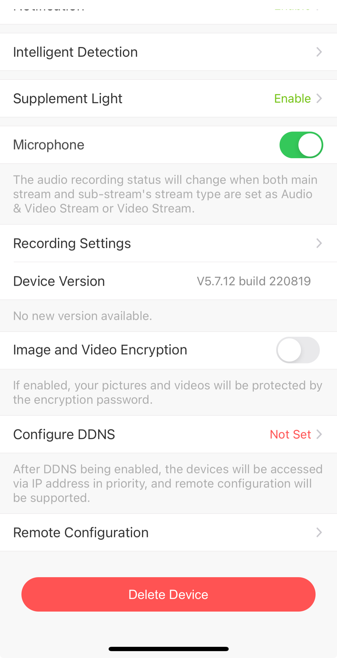

Also, if you have stream encryption enabled (if you're using an NVR), try disabling this.

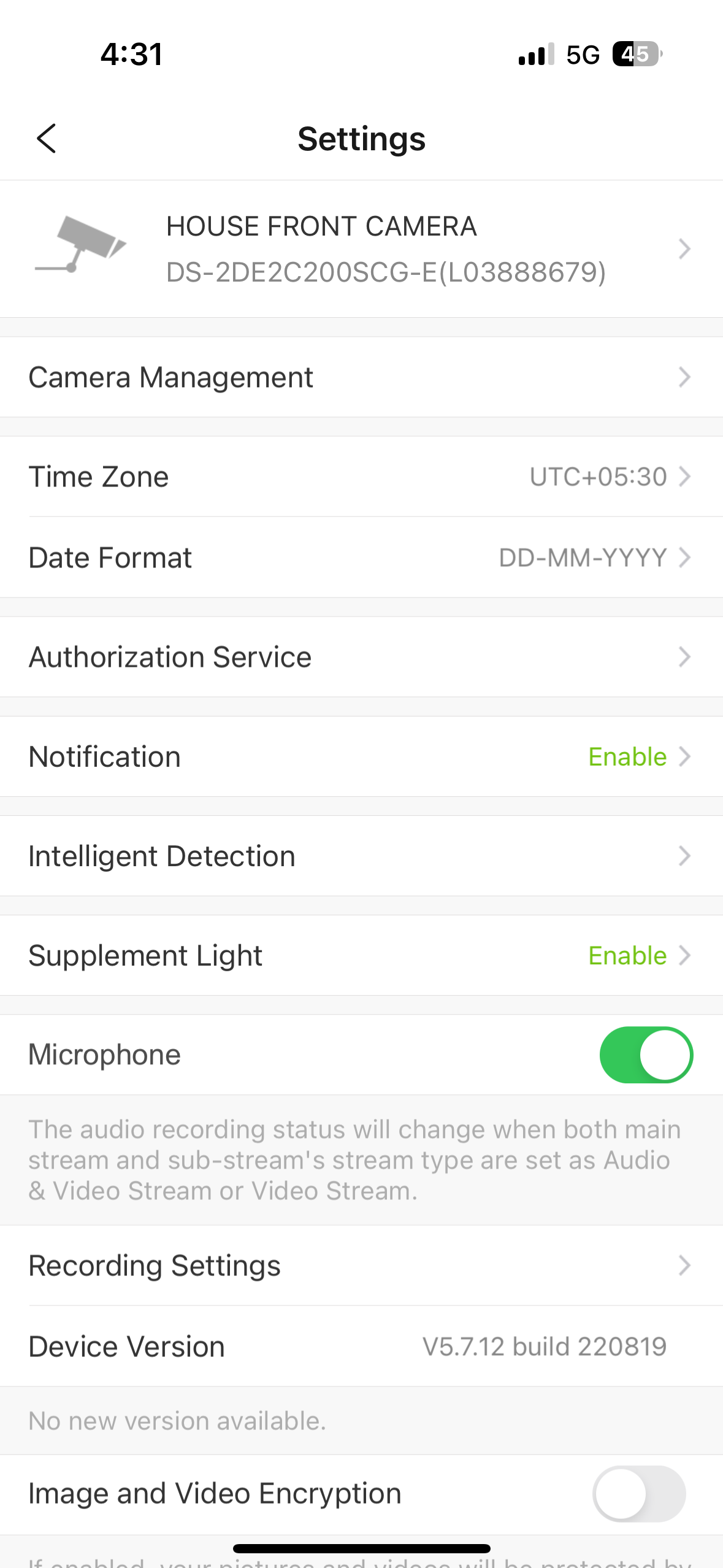

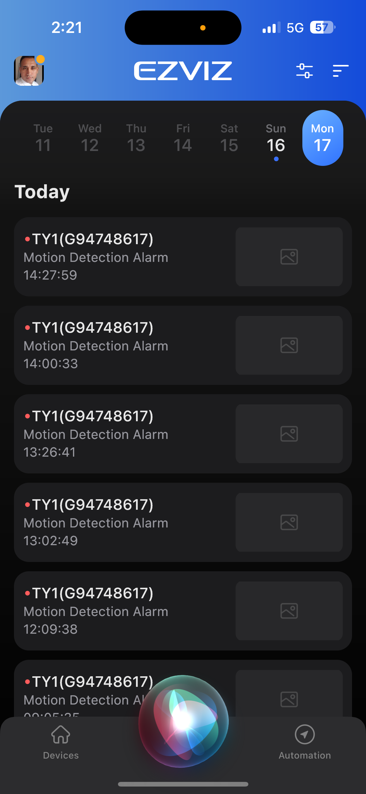

Thanks for the feedback. I also have a Ezviz camera which works on the same WiFi in which the DVR is connected back home in India which is connected to my phone in Dubai has same issue. Attached is the screenshot. Also attached the Hik-Connect version.

Thanks - what's the full model number of the camera please?

The Hik-Connect version isn't actually showing in your second screenshot (the camera firmware version is) - go to Me>About and it will show you in there :)

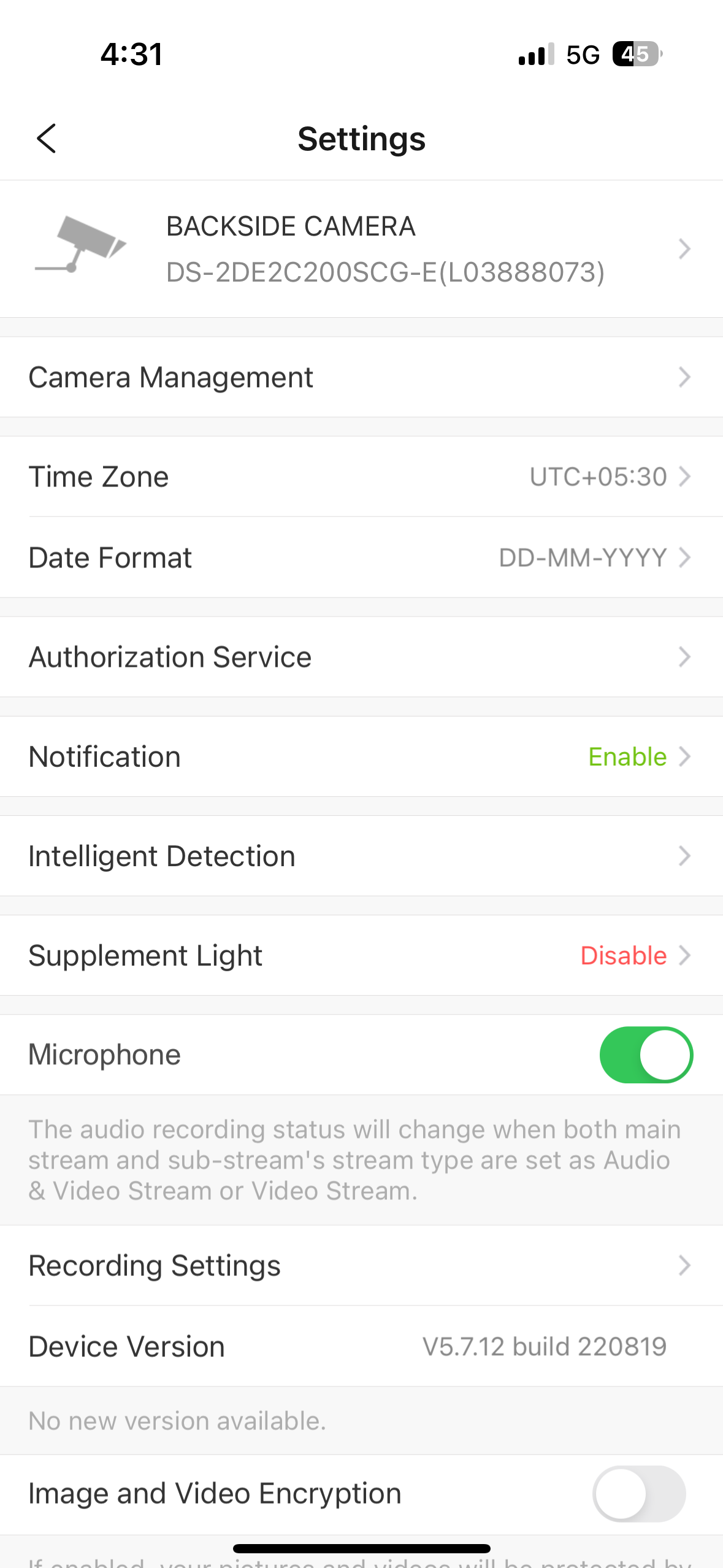

Thanks. Two HIK vision 360 pitz camera’s are connected to the DVR and one Ezviz camera is connected to the WiFi with SD card. Both have similar motion detection issue. Attached are the screenshots of the camera model and version.

OK, try updating the camera firmware to V5.7.20 and see if that helps first.

We don't have much experience with Ezviz, but the fact you are seeing the same issue on both apps / cameras suggests that there could be something on your network blocking the pictures from being sent to the apps too, so check any firewall settings aren't the problem (or test temporarily with firewall disabled).
Hi dear, just to let you know that the motion detection pics were not loading due to the cellular data blocked the app from performing some functions. I used VPN. Pics are downloading once they are clicked. Thanks for the help.
Thanks for letting us know, I'm glad it's working now.
