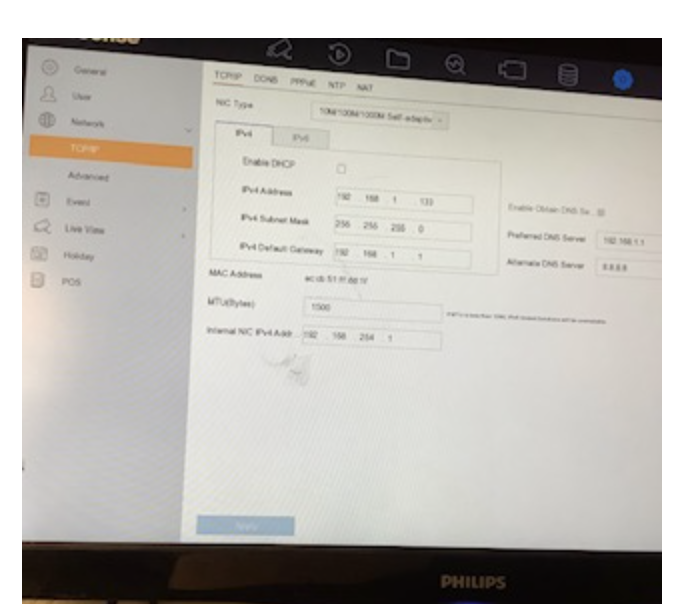

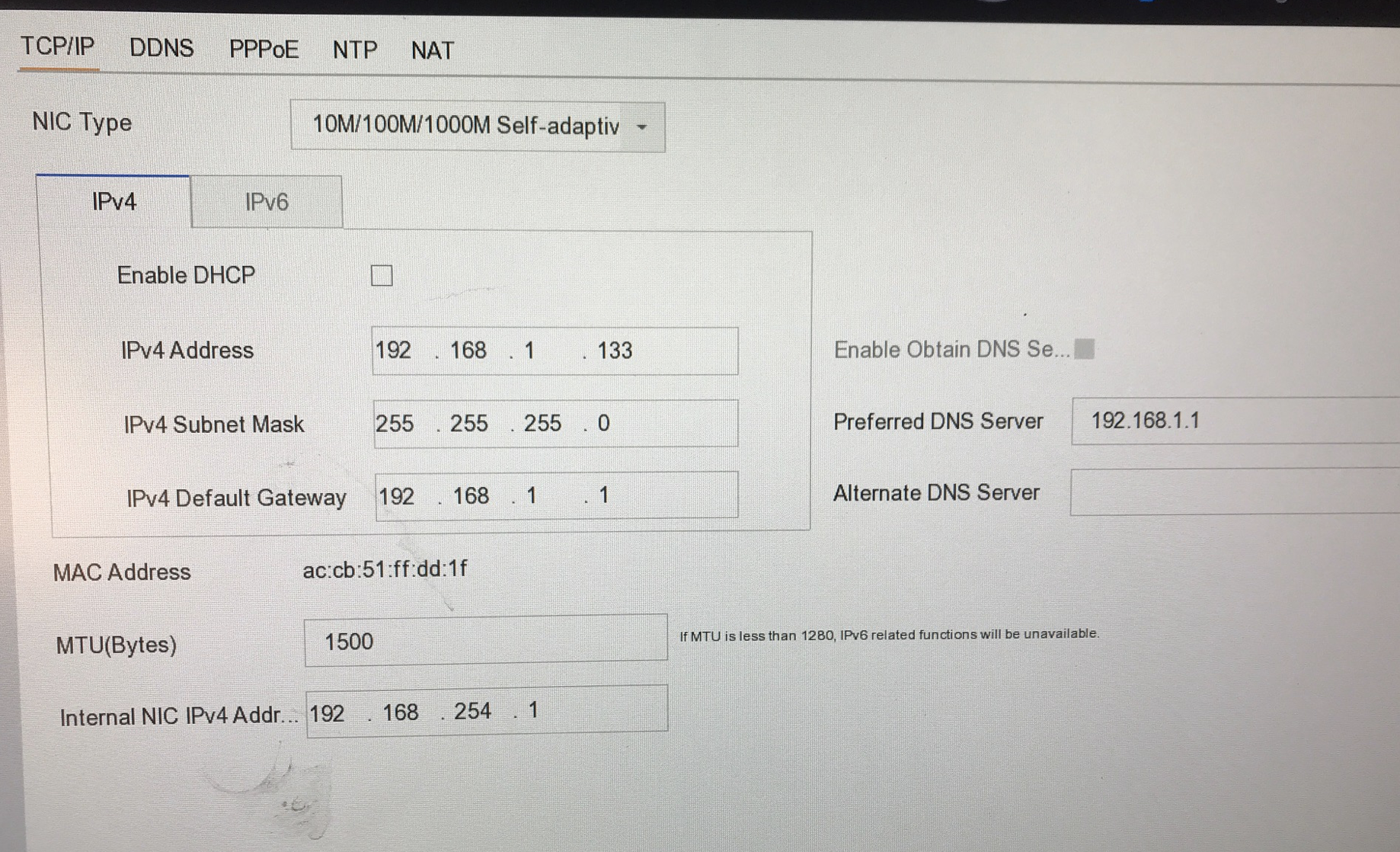

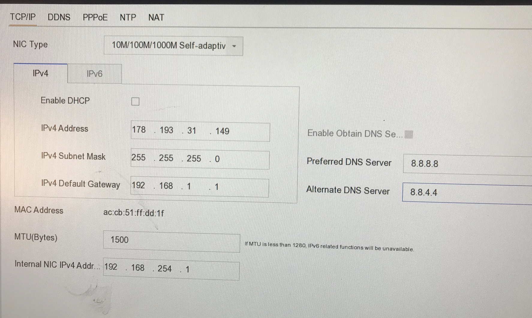

Is your NVR's Network Settings fully populated, with the gateway address and DNS fields completed?
Yes and alternate DNS server at 8.8.8.8.

For a test, try making 8.8.8.8 the Primary DNS - sometimes there can be issues with using your router.
Google's secondary DNS is 8.8.4.4
Are you confident that your gateway and NVR IP addresses are correct?
It's hard to see exactly what they are in the photo.
Are you sure that is the correct address for your router?
If you enter that in your browser's address bar do you then see your router's login page?

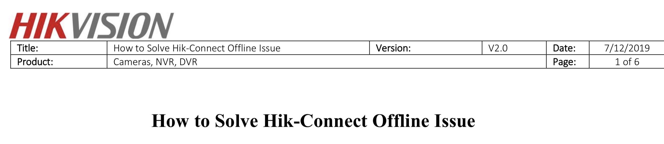

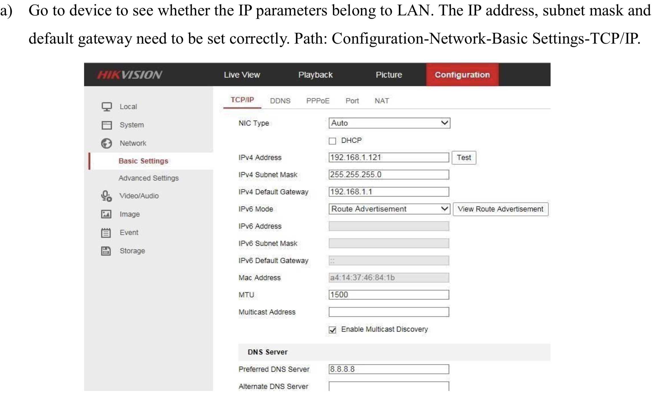

No luck Linked to the main but router the problem persists. Followed instructions @ HIKVISION see below. Changed IPv4 Address from 192.168.1.133 to 192.168.1.121 and changed "dev.us.hik-connect.com" to " Dev.hik-connect.com" and also tried "Litedev.hik-connect.com".
"dev.us.hik-connect.com was already by default in my recorder and may apply to the US market.

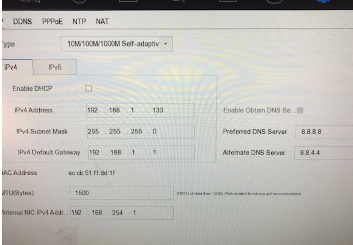

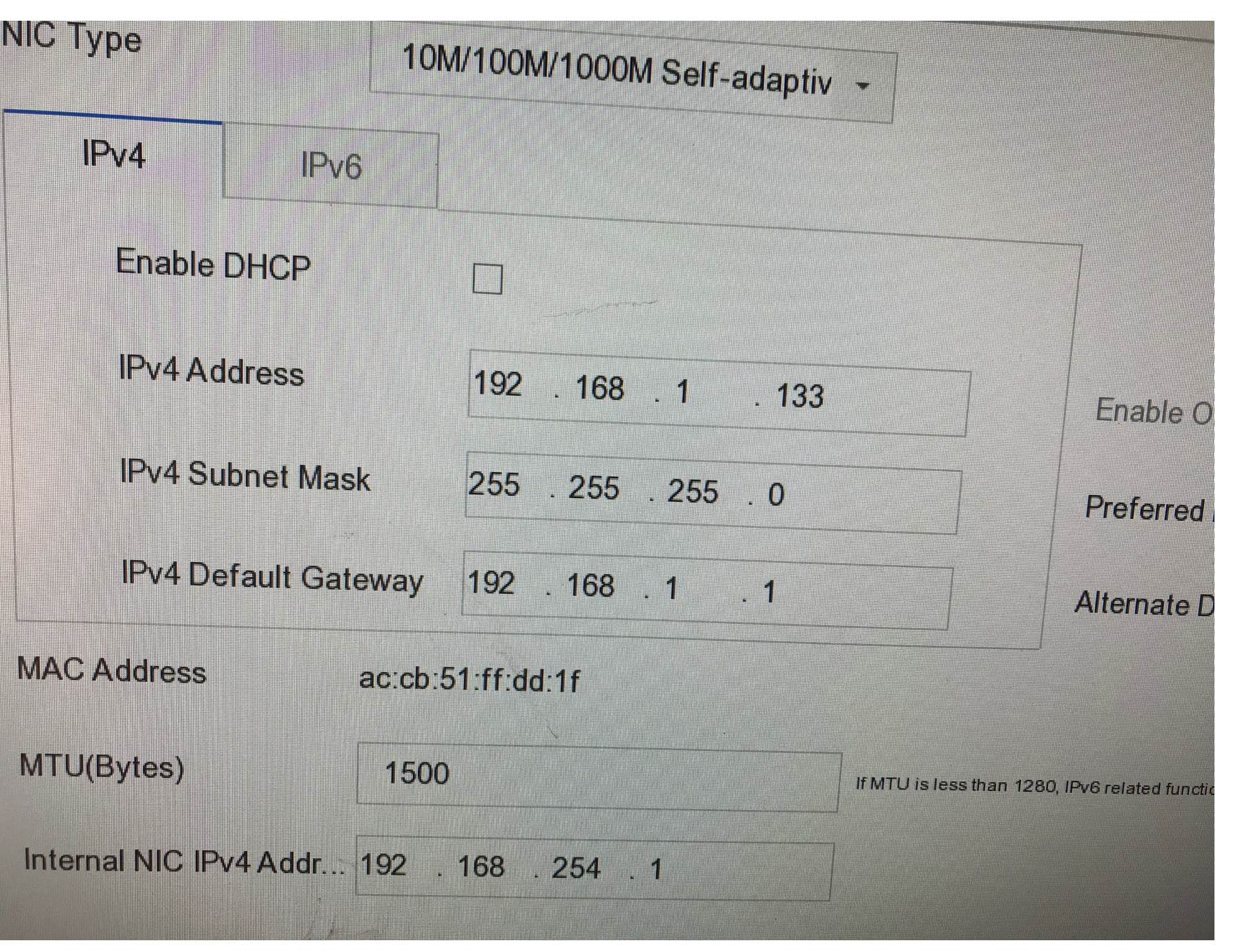

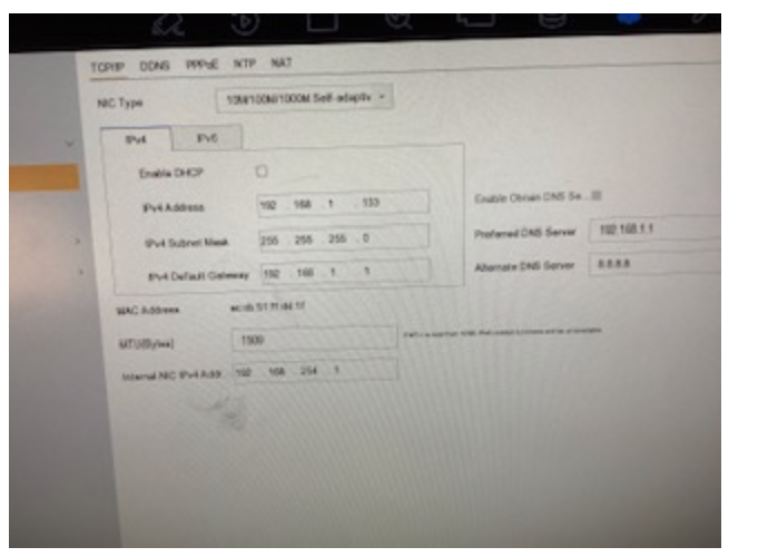

Phil I did as you said.
First action:
Second action:
Still the HIKVISION device management tells me that the device offline.
