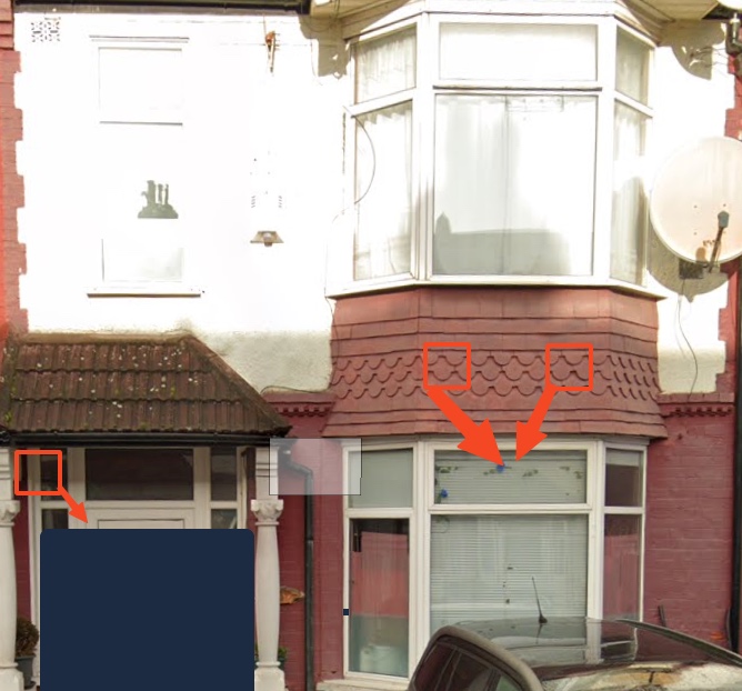

The property has bay window like this picture I found on google but my drive way is much bigger - I am considering like this?

In regards to cameras, we would probably recommend 2 cameras for the front of the house. Under the porch roof, we would probably recommend a Hikvision Mini Dome camera like the DS-2CD2546G2-IS 4MP AcuSense Mini Dome and for the other camera, we would recommend something like the DS-2CD2386G2-IU 8MP AcuSense Turret mounted at the front top left of the property (either just under the eaves or actually on the soffit if it is larger enough).
