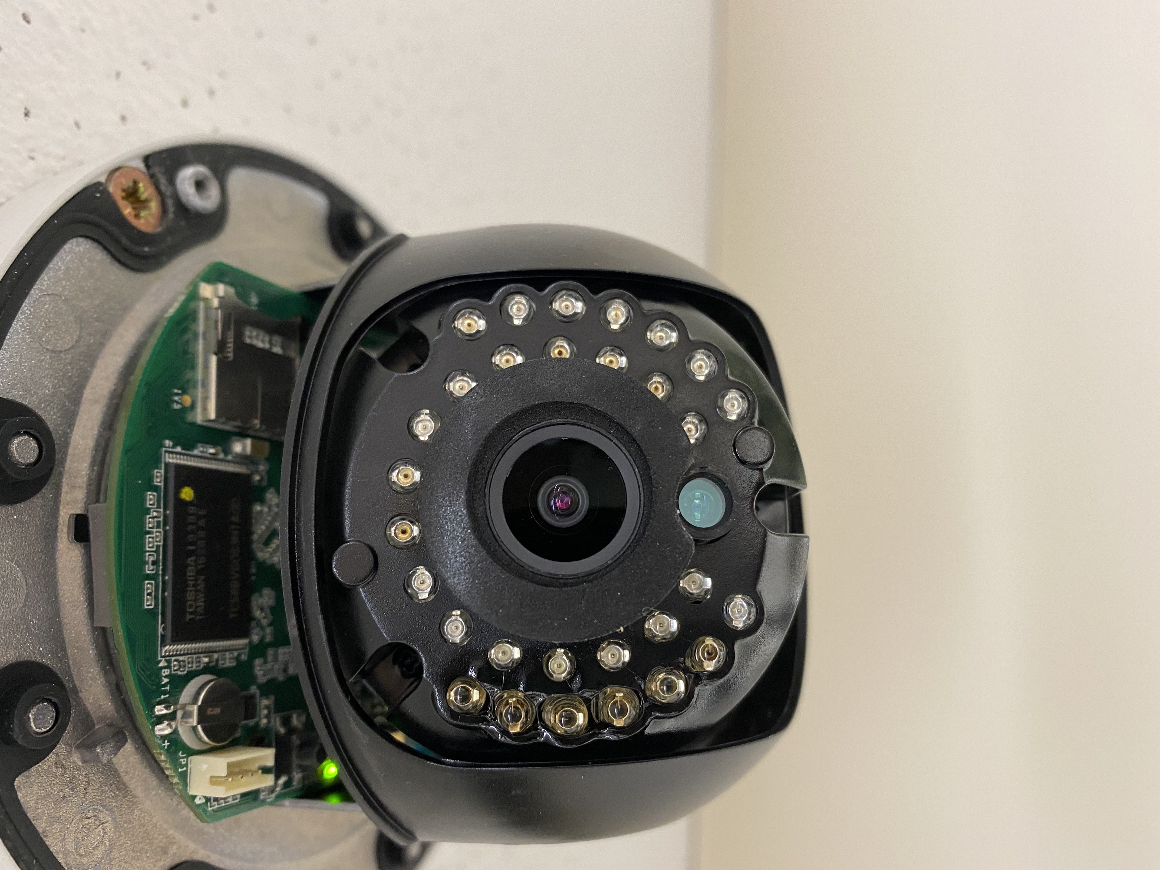

Ok, so I am 100% certain I have the issue with the cameras.
Let me explain that ALL 3 cameras have exactly the same issue ( see pictures), not good really.
Cameras are just over 3 years old, surely this is never right for them ALL to have the same issue in exactly the same area.
I may be incorrect, but looking at the lens of the camera in the picture ...................... it looks like a water bubble inside the lens??
Is there evidence of moisture inside the Cameras??
Hi @bud
It is rare that multiple cameras will display the same fault at the same time, but older Hikvision camera models like the ones you have didn't use the best IR LEDs and also they relied on lots of low powered LEDs which meant more wiring and more potential for faults to appear.
If they are just over 3-years old they will likely be out of warranty, but if you can it may still be worth talking to the company you originally purchased from as they may be able to confirm that they are actually just inside warranty. If they are out of warranty your only option is going to be to purchase new replacement models.
