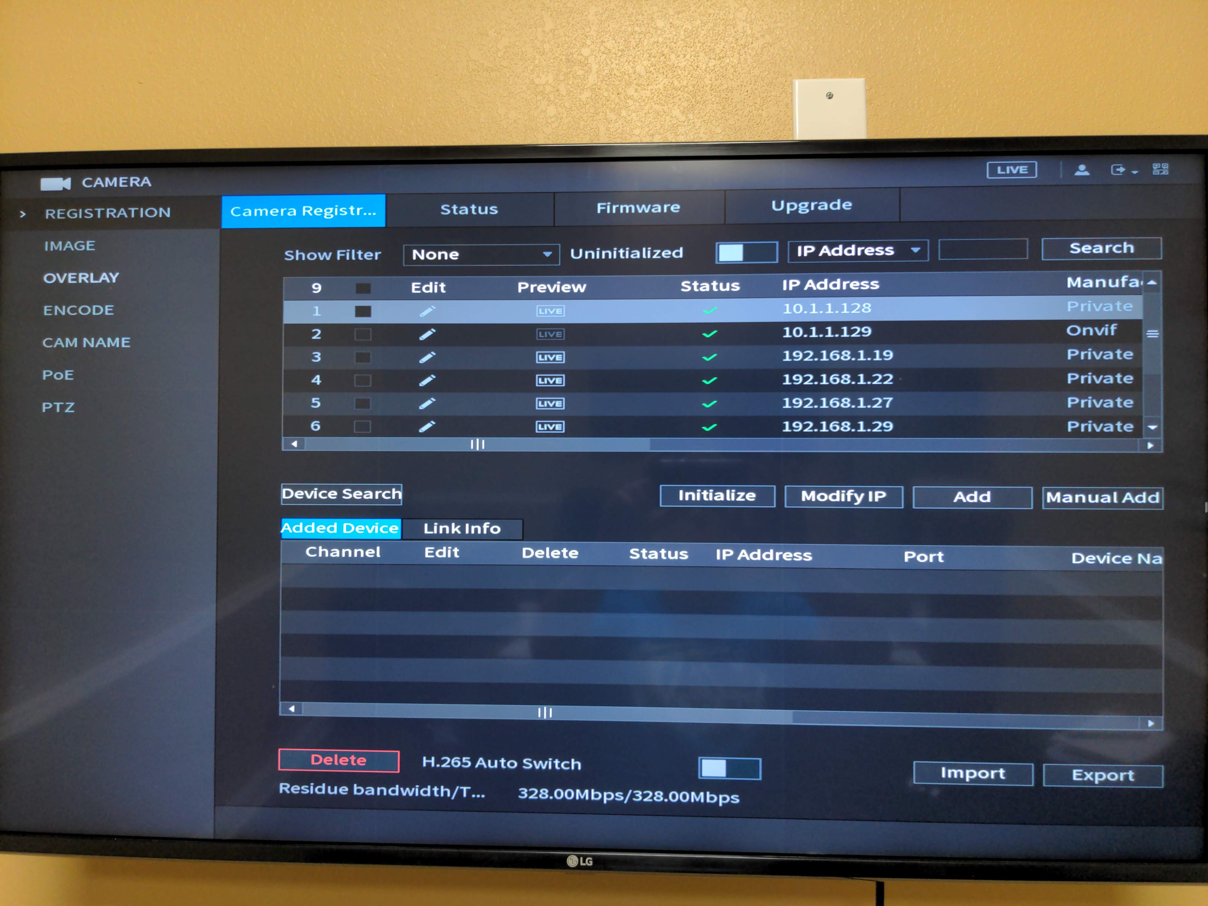

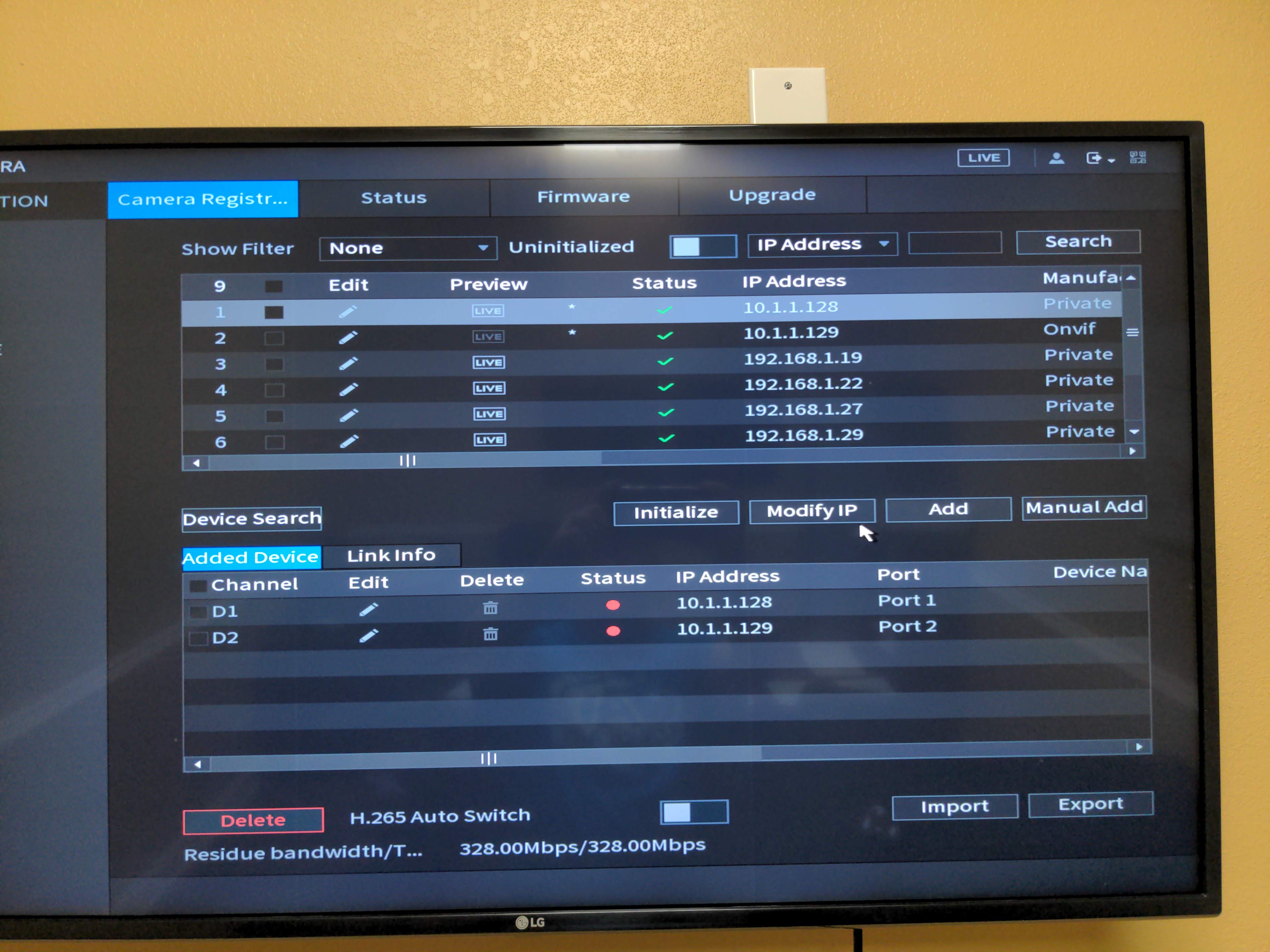

This camera always shows up on the NVR as 10.1.1.128 which is a different subnet than our LAN, 192.168.1.xxx. Also, there is another device that is always listed below it with the same subnet, 10.1.1.129. The interesting thing about this 2nd device (10.1.1.129) is the MAC is blank, MANUFACTURER is Onvif, all other cameras are Private, PORT is 80, all the other cameras are 37777, DEVICE NAME is NC324-XD, all the other names are listed as IP CAMERA. Searching the internet for NC324-XD, it looks like it also could be this no-name camera.
So, once again I'm confused. Is this no-name camera a knockoff HikVision or a NC324-XD by Winic Technologies USA, Inc.?
And which of the two 10.1.1.128 & 10.1.1.129 IPs is this camera actually connected to?
The 10.1.1.129 is using port 80, so wouldn't that mean it's likely a server or host like device, though the Device Name says NC324-XD, which the internet shows is a camera.
The 10.1.1.128 is using port 37777 and it's Device Name is IP CAMERA, so this also could be this camera.
We haven't found any other cameras, so I can't understand what this other device is exactly.
I thought it could be the NVR itself, but then why would its Device Name be NC324-XD?

So, does this mean it must be the device linked to 10.1.1.129? If so, I still don't understand why it has no MAC address, is using port 80, and the manufacturer is Onvif. And why does all the other Device Names list as IP CAMERA while this device list as NC324-XD?

Do you have any idea which of the two 10.1.1.128 or 10.1.1.129 IPs this "HikVision/Winic Camera" is likely assigned to?
I'm thinking the .129 since the Device Name is NC324-XD, which is the same as this camera type, but I do not understand why it has no MAC address and is using port 80. Is this something unique to ONVIF cameras?
