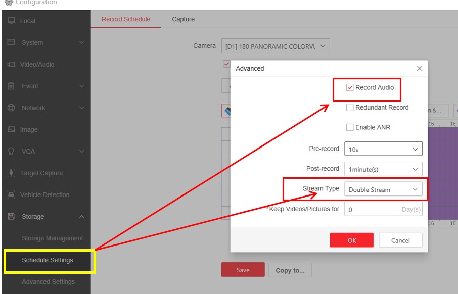

I selected to record both main and sub stream in my NVR (DS-7616NXI-I2/S) under Storage -> Schedule settings-> Advanced -> Stream type = "Double stream" to be able to watch the recordings even under bad connection when I am outside of my home. I am able to select the sub stream for playback in web interface and also in IVMS4200, however when I switch to playback on my android HikConnect app, the button "HD" is greyed and it only plays the main stream recording.

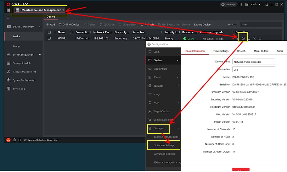

Recording "Double Stream" in iVMS4200, is in same place as Web GUI. See attached pics [1 - 2] .......... follow the arrows

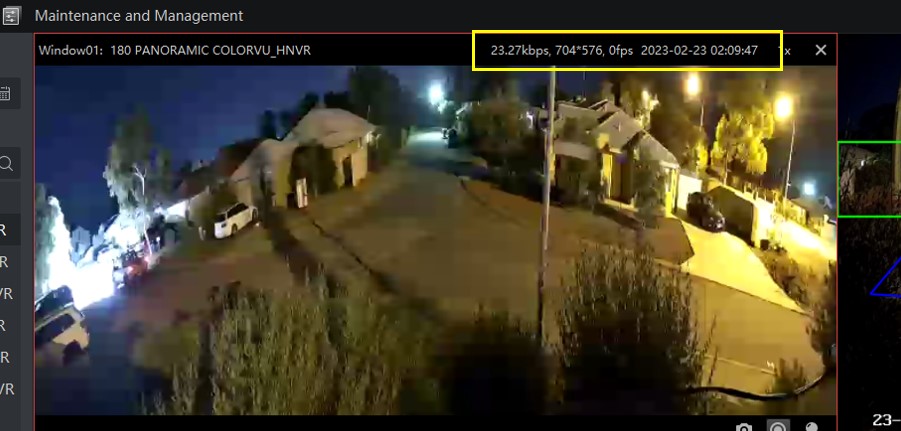

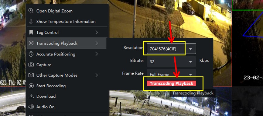

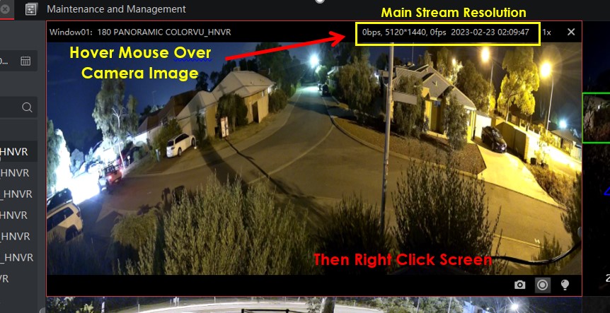

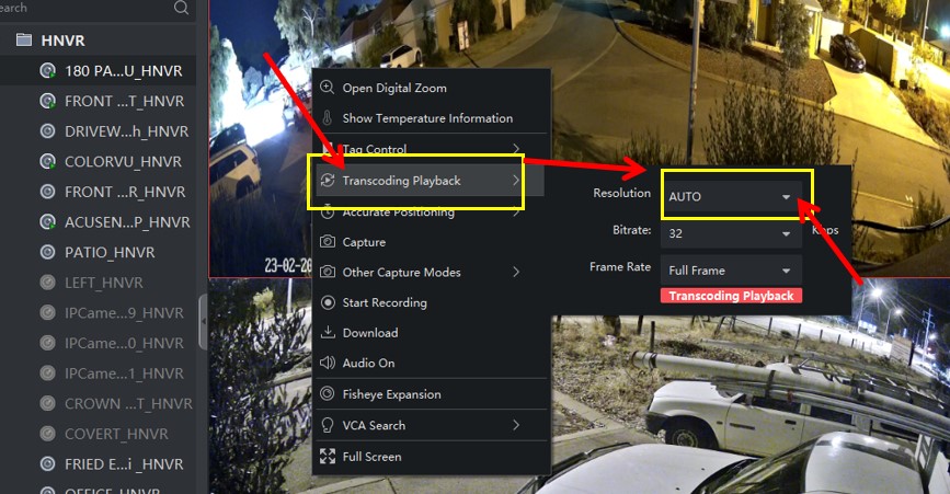

Anyway i found something, sort of like sub-stream playback in iVMS4200, but its not right, as my sub-stream Resolutions are always set to VGA
in the pics, I have 4x Cameras playing back, all are displaying Main Stream ............... follow arrows again, i'm going to bed

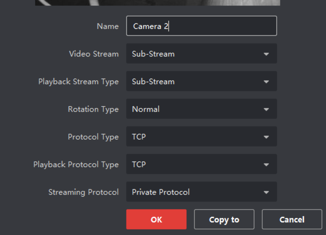

I think that setting must be just for NVRs that support transcoding. That option doesn't appear on right click menu during playback on the NVR. The only way I've found to play the sub stream is to set it to play the sub stream by default. I did that in:
Maintenance and Management > Device Management > Group. Select the site > Edit (icon) > In the window shown below you can change the stream for playback.
I could also have selected UDP which might help with the poor connection (except I only opened TCP ports in the router while on site)
It's a pain to have to set it that way. I can't imagine why it can't be switched directly by clicking a 'more' icon to the right of the camera name as you do in live view.
