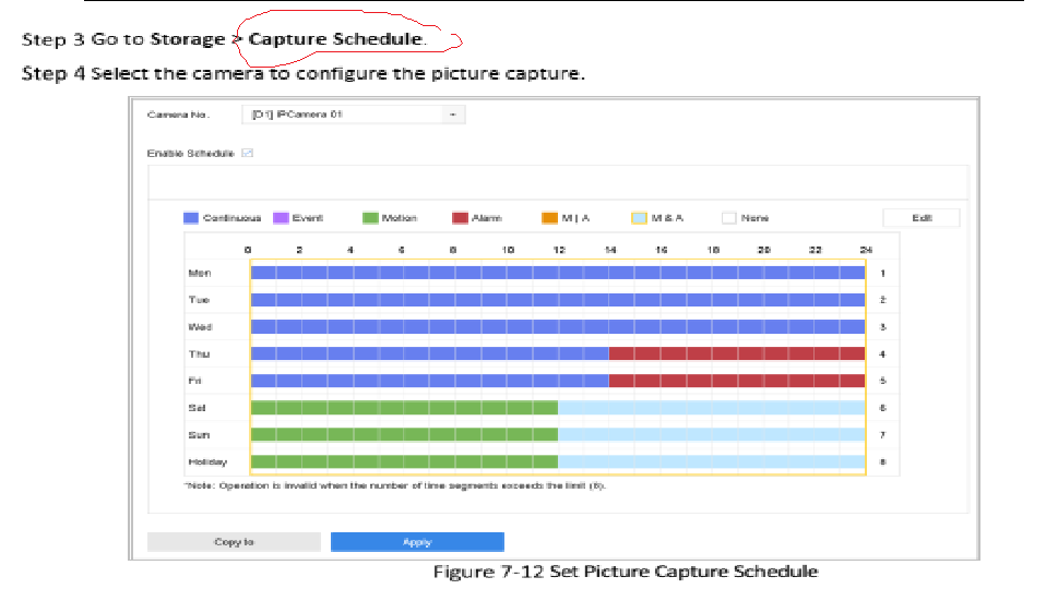

according to NVR(128ch User manual) there is a capture schedule for taking picture for time lapse or events like face detection

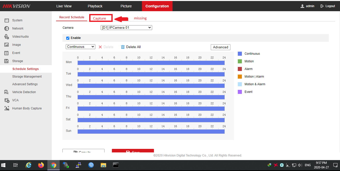

but as you could see below there is no menu for this configuration

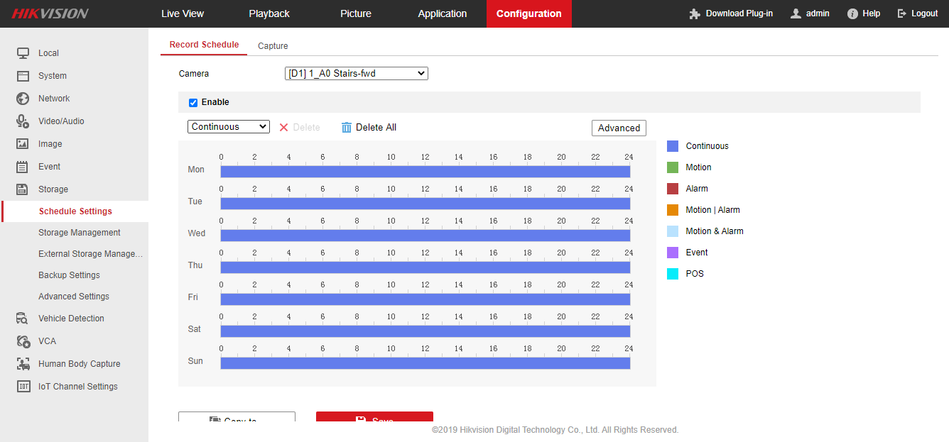

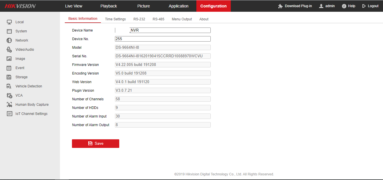

but in my 64ch NVR there is tab for configuring this feature!
how this is possible?

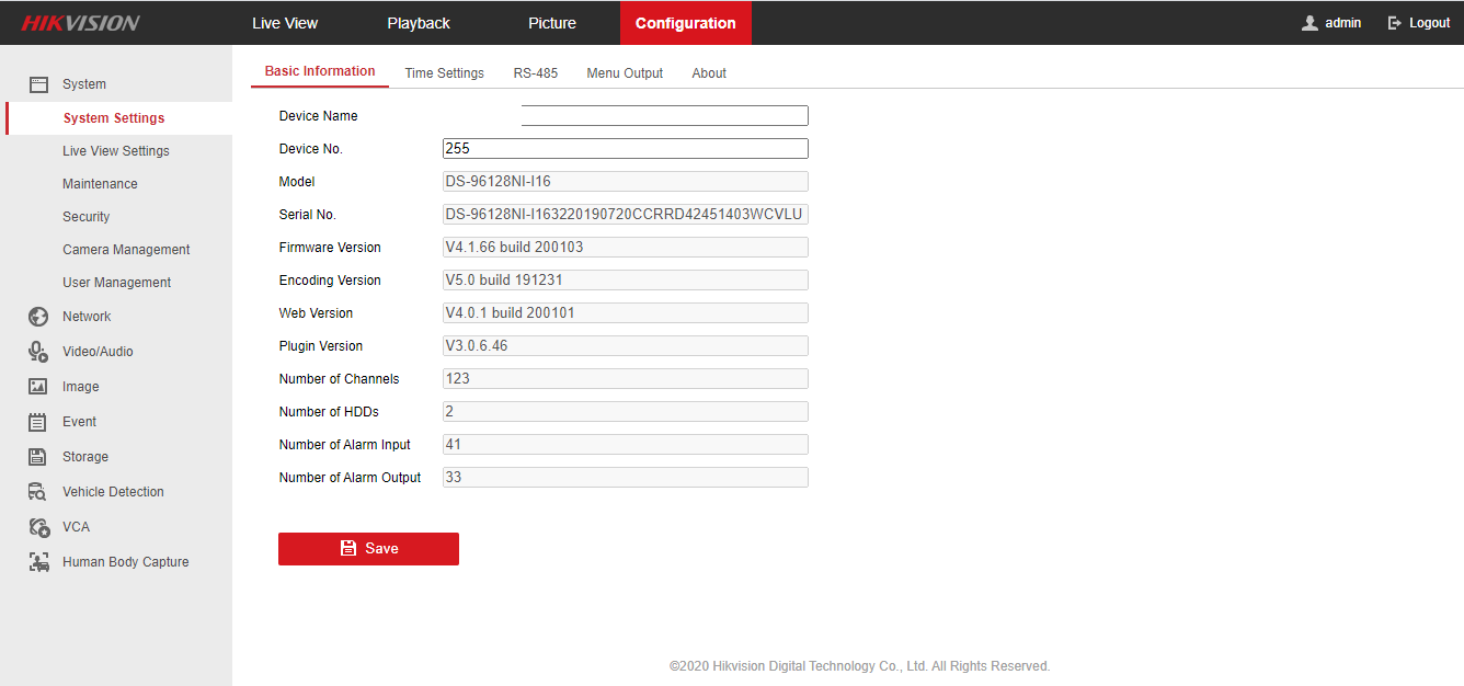

btw both nvr are in the last fw see pic below (i test fw version 4.1.64, 65 and 66 verison on 128ch nvr but all same! capture tab is missing)
btw: i check local menu of NVR via HDMI still missing !

hi thanks for your reply,
yes i did all even i check local GUI menu through hdmi there is no option!
base firmware was 4.1.64 i test all three 4.1.64/4.1.65/4.1.66 but still missing!

Super I series NVR don’t support capture schedule. Sorry for the inconvenience.
but in its user manual page 76 it explain how using these picture! that the darkest part of this company [Hikvision] personally this is second time i mislead by their technical document and waste my budget on wrong product, last year i bought a ANPR camera (2CD4A26FWD-LZ/P) based on its data sheet which was cleary said that support My region but when received we realize it's not, 3 month contacting their support and they just pass me to another guy and another guy.
