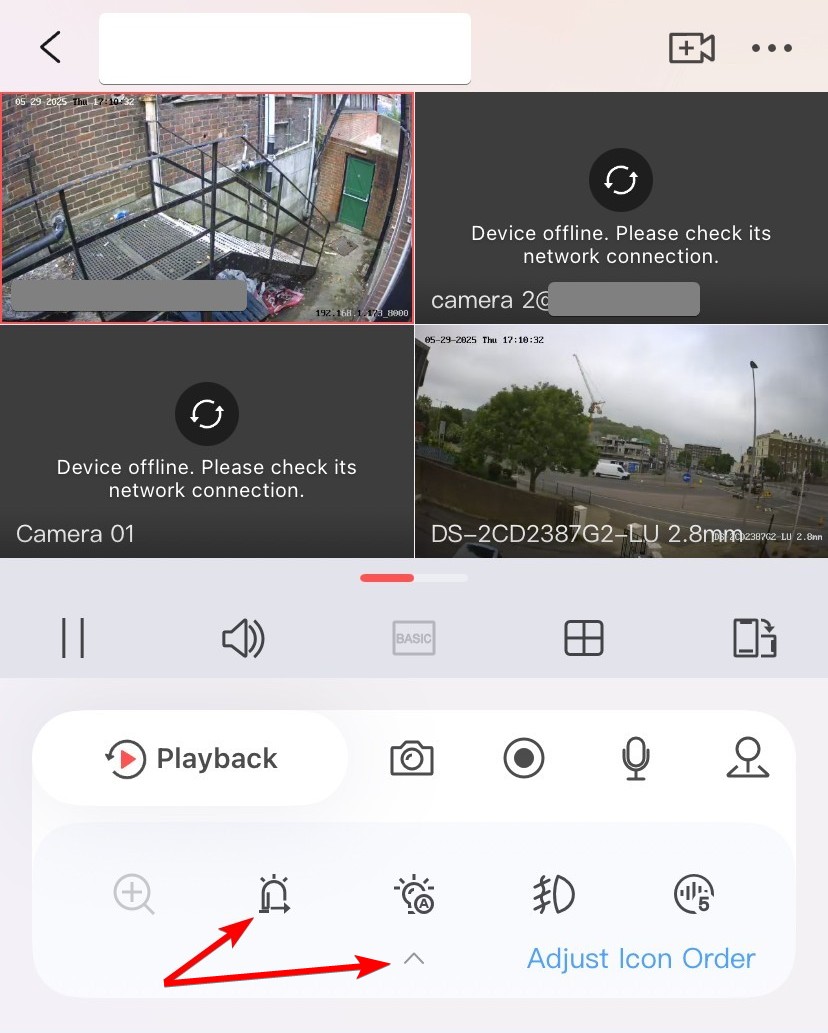

Hi there!
Does anyone here know how i can access my NVR´s alarm Outputs in Hikconnect ?
i have an DS-7732NI-M4 NVR and cant seem to find any outputs from Hikconnect ... i want to be able to trigger an output to open a gate using my NVR and Hikconnect.
am i missing something ? :)
Regards
Hi @ProSecLa - you'll need to open your NVR by pressing on its name or the small play button on the home page. Then, if you press the small arrow to show all of the icons, the option to trigger the alarm output should be there:
