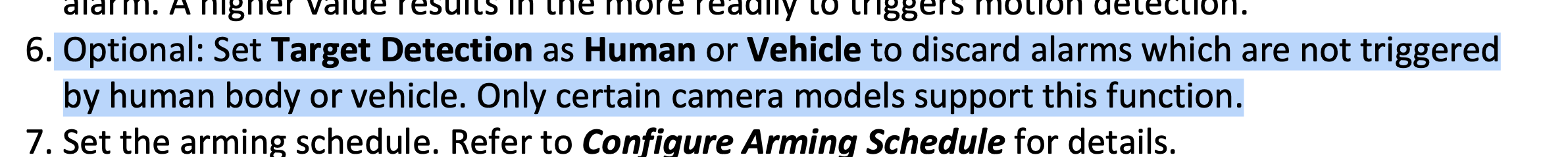

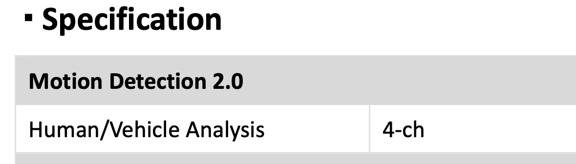

I see following quotes (see screen shots) from "DS-7608NI-K1" user guide and specification. It sounds like supporting AcuSense camera on at least 4 channels but I am not sure. Any idea? Or should we go with "NXI" or "I2" series? An 8-ch varian is available?
