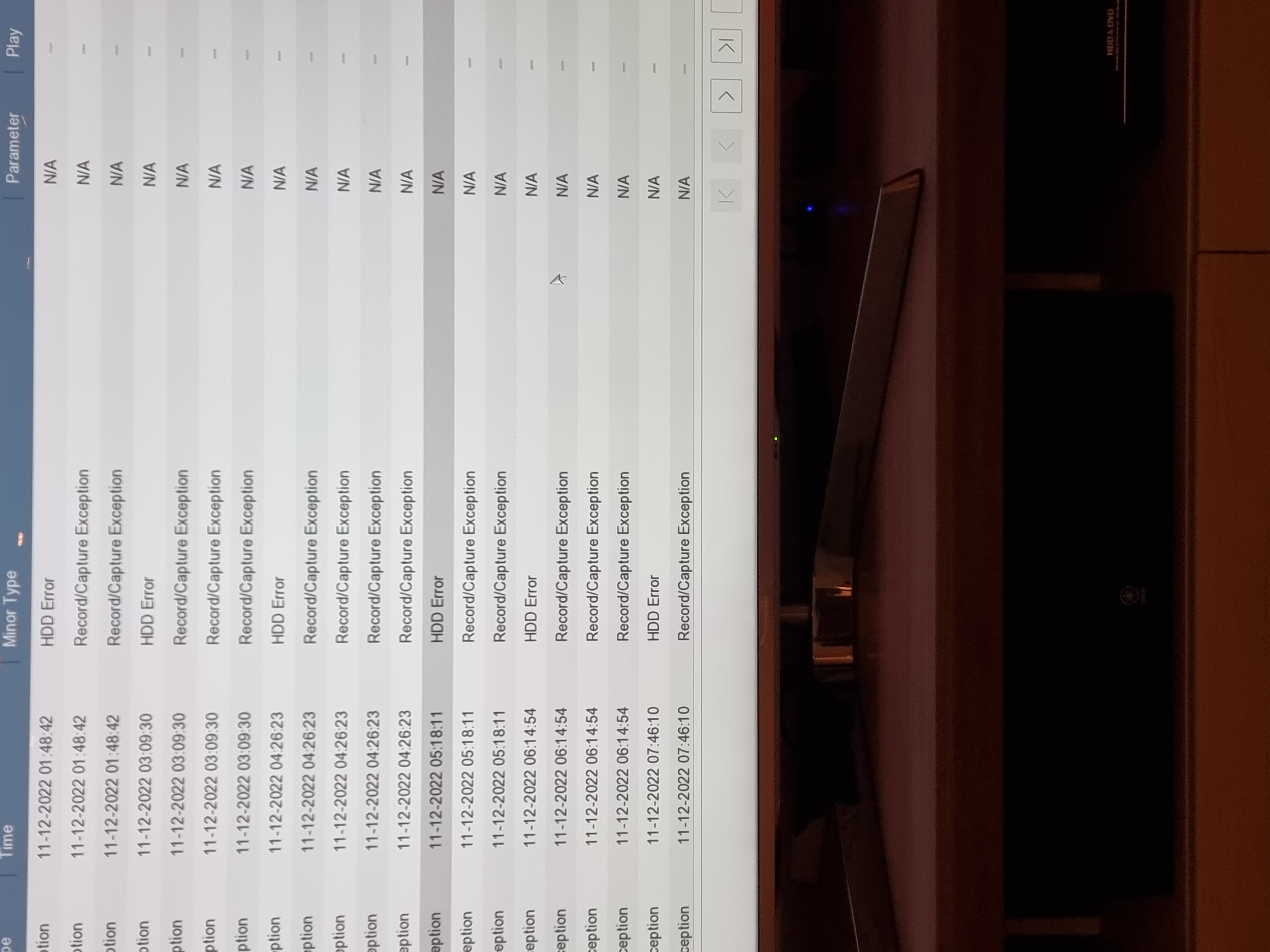

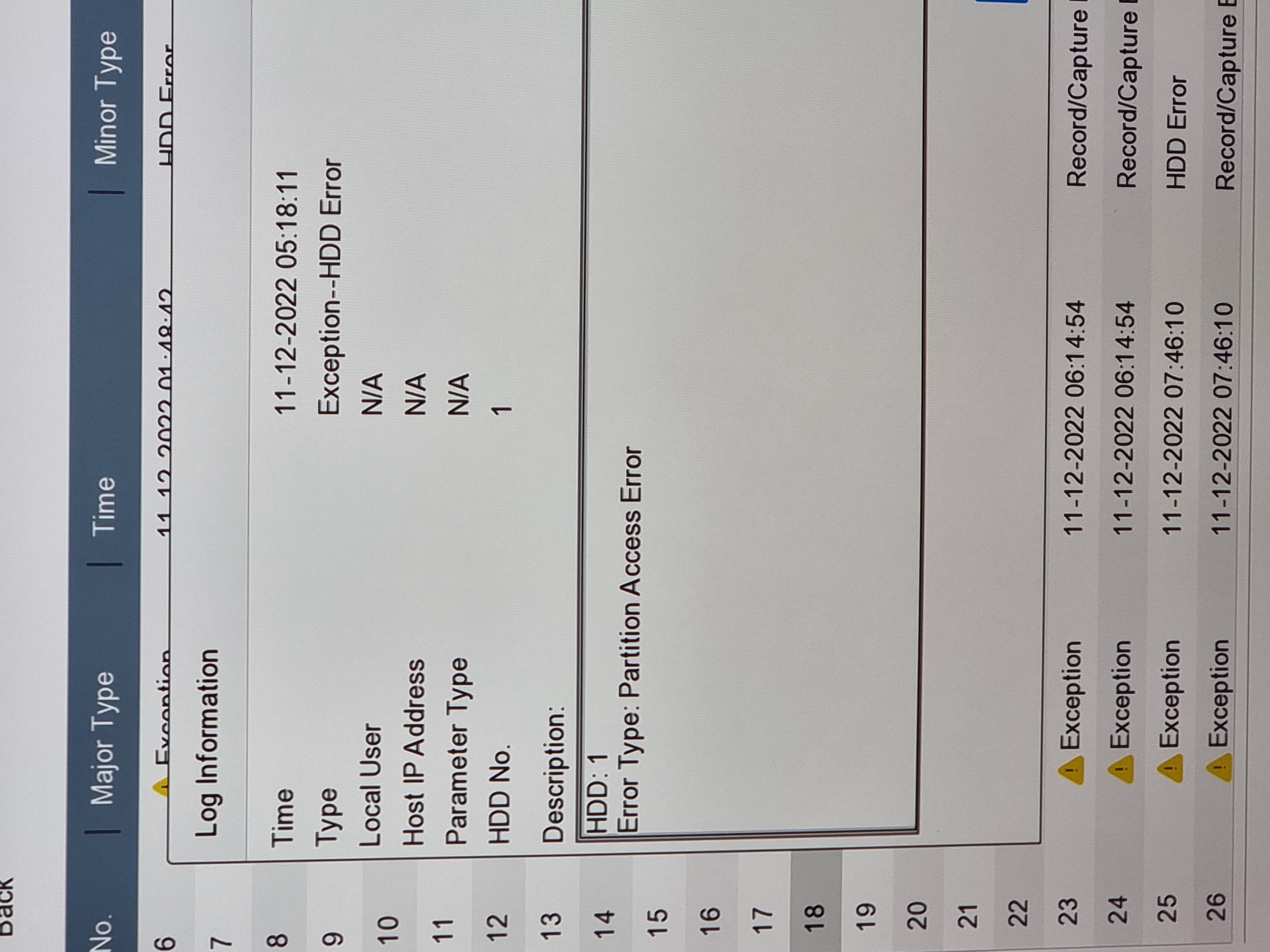

Here are two screenshots.
Seems like the recorder could only write 730 GB to the 18TB drive and then runs into this partition error.
After the error occurred recording stops. The recording could not startet again. Repairing the database did't fix the problem.
