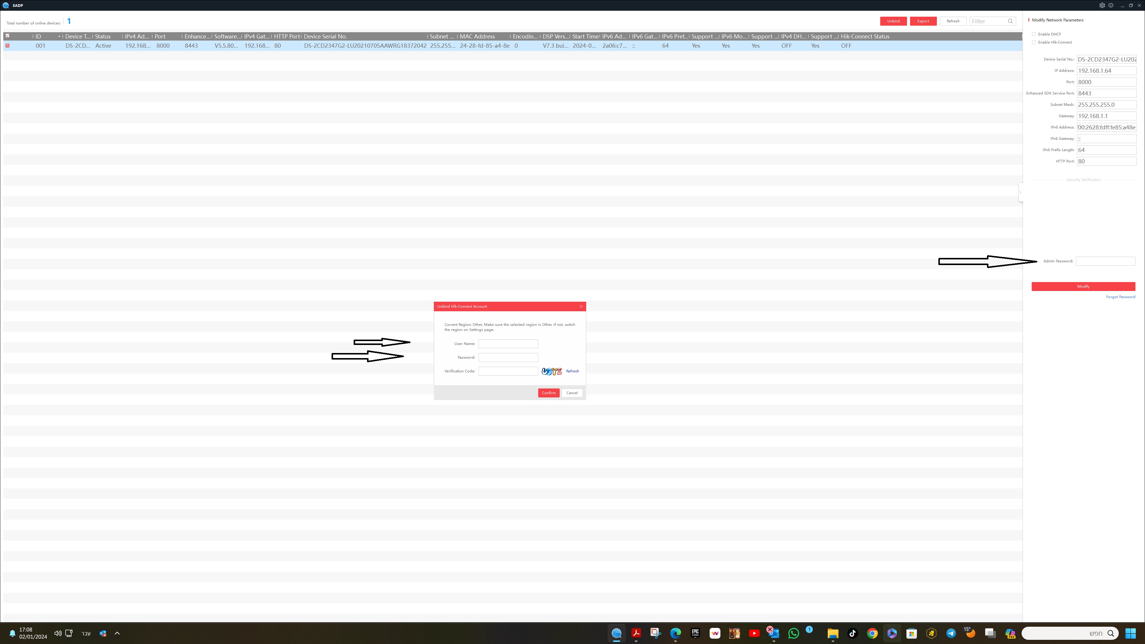

HIKVISION network camera I received a used network camera and when I want to configure the network in the "SADP" software and confirm the parameters it asks for the password! What is the password for the camera? of the router at home? Or of a PROVISION type DVR that I have? Thanks

What are the passwords it asks for? I reset the camera I connect the camera directly to the network card of the computer and give the computer IP 192.168.1.63 and gateway 192.168.1.64. Do I need to change the gateway to the IP of the camera to that of the computer, I would like you to sort it out for me, Thanks again, although I control the network taps, but today I am almost 72 years old and sick, and connecting the camera is very important to me in order not to get out of bed Sorry for my English Thanks again
The model is a DS-2CD2347G2-LU (G3 platform ColorVu 4 megapixel turret)
If you have reset the camera the 'admin' password is the password that you created when it asked for an activation password. The username and password it's asking for in the other box are the Hik-Connect username (usually an e mail) and password for the user that added it to their Hik-Connect account. No-one on the forum can give you these details. The password is something you created and I guess the Hik-Connect user details are those of the previous owner.
