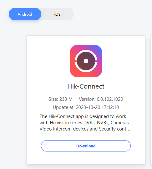

In response to some ongoing queries regarding the Hik-Connect App V6, Hikvision Tech Support have asked us this morning to check whether users are still seeing problems after updating to V6.0.102, which was released a few days ago ...
Yes!! still have the same issue, sometimes i'll get a connection with maybe one or two camera after trying 3-4 attempts and the others are offline or sometime doesn't even get a connection. This problem only occurred after updated to version 6
