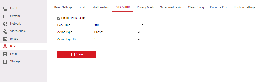

I have a DS-2DE4425IW-DE PTZ which doesn't offer smart tracking.
I have another camera and when this camera detects intrusion i'd like the PTZ to move position to get additional coverage from a different angle, and have got this to work via PTZ linking. What I can't figure out though is how I get the PTZ to move back to its original position after a specified period of time because if it stays in the position it was moved to via the linkage it is then not covering an entrance.
Any assistance on how to achieve this would be appreciated as i've not been able to crack it.
Thanks,
Tim
Solution
When accessing the camera through the browser, under PTZ you should find 'Park Action' - set a time in seconds that you want it to return to a preset position - in my case Preset 1.
