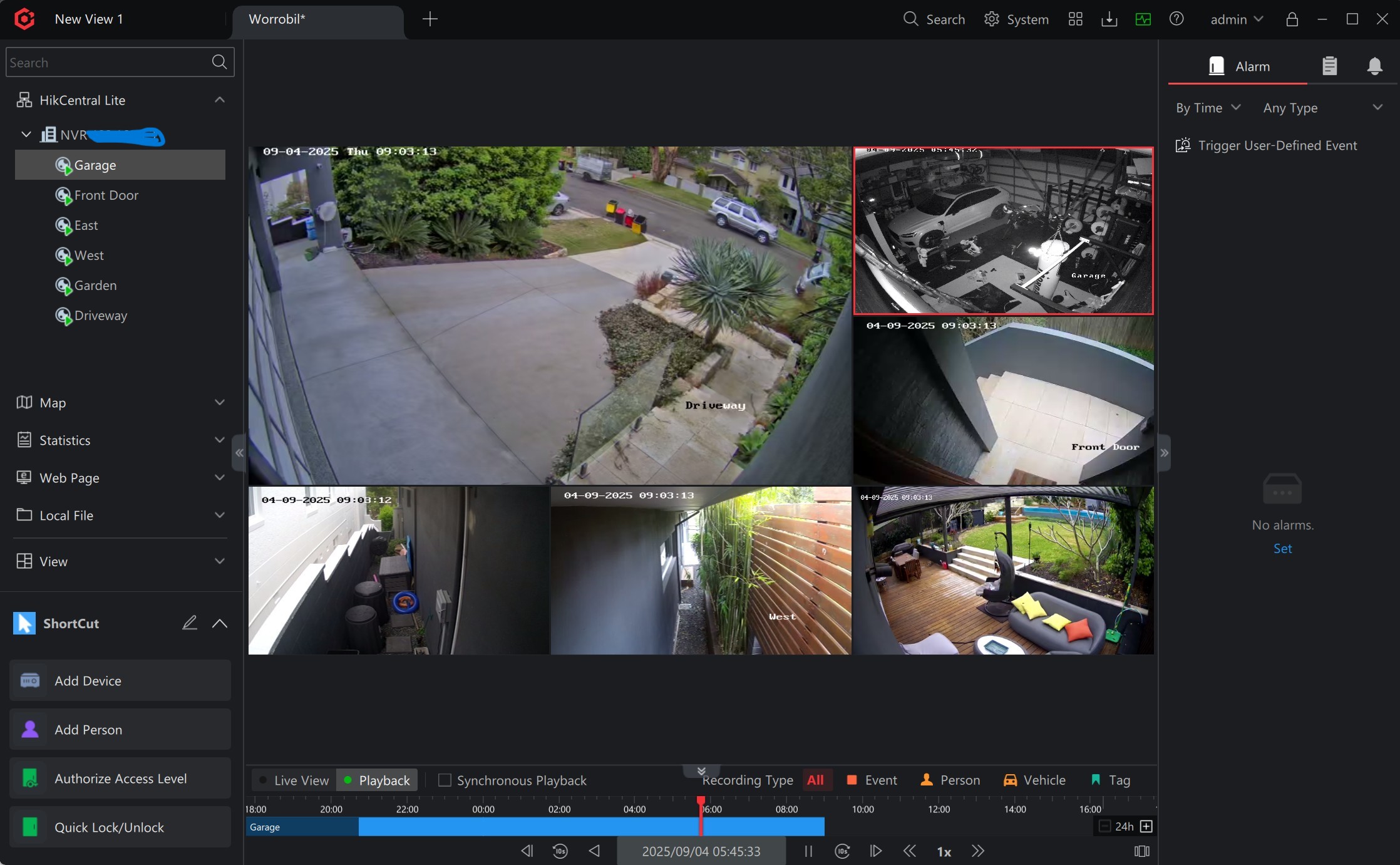

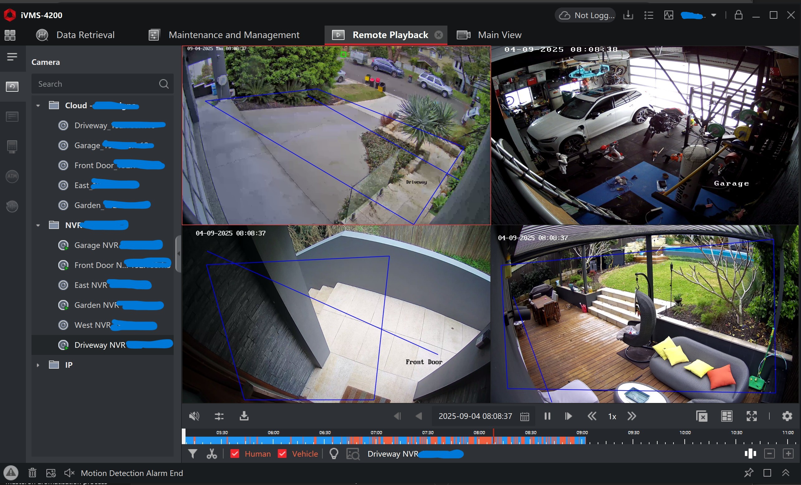

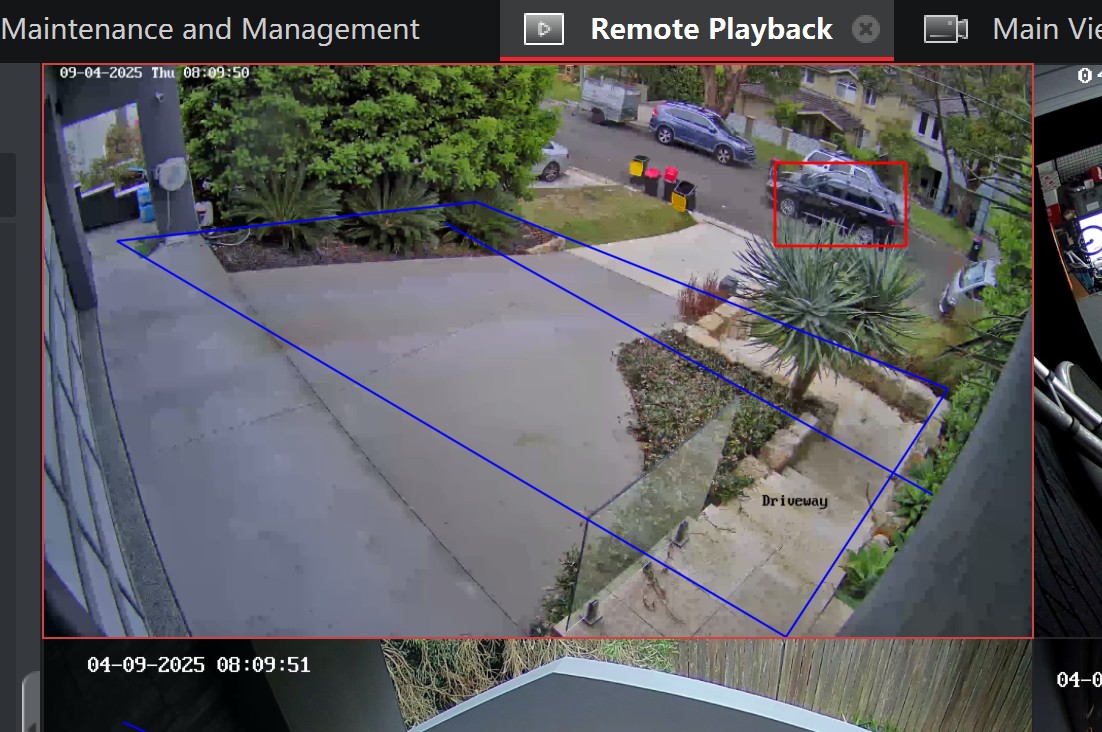

I've realised a big downgrade to HikCentral Lite, it does not show vehicle and person events in the timeline and can't search for them in the timeline either. It also doesn't show the overlays for detection and camera detection area settings. From what I've read these are now upgrades.
I'm still looking into this. As you say, the timeline markers and human / vehicle / event search filter doesn't seem to be working as you'd expect...
I read somewhere online that this is only enabled on the paid version, can't find where I read it now.
Thanks- you might be right, I'll let you know what I find out...
On that note, I've also had clarification that AcuSearch is only included with the paid-for HikCentral-L-VSS-1Ch camera licences, meaning it isn't included with the free 16 channels that come with the software.

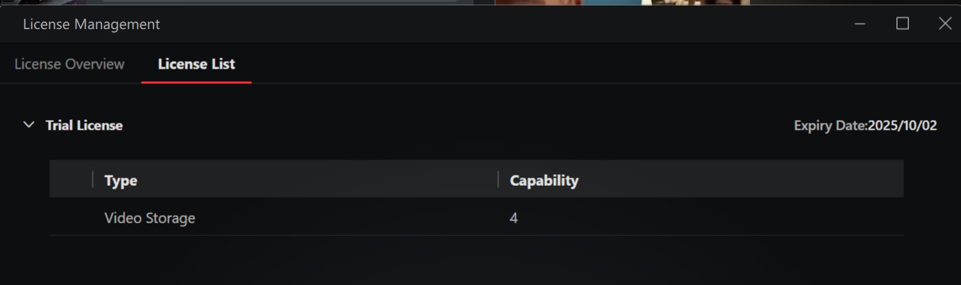

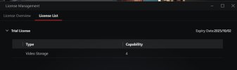

I've just noticed that I'm using a free trial of HikCentral Lite.
But it deosn't seem to have the features of the full version as shown on the hikvision site.
Also what is the iOS app I'm supposed to use to trial the cloud based recording from the cameras?
The HikCentral app requires a server and port to login, am I supposed to setup port forwarding to use the app? I thought the whole purpose of the app was that I woudln't be required to need to do that.
Is there anything else I'm supposed to setup?
