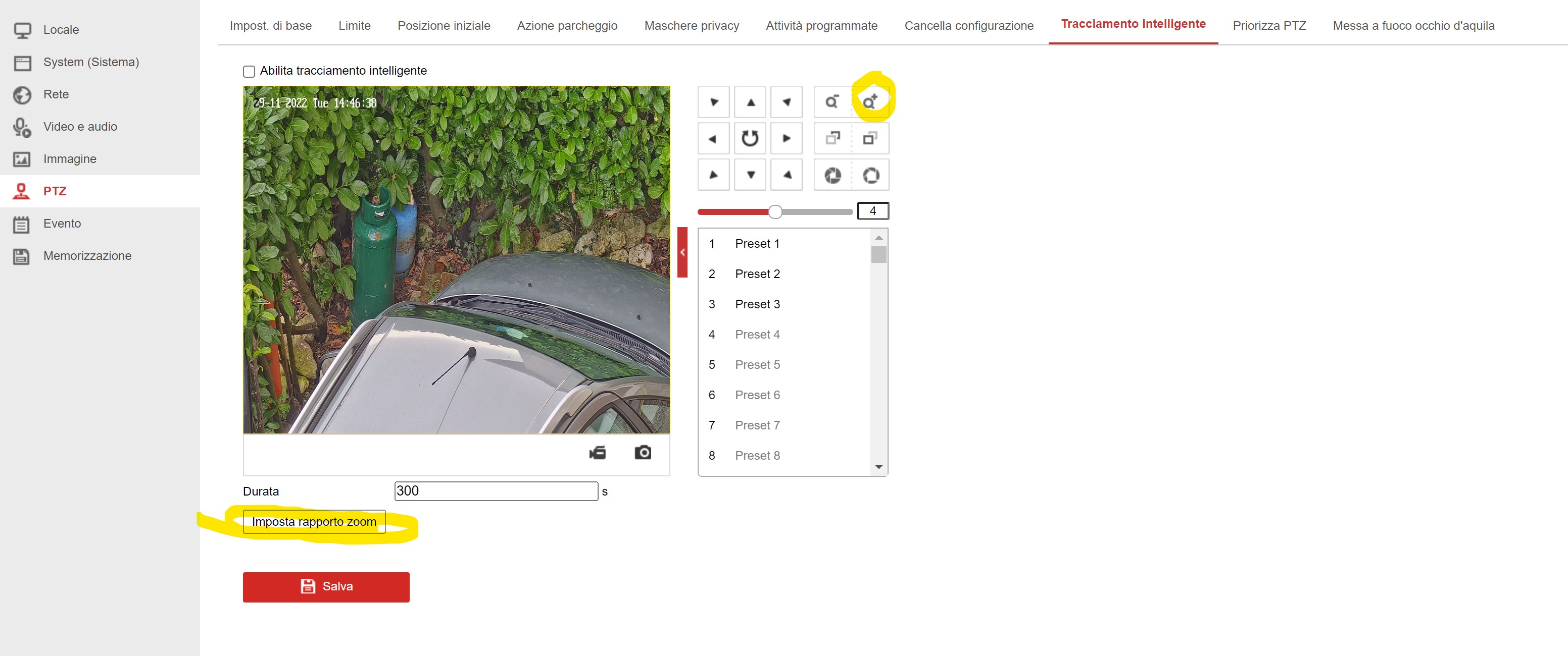

HI everyone, i'm trying to configure the zoom ratio in order to have auto zoom when my camera trigger a movement. I've left disabled smart tracking and i'm using smart event, where ive configured mine three differents region, and setup up my area range with min and max. After that when i go to ptz smart tracking i select the preset and set a zoom with + button then i push set zoom ratio. When i trigger a movement, the camera follow the object
but the zoom remain the same, or better it doest not use my zoom ratio.
Do u have any idea ?
i've attached an image about my smart traking setup page
Thanks in advice
Besta regards
Hi Oz001
Have you set the zoom ratio to the maximum, as explained here?
Hi Kyle thanks for your answer, yes i did it, ive followed also this video :
, but the camera track the person w/o zooming . Do u have any idea if could be any setup i miss or if this Videocamera has a FW bug, HW limitation or something alse ? Thanks Best regards

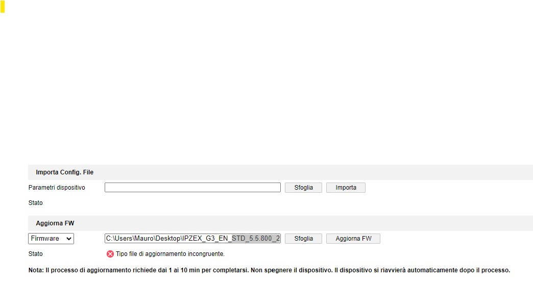

HI ive tried to use the FW , but when i launch the upgrade i got the error message ( file attached), it says : incongruent file
Thanks
Just to check, are you uploading the "digicap.dav" file, and not the ZIP folder that it's in?
Sorry, I can't tell from the screenshot.
Yes unzipped file "digicap.dav", just a question could be a problem because is a downgrade, is it supported ?
Thanks
Yes, I think V5.5.820 must be a version that you cannot downgrade from.
I wouldn't recommend the TFTP method - I'm not sure what impact it may have on the camera and it isn't worth the risk.
