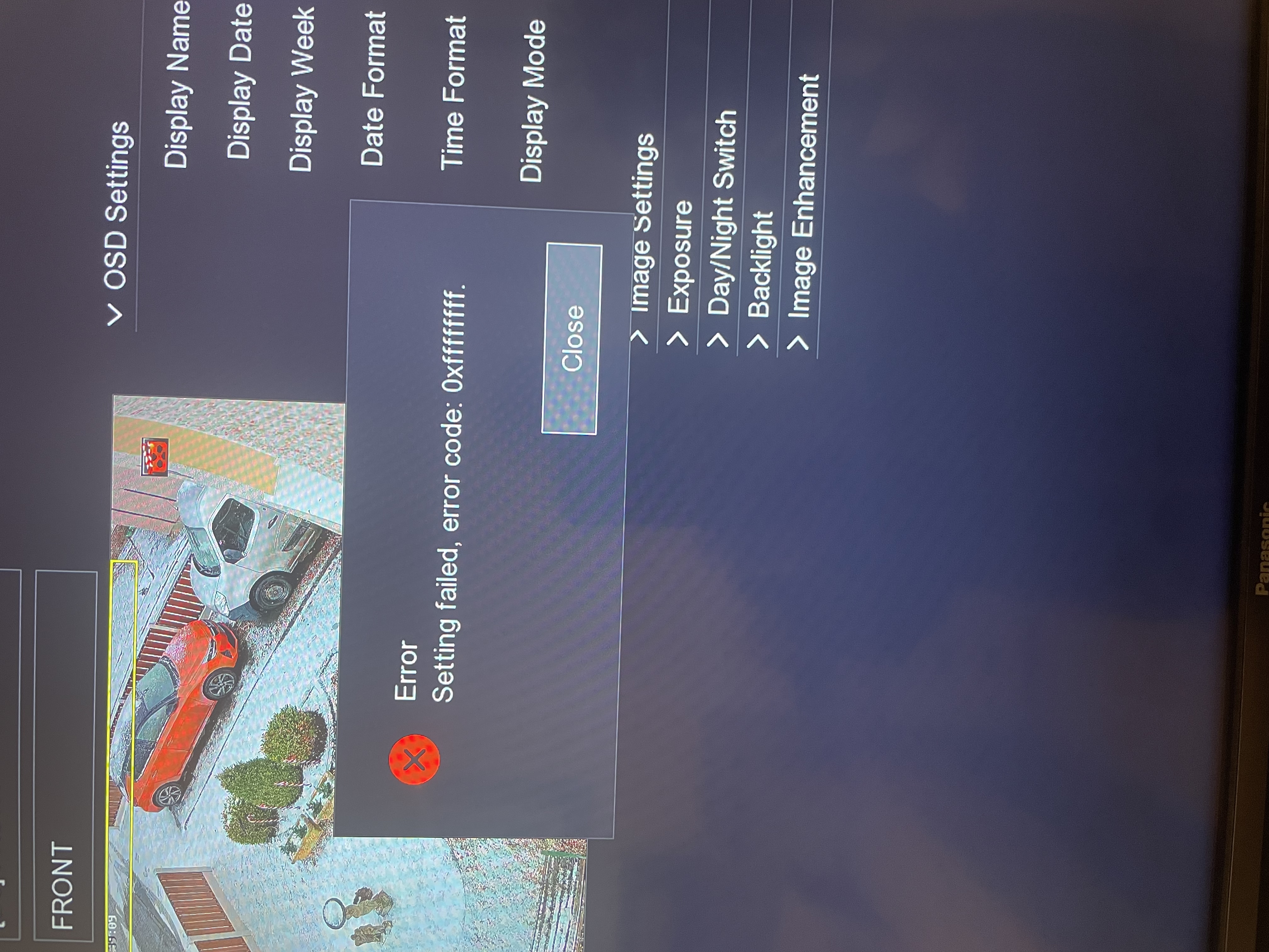

I am getting a setting failed error code on 2 of my camera 8mp after playing about trying to get the best settings.
One is a colourvue and one a dark fighter.
I now can’t alter any setting in display such as brightness or anything on that screen.
It’s a ds 7600 series nvr with latest firmware.
No issue with doing any other settings at all, only under ‘display’.
Cctv chap suggested I need to hard reset the cameras, any advice on another solution.
Error is ‘ setting failed error code oxfffffff

Thanks for adding the screenshot.
It's not an error code that I recognise.

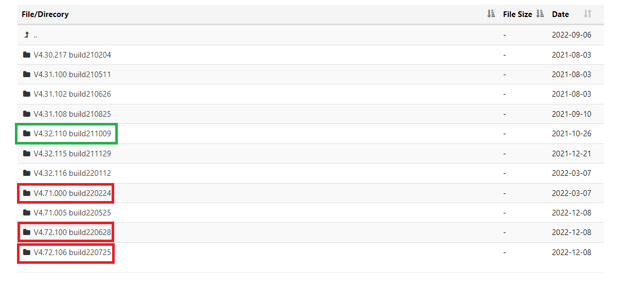

Below is the link to the Hikvisions UK download portal where you can find the firmware for your NVR, As you are quite a few versions out of date I would recommend upgrading in stages as jumping to the most recent firmware can cause issues. I have attached a photo showing which ones I would recommend upgrading to first before getting to the most up-to-date version.

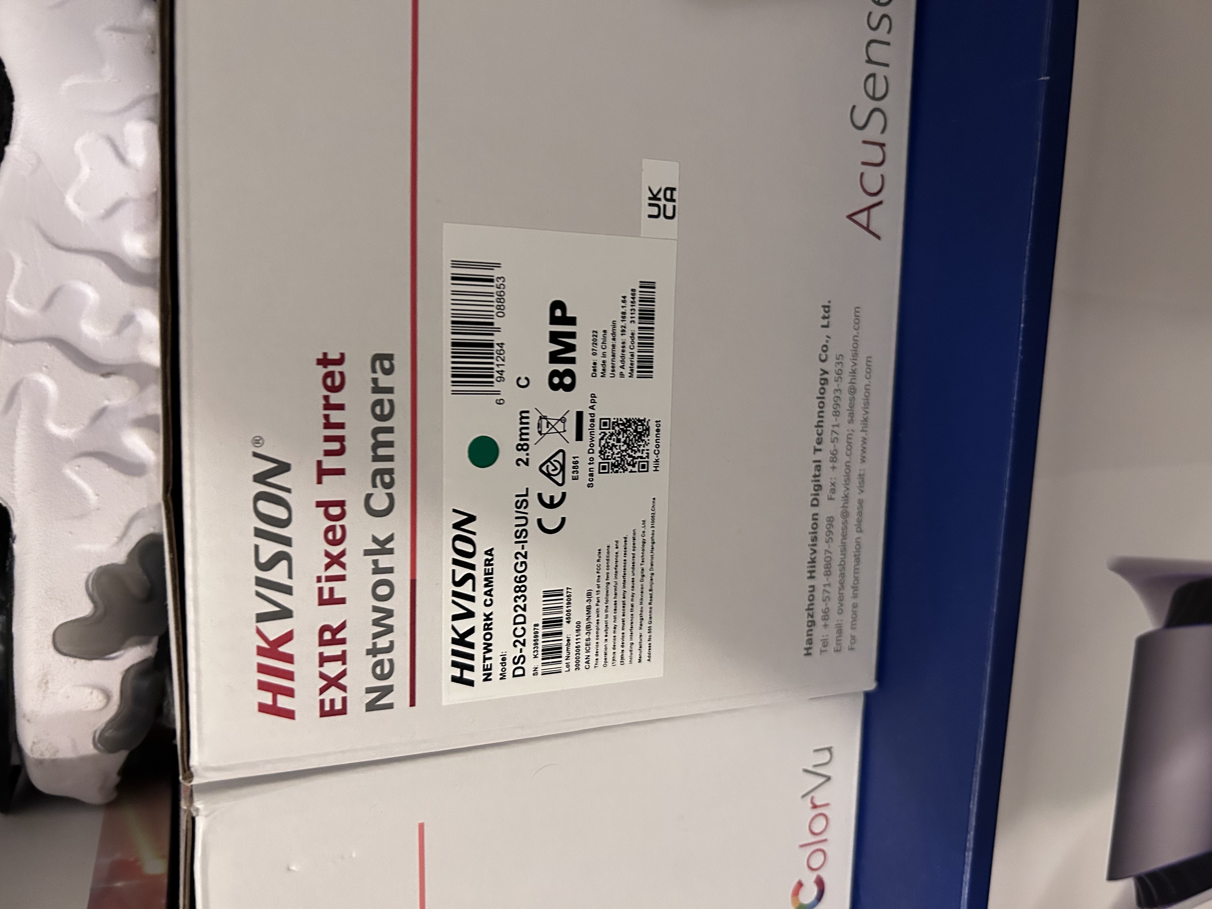

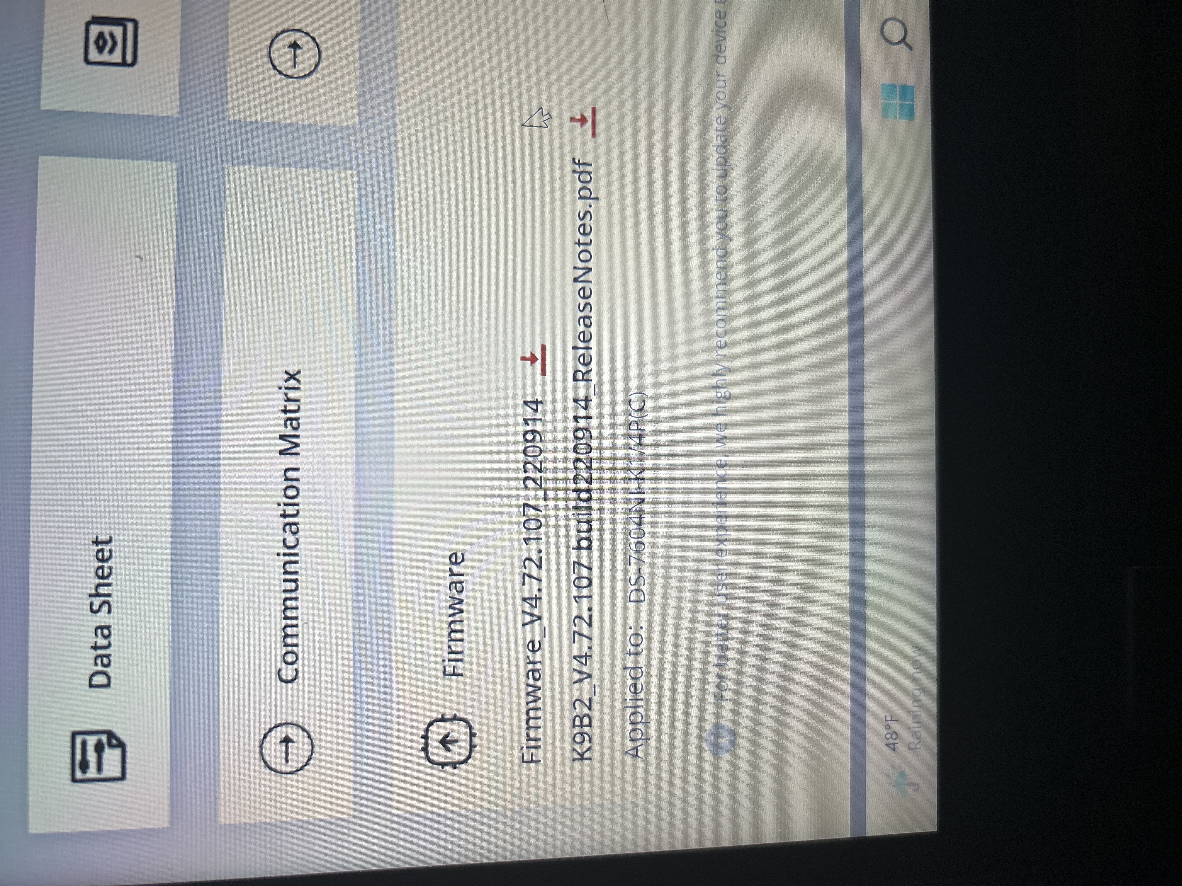

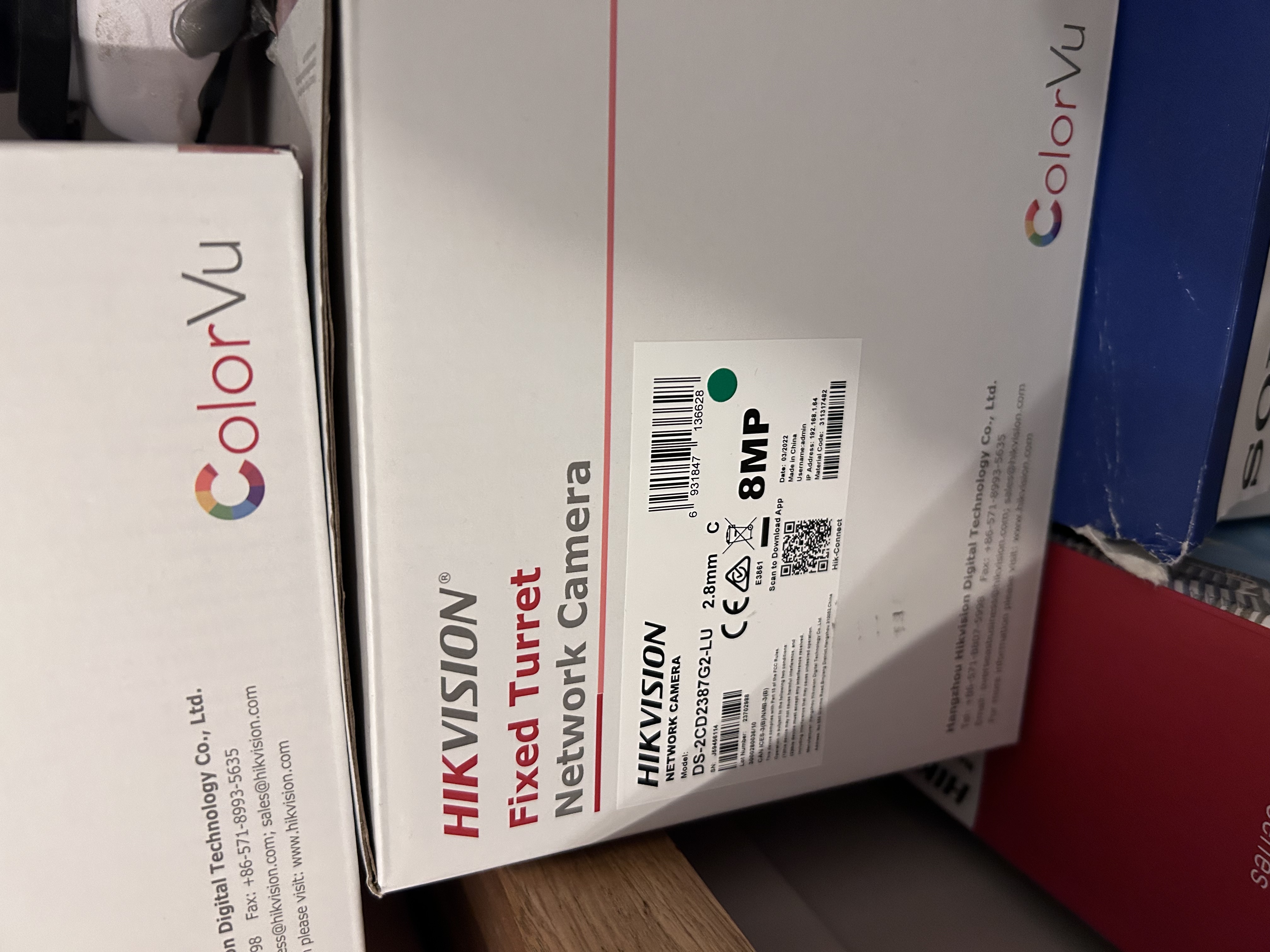

Thanks a million lads firmware upgrades went through fine.I have Event Perimter now and OTHER events which I don’t know what that is??…. I still have the display error code issue on those two cameras though .Do I perhaps need firmware upgrades for the camera themselves?.One is colorvue the other is a dark fighter .One of the colourvue a is fine.I’ve attached the two offenders, but suspect it could be a hard reset
