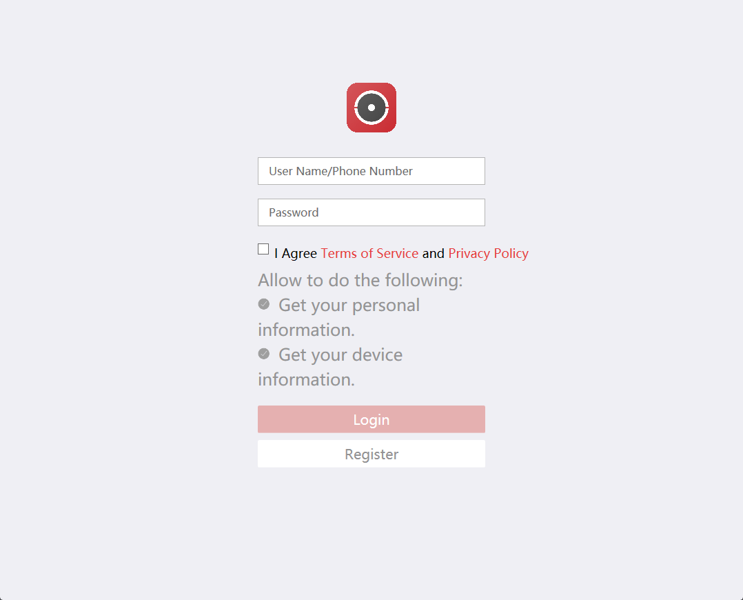

From a PC, you can use the iVMS-4200 software, click on the cloud button in the top-right corner, and then log in to your Hik-Connect account in the pop-up window:
Your cameras will then be available to view in the 'Main View' and 'Playback' pages of the software.
BTW, when you first download iVMS-4200, you'll be taken to a page where you create a new login, but this is a completely separate login for the software and you don't need to use the Hik-Connect account credentials here.
