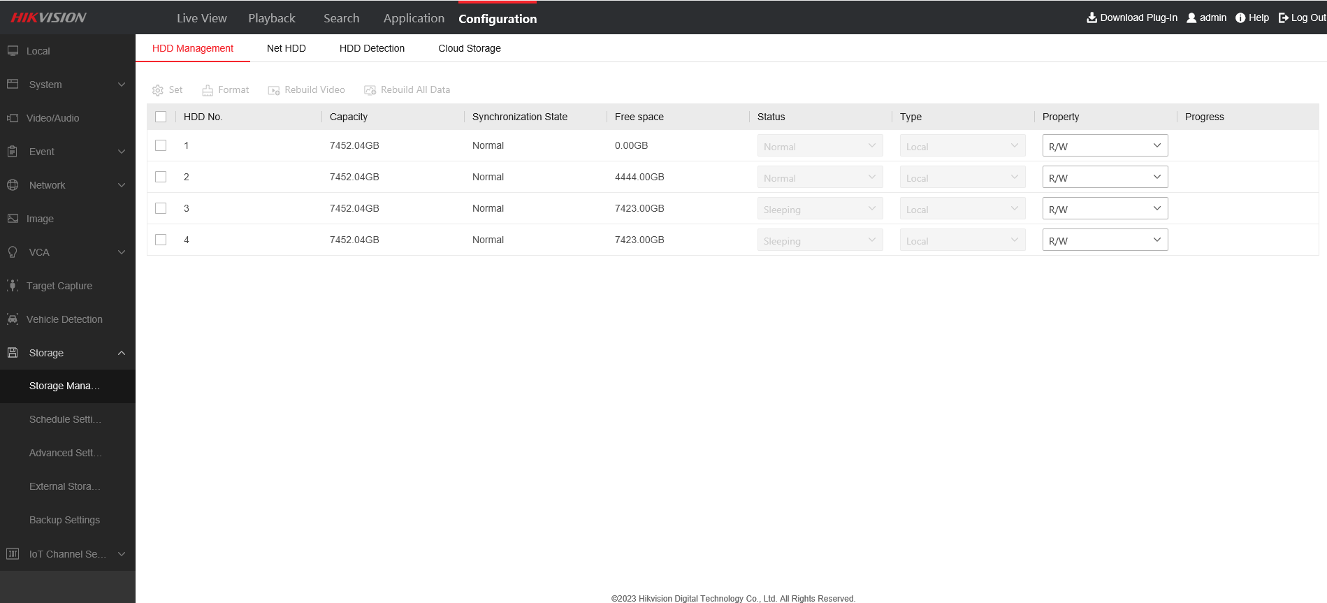

Hi, there are 4 x 8TB. It currently set as the attached image. It seems like its using first disk then next, etc.
Not sure where I change it to group recording?

So thats quota, which is hdd killer if there are alot of cameras. You can change it when you add nvr to ivms4200, press configuration icon and click at advanced when it pop. Then you can group cameras in 4 groups, and assign to each hdd one group. Plus if hdd dies, atleast not all the cameras missing
