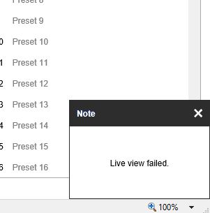

All I can do is login the web gui then I get "Live view failed".

I can access the web GUI but no live video. I've never been able to get it to work in this situaton using any of my HikVision cameras. Doesn't matter what ports I forward, even forwarding ALL of HTTPS, SERVER, RTSP ports - still Live Video Failed.

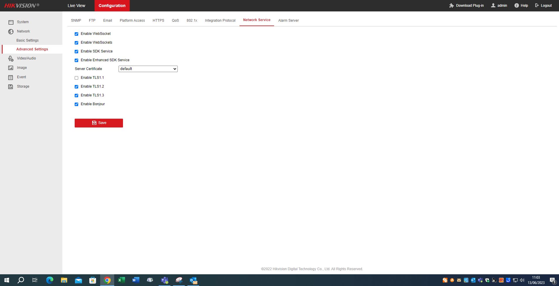

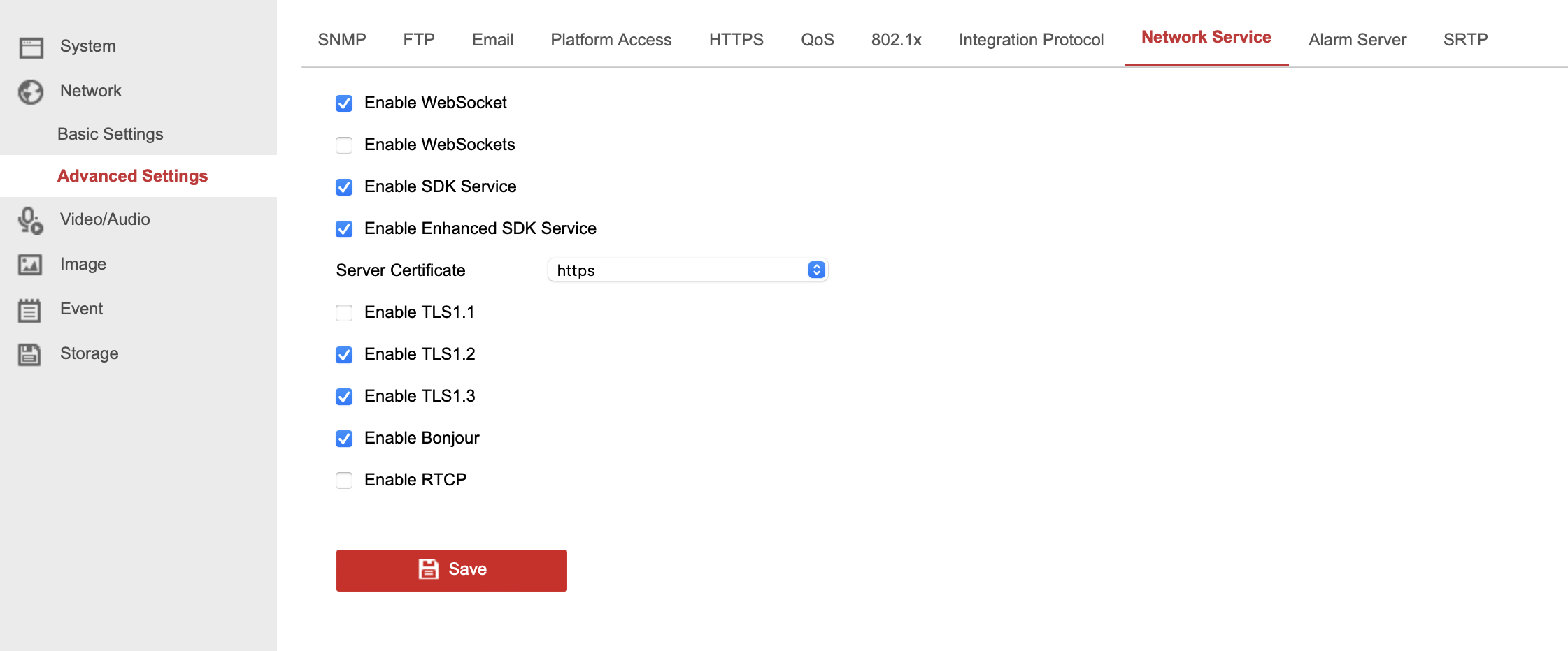

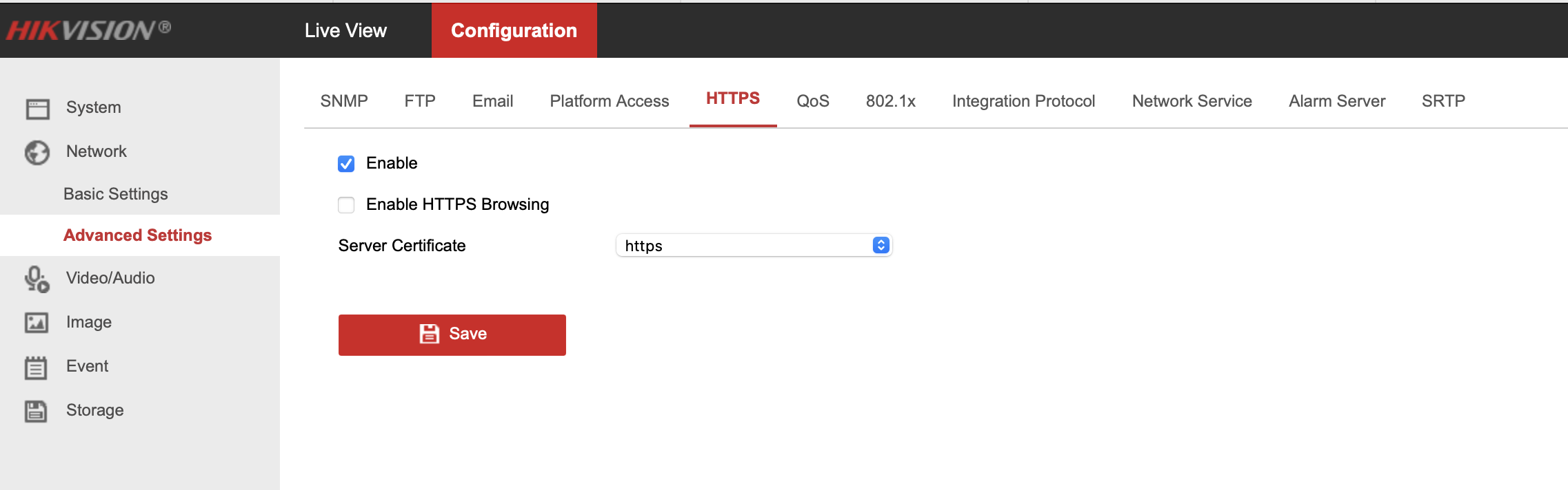

@George-H a couple of other things to check....
Have you enabled 'https browsing' in the cameras? By default https is enabled but https browsing is disabled as shown in the image below:
Could that be blocking the port forwarded live view...
Also for plugin free live view (where supported) you need to enable websockets which is also disabled by default as shown below:

Thanks JB - I'll give enabling Websockets a try.

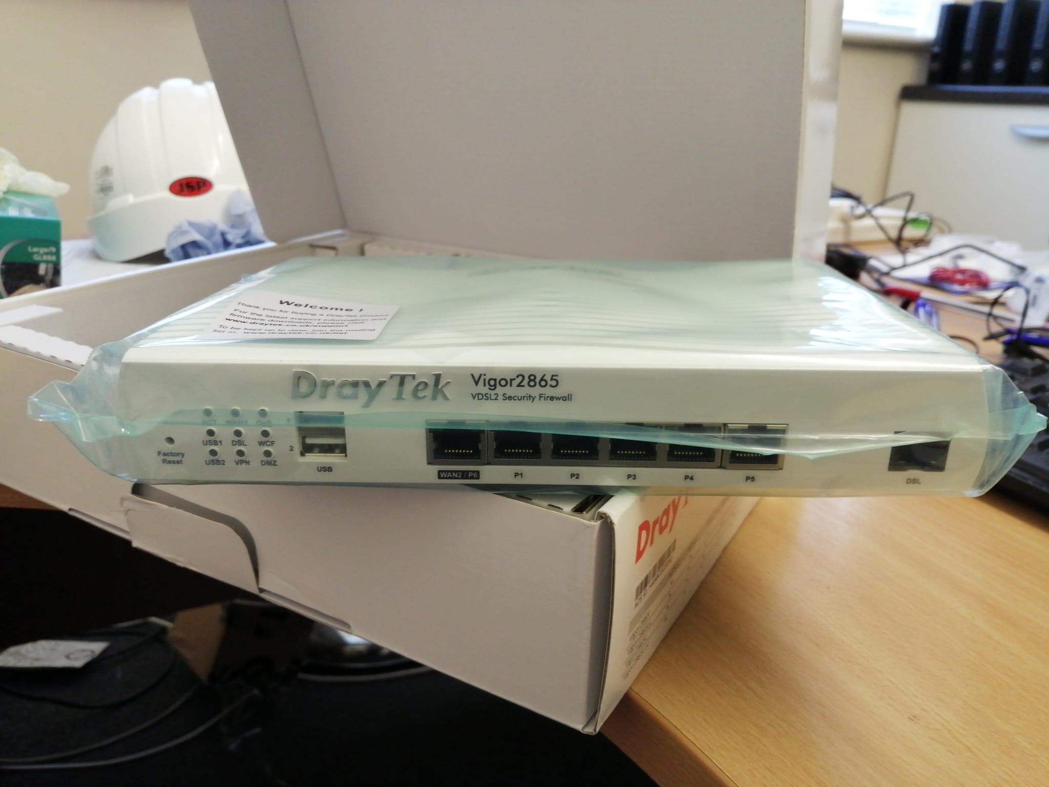

And this just arrived a short while ago (see pic) which I'll be installing at the weekend. Proper VPN access!
Unfortunately enabling Websockets - then rebooting the camera just to be sure - made no difference.
Still exactly the same in both Chrome and Edge (in or out of IE mode).

Just to confirm. Did you enable 'https browsing' as well as 'https' - there's a separate selection for each...

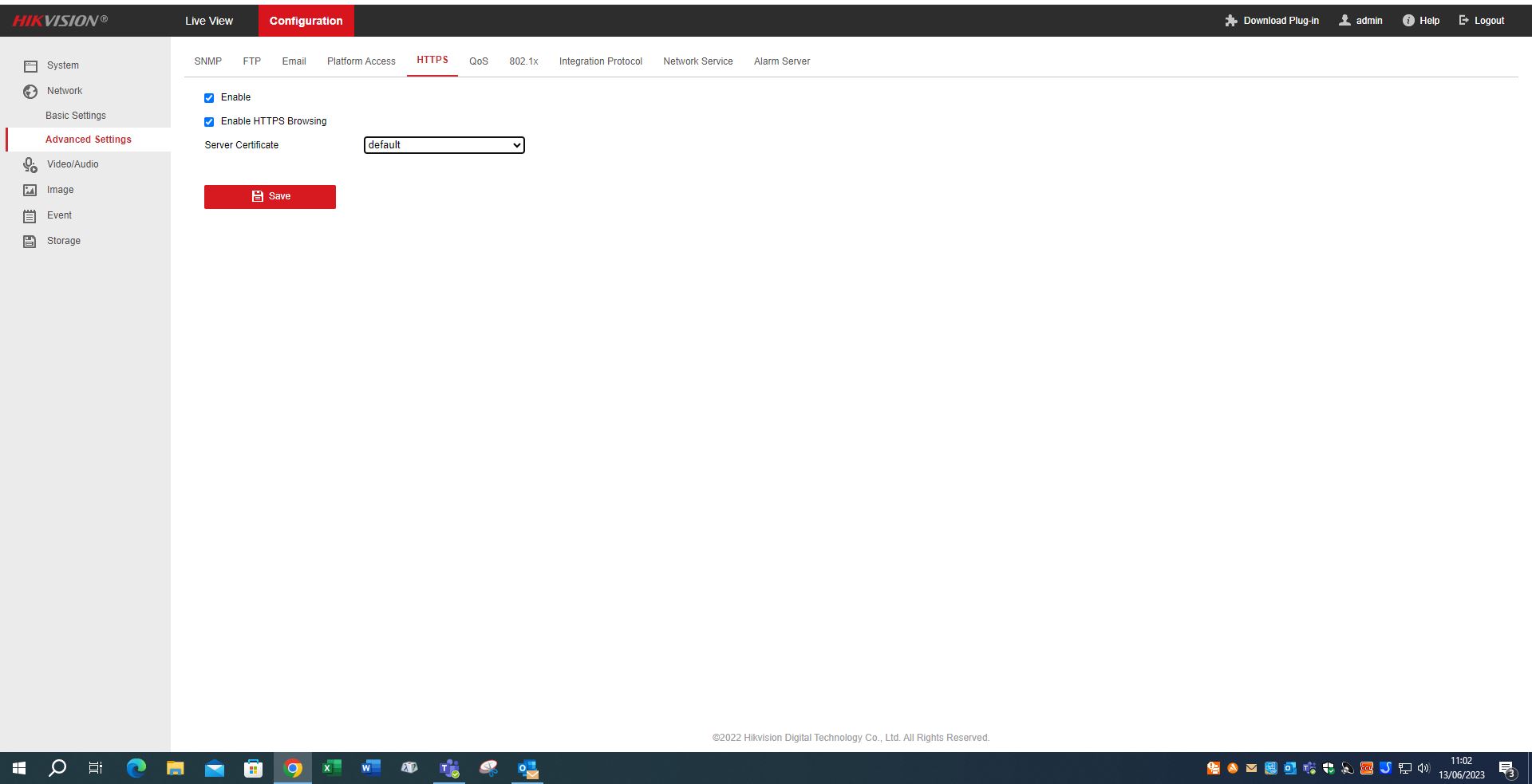

Websockets, I believe, only applies to plugin free browsing. So that would require both the camera firmware and teh specific browser to be compliant.
As I mentioned, the very first thing I do is enable HTTPS:
