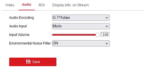

I haven't been able to find an audio code where the 2 way audio is working. Which audio codec do you use for 2-way audio please?
See below the default codec for liveguard cameras where 2-way works fine
