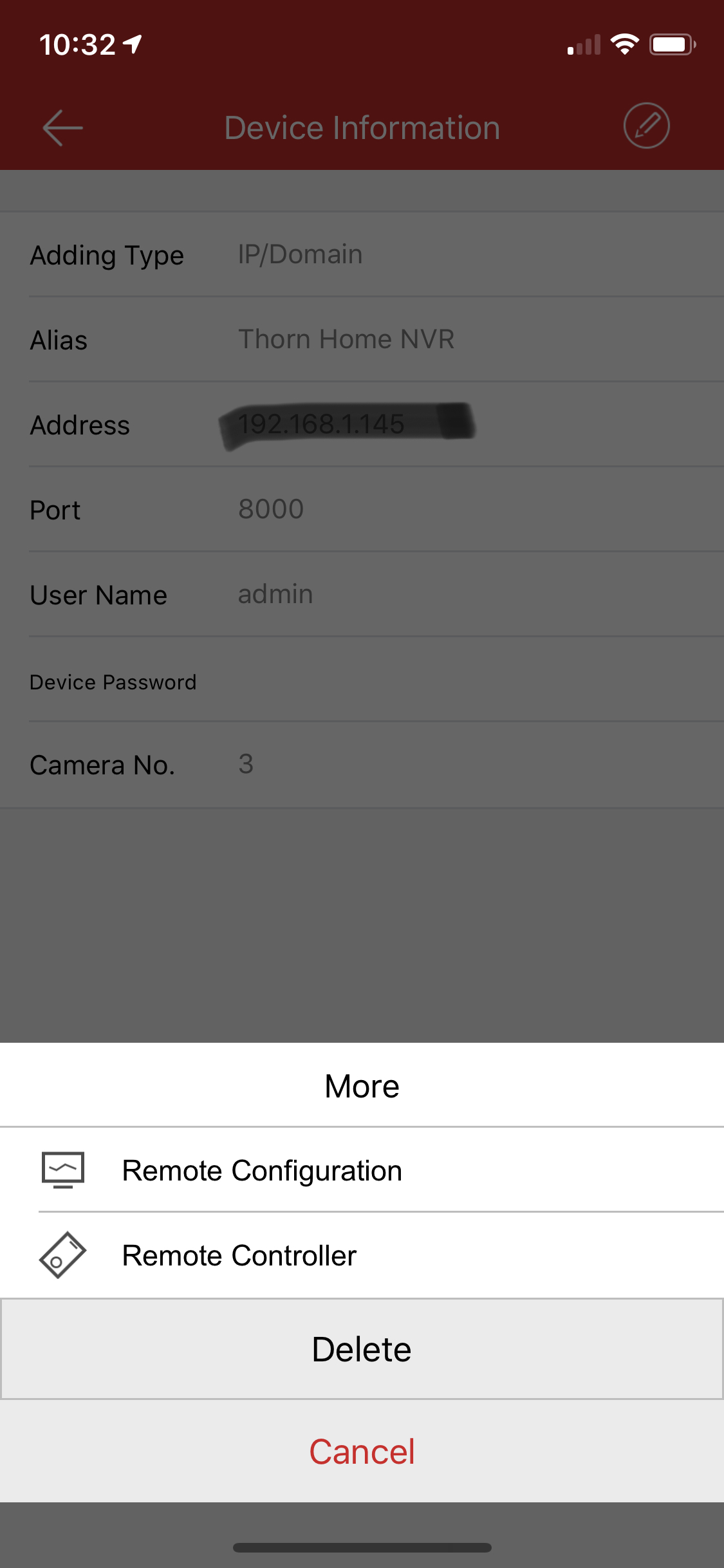

There is, however, yet another push notification toggle that needs to be activated in order for it to work. Press the "Hik Connect" button on the bottom left of the main screen to get to this page, then hit the three dots that are circled:

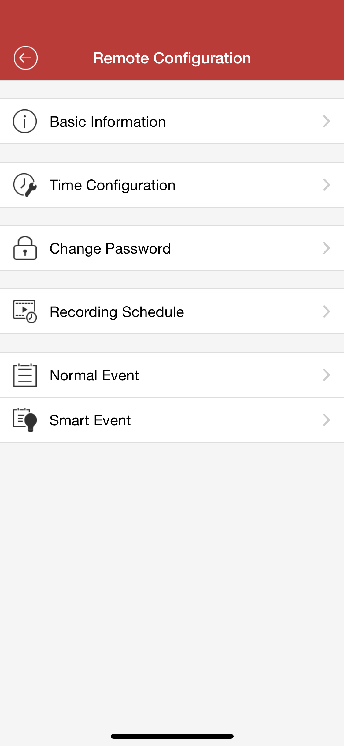

That will take you to this page, in which "alarm notification" is set to "off" on default! Without that toggled on, push notifications will not work. I finally found it and everything is working beautifully! Apologies if this is common knowledge, but I sure didn't notice this after lots of searching.
