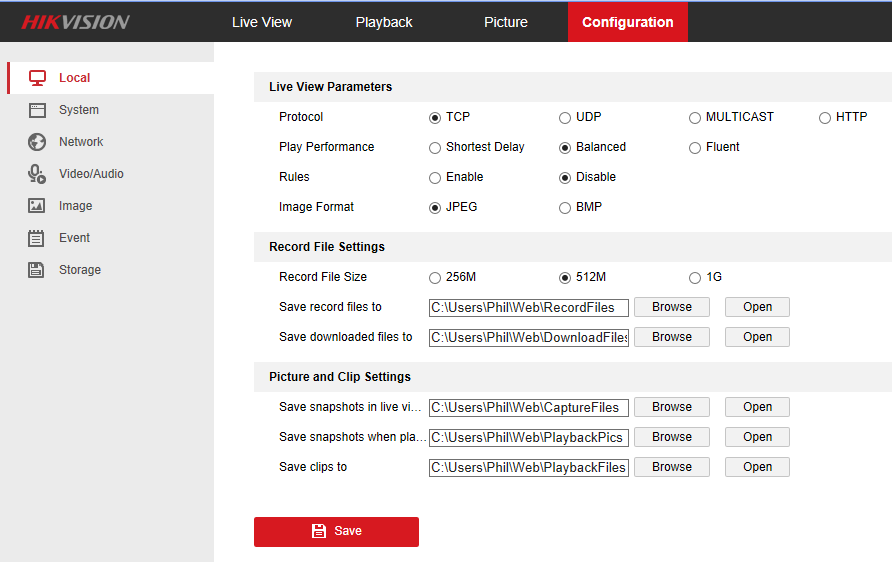

Hi, You can configure the pathname for where they are saved - Picture and Clip Settings as below:
(NB stop playback, use Internet Explorer in 'Run as administrator' mode)

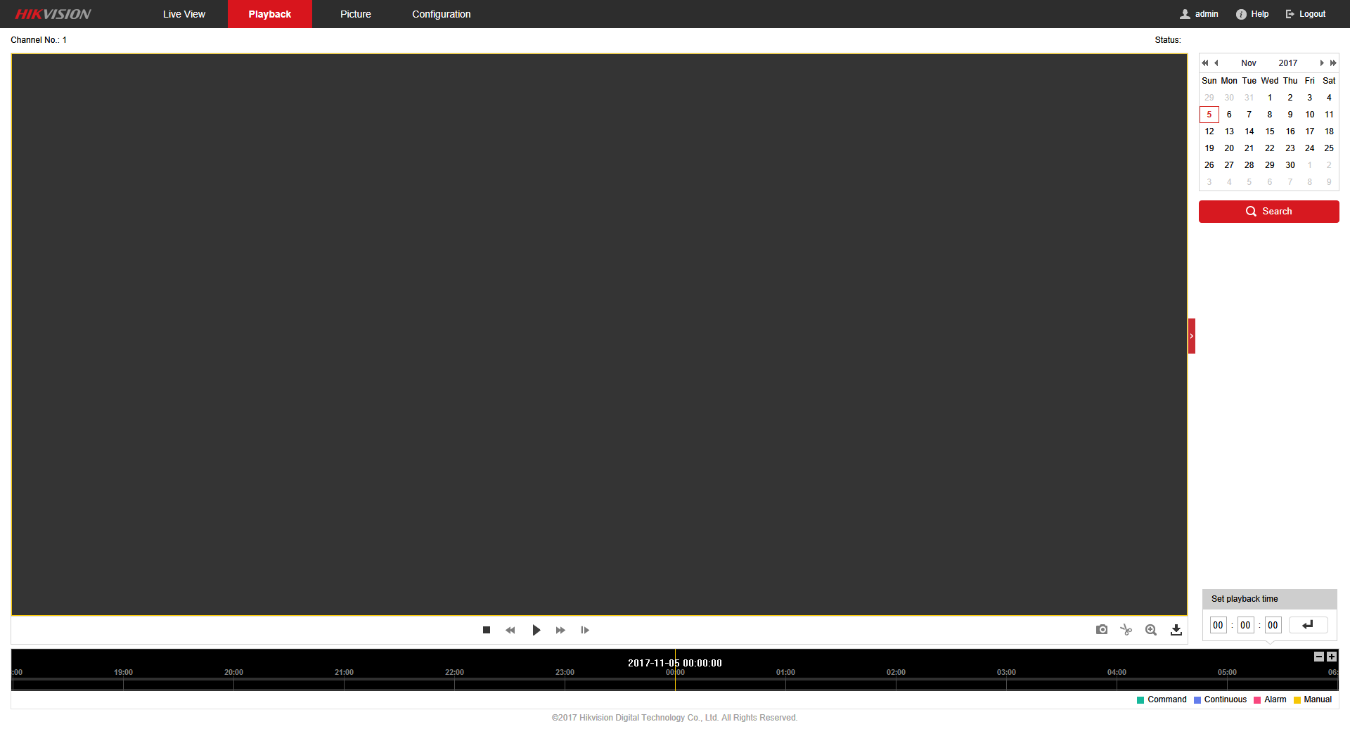

Select Playback from the top menu bar:
