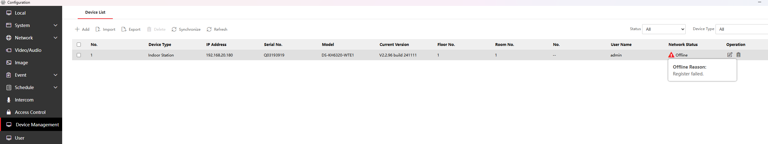

In the door station config via iVMS, it shows "Register failed", but I don't get any more detail about the problem.

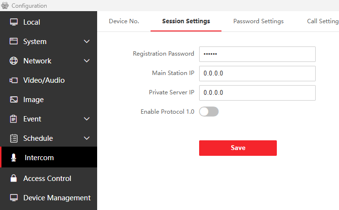

In door station setting, I've done Intercom -> Session Settings -> Registration password as well as doing it via the "Device Management" -> Add:

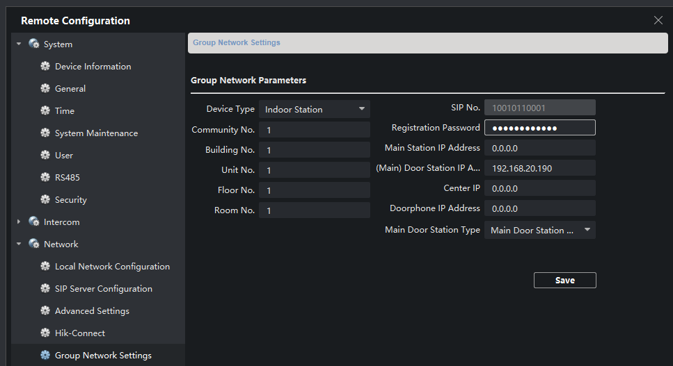

In the indoor station settings, I've set the Network -> Group Network Settings -> Registration password & Door station IP:

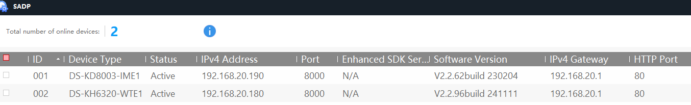

In SADP:

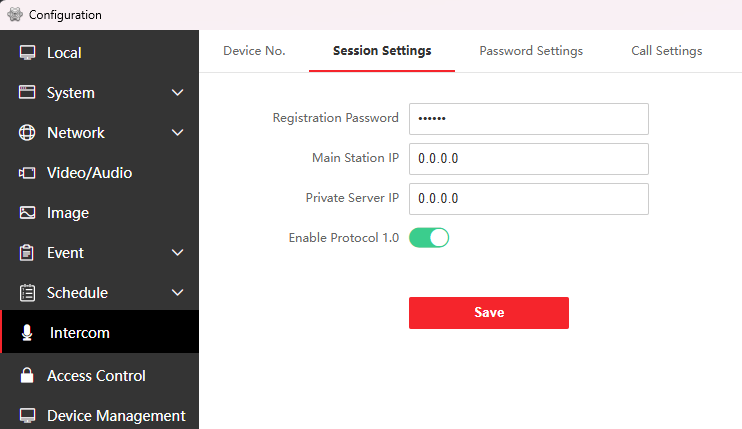

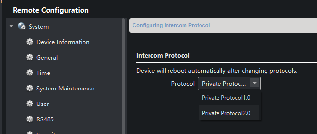

Should it be protocol 1.0 or 2.0 for both?
Door Station
Indoor Station
(I have tried "Enable Protocol 1.0" = On, and Private Protocol 1.0 on both but still no joy in getting them to link)
Are the relevant ports open on the new router? SADP can see the devices but that doesn’t prove connectivity.
David
Yes, they have unrestricted communication between each other, and I can view the live stream fine remotely via HikConnect, it's just the intercom functionality that's not working (and unlock).

Short way is delete indoor from device management inside door station
Change ip address of doorstation inside indoor station settings to something else. Press save then bring back to real IP so it readds itself.
Worked numerous times for me
