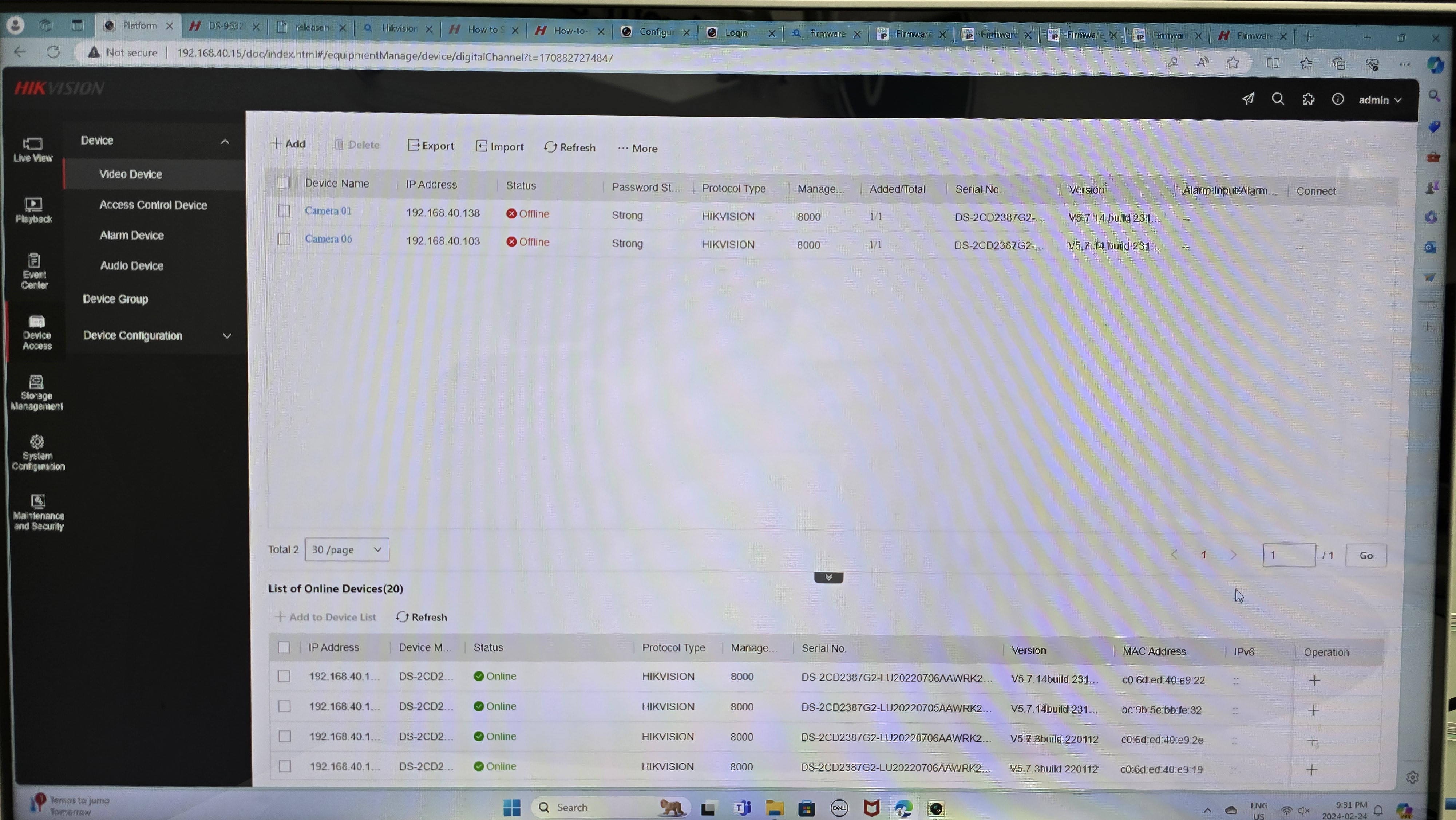

I updated my NVR to the latest Firmware 5 and got this issue with the camera. It shows online, and when I add them, it gives offline.
Help please

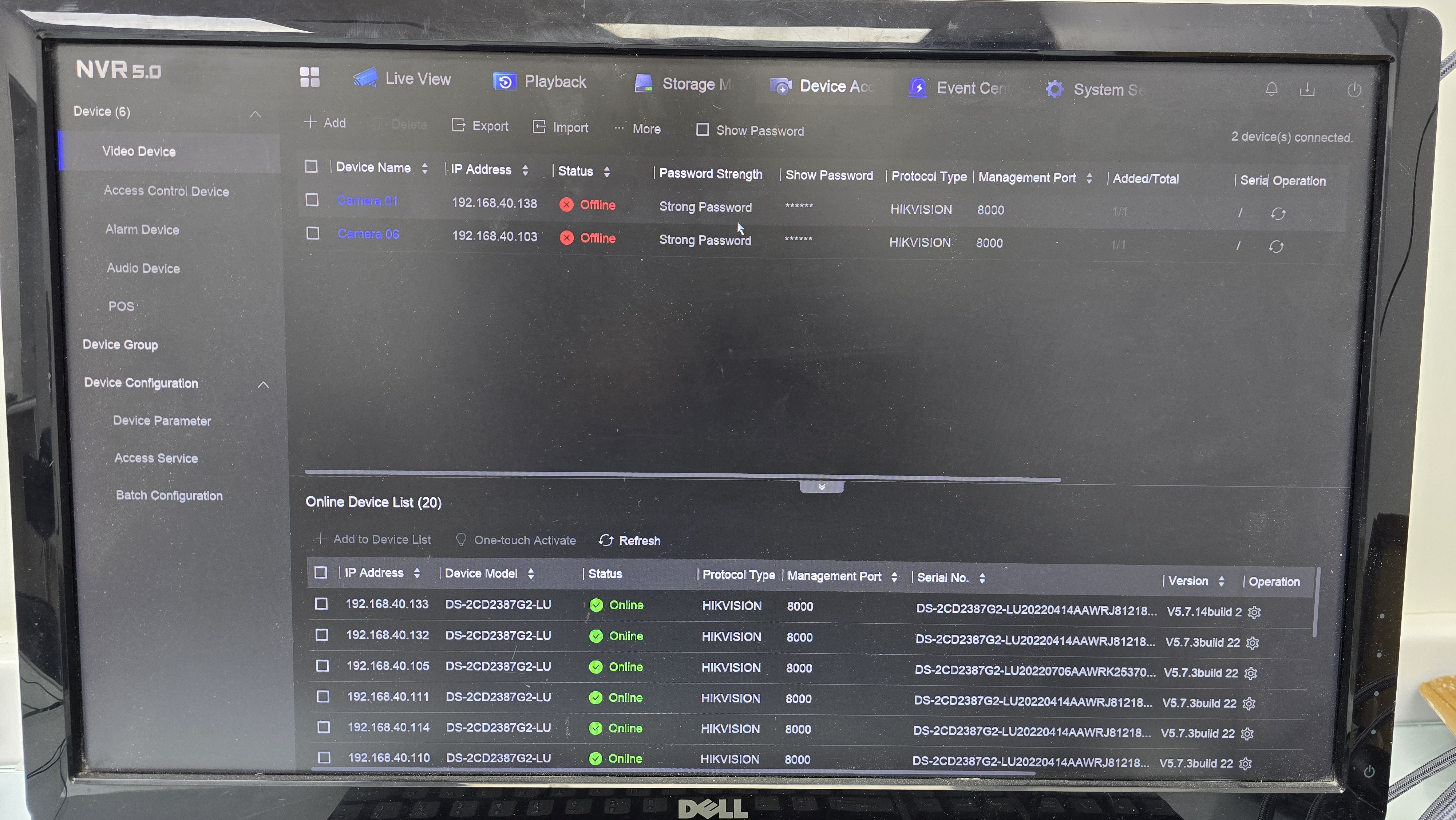

When you hover over/click on the offline status do you get any text/error message explaining why the cameras might be offline?
you haven't mentioned which model NVR... I'm assuming it does not have PoE ports built in?
Your DS-9632NI-M8 is probably a model most don't have... maybe that's why you're having this problem others are not?

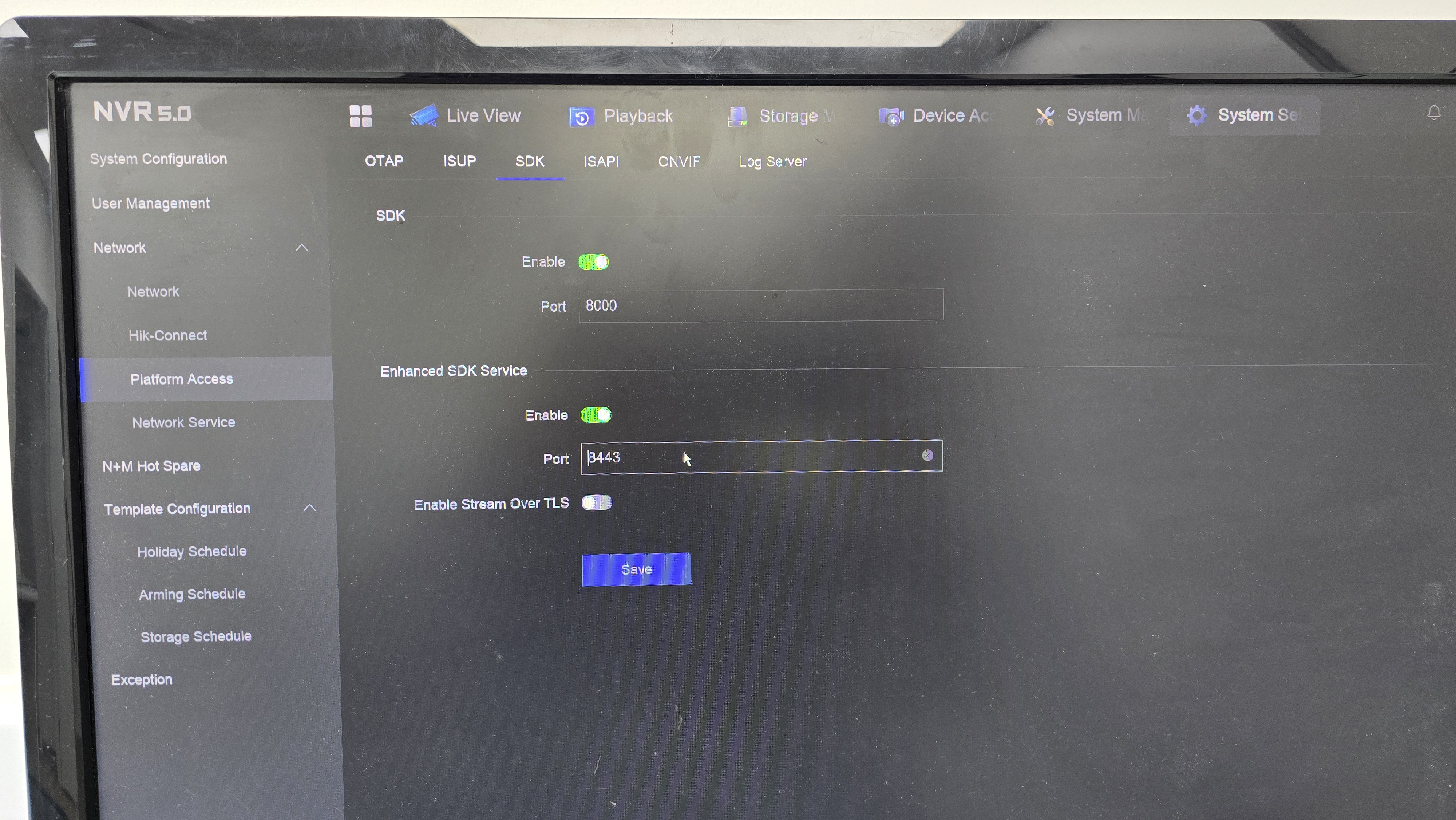

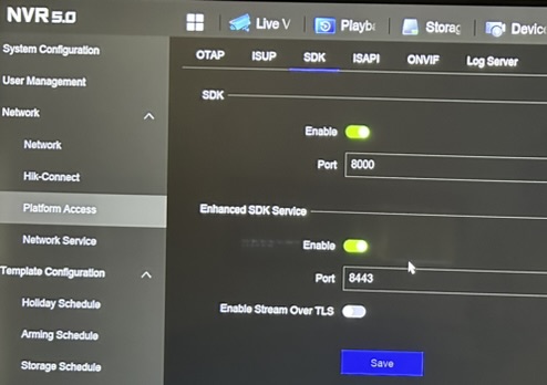

I'm not sure just guessing, but is the SDK service running?

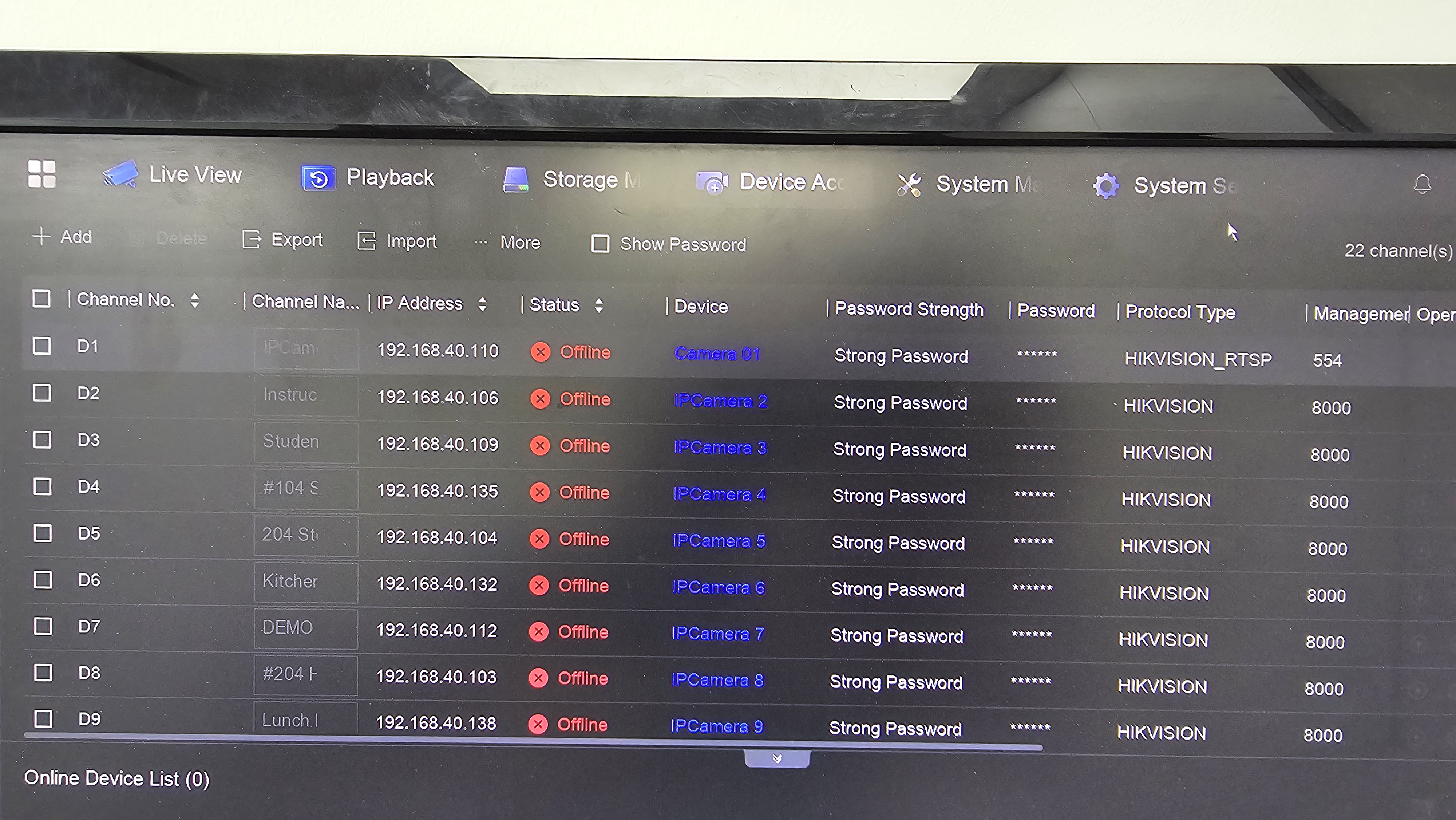

Maybe try adding a camera (at least temporarily) using HIKVISION_RTSP instead of HIKVISION protocol?

Yes, I did; when I deleted it, it showed online. When I added them, it showed offline.
Yes, I did; when I deleted it, it showed online. When I added them, it showed offline.View attachment 10723
