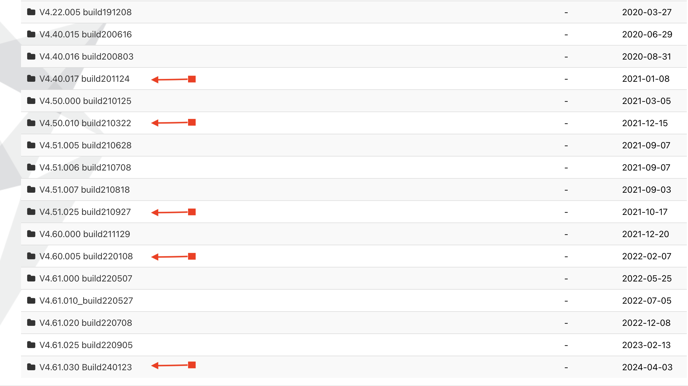

From speaking to sales it seems first step would be to update the firmware. Currently running V4.22.000 build 190821
When I look on here for firmware it just shows two versions (I was expecting many more).
I've heard about needing to upgrade firmware gradually - does that mean just install V4.22.005 and then V4.61.030?
Or is there a better resource with more firmwares available?
You need a full list of previous firmwares for your model. The usual advice is to step through at least one version when the middle number (22 in your case) changes. I've not known an NVR/DVR to be bricked by ignoring that advice but who knows...
You want this page on the portal:
UK Portal
...and you want to upgrade through the versions highlighted:

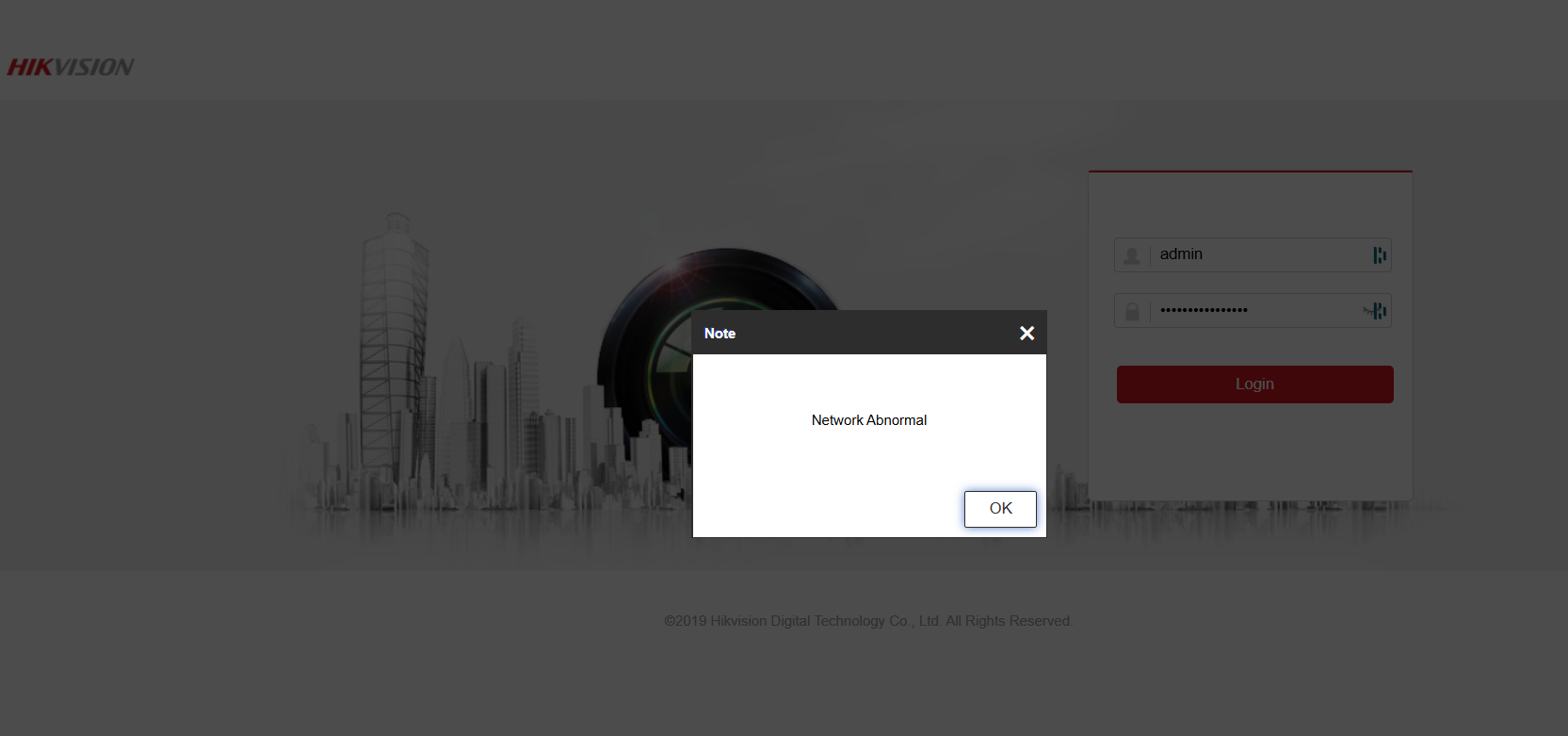

Back to trying to update my NVR firmware - different issue this time but easiest to post it in same thread.
When I try to login to the NVR via browser I get a message saying "Network Abnormal". Pretty sure I have the correct username (admin) and password.
Anyone come across this error before - couldn't find anything on the forum.
Anyone come across this error before - couldn't find anything on the forum. View attachment 12721
Clear your browser history, quit the browser and try again. If that doesn't work try another web browser.
