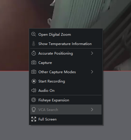

I need motion detection for faster playback tracking. It works on NVR with smart playback by marking motion detections with green bars but it is really buggy, sometimes the player just keep playing the same mark point not playing forward and sometimes I can't set the play cursor to any point in time, it just reverts back to 23:59:59. So now I try to watch on iVMS 4200 but the VCA search is greyed out. What can I do?

I have a similar problem, the VCA search is greyed out

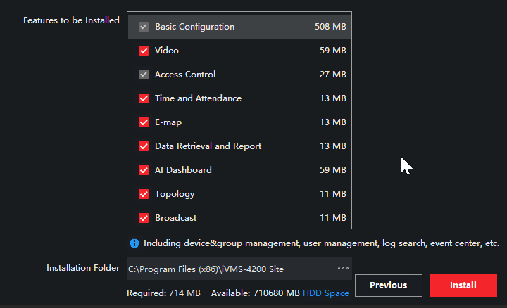

I'd try a fresh install of this version, and make sure that you select all of the below features when you do:
